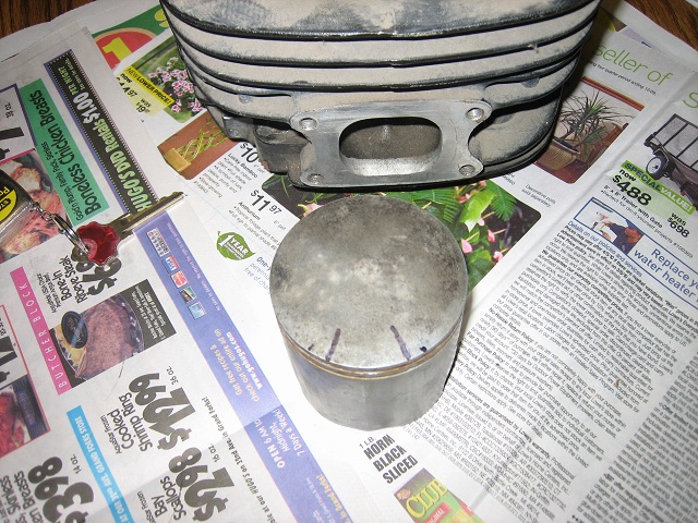

I am 14 and have recently obtained my first motorcycle -- a 1976 Honda MR 250 for $250. The chain fell came off when the previous owner was riding it and of course, cracked a chunk of the case away. So he said that it would run fine until he went into a puddle and then water got on the chain, then into the flywheel/stator area and grounded out the points and it would stop running. He had purchased 2 nice case halves off ebay and just never got around to install them. He also had the cylinder off for some reason, and while it was off I think he let it sit outside so some water got in the crankcase and rusted up the left crank bearing. So, the day I got it I pulled the motor, and started to split the case. I got it split and this is where I am now. I have a few questions.
I measured the cylinder with my dads bore guage and it is about 0.007" to 0.010" bigger than the stock bore (70mm or 2.756") throughout the whole cylinder. I think the PO was honing it or something. The piston is also a little smaller that 2.756", I think it's around 2.752ish. This makes about .013" to .015" piston clearance. I think that is waaayyy to much, correct? What is it supposed to be?
We bought a gasket set off ebay, should be here in a few days. Babbitsonline.com lists both crank seals, so we will probably order those, but does anyone know anywhere else to get them?. I have found a few pistons on ebay (we are probably looking for the first oversize which I think is .020 or .025" correct?) and here is the big question.

BUT on babbitsonline.com it says that the MT250 and MR250 pistons are different part numbers. I have found a .025 oversize piston on ebay that has the MT 250 part number. Will it fit the MR?

You may be able to tell the bore size from stamped markings on the top ring faces, near the gap. If you find just an 'N', it's probably standard bore, and it you see a number in addition to the 'N', it's oversize. The Honda MT250 service manual shows a standard-bore service limit of 70.1mm (2.760"), so yours is either a well-worn standard bore or a fairly fresh first (.25mm) oversize (does the piston look good, ar really beat?). The manual also indicates a .05mm (.002") minimum piston/cylinder clearance, if you have the cylinder bored.
I would definitely get the OEM crank seals. These are special high-speed rotary seals designed to work with minimal lubrication.
I recently went through the whole MT/MR/CR/FL piston thing trying to find a piston for my friend's MT250. Depending on year, some of these bikes' cylinders have boost ports (small port directly opposite the exhaust port), and some do not. A piston designed for a boost-port cylinder will work in a non-boost-ported one, but the reverse probably is not true for OEM pistons. This is at least one reason why the MT250 piston has a different P/N. I couldn't even hazard a guess on the eBay piston without measurements from it and the MR cylinder, and even then it might be risky. I think you'd be good with a '75-'77 CR250M piston, but maybe someone here with more 250 experience could help with that.

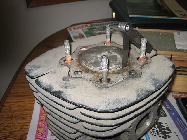

Anyway now time for the stupid part :? . When I measured the cylinder before I had the micrometer set wrong, I had it set to 2.751 instead of 2.756. So I measured it again and now it is only .003 to .006" wore depending on where I measure it. I think that will be OK for standard bore even if it is out of spec a little. So now my questions are:
I need a set of standard rings for this thing. I found a Wiseco set on ebay. Is that only for Wiseco pistons or will it fit my honda piston too?

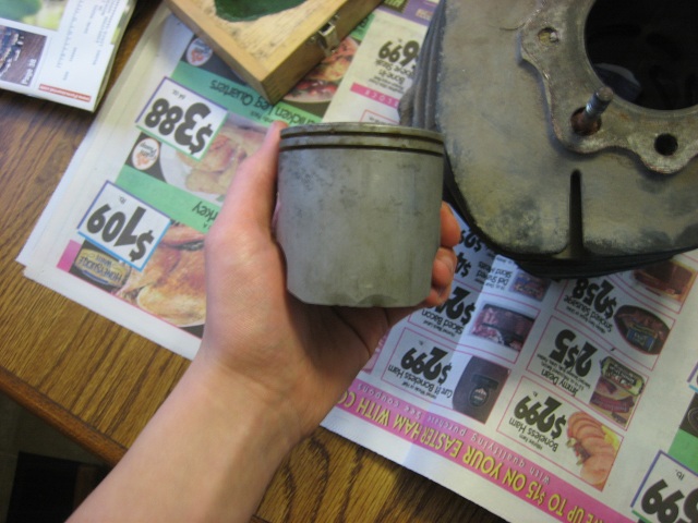

I also measured the piston again with the micrometer and it measured 2.744" at the bottom of the skirt. But then I checked the clearance with a feeler guage(attached pic) and and the 0.006" guage fit snug. I think that is good enough??

OK, wiseco rings will not fit oem pistons. Pistons for the '75 and '76 MR, CR and MTs are the same. The '73-'74 pistons are different. The ring pins are placed differently because of extra ports on the '75-'76 MR and CRs. Do not use ebay pistons unless they are clearly for '75-'76 bikes. I've done this and ended up having to get the correct '75-'76 piston.
Seals are available from any honda dealer. Mine had them in stock. you might have to wait a couple of days if you order them. If you have the engine apart, don't skimp on main bearings. Go to any bearing supply company and spend the $45-$65 for new ones. I've also tried to skimp in the past and paid for it later. I prefer wiseco pistons because they are forged and not cast like the oem ART pistons. Do not reuse this piston. cast pistons shatter when they exceed their life limit and tear up your engine. Yours is halfway there already. I'd bore out your cylinder and go to at least a .020 over. Local guy charges $40 around here to bore and prepare a cylinder. Wiseco will be in .020 oversize increments (.5mm) I had my head off the other day and I snapped a photo. This is a .040 over wiseco piston (71mm bore now). Here is a link to the photo (scroll down--it was easier to just post this link than to resize the photo and post it here):

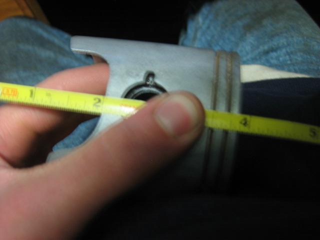

Attached are some pics and measurements of my piston and cylinder for reference.
File comment: distance between outside marks (inside edges of boost ports) is 1 5/8" and distance between inside marks (ring locating pins) is 1 1/8"
File comment: inner marks are the ring pins and the outer marks are the inside edges of the boost ports
File comment: here are the ring locating pins in relation to the boost ports.
File comment: measurement from the 2" to almost the 4" is 1 13/16"

It looks good to me. I would just soak the cylinder and piston in marvel mystery oil for 20min., wipe it down, run a ball hone through the bore, put on fresh and gapped rings and run it. I have fabbed up rings out of HO scale model train track rails before while I was waiting on oem parts. Make sure you de-carbon the ports before assembly and set your jetting before the first start. I like to heat cycle 3 times of five minutes each, making sure to let the motor cool down completely between cycles. Then ride it below half throttle for 20 minutes and you're set.

PostPosted: Sat Apr 03, 2010 5:51 am
Ryan,
OK, here goes:
Ring retaining pins: 1.26"/32mm apart (as measured on flexible ruler)
Skirt cutout height: 1.983"/50mm (not super critical)
Skirt height (max): 2.735"/69.5mm
Pin centerline to piston top edge: 1.27"/32.2mm
The retaining pins appear to be slightly farther apart than on the MR piston, possibly to clear the wider (?) CR boost port and allow this piston to be used on the CR/MR/MT/FL motors. I would suggest taking a measurement around the bore between the inner edges of the rear transfer ports, on each side of the boost port; if it's 36mm/1.42" or greater, you should be fine.
The wrist pins and small-end bearings have the same P/N's. so that's good.
The ART piston has a really cool machined surface (different from the OEM ART's I've seen) and should retain oil well even after a lot of use. It looks like a quality part, especially for the price.
