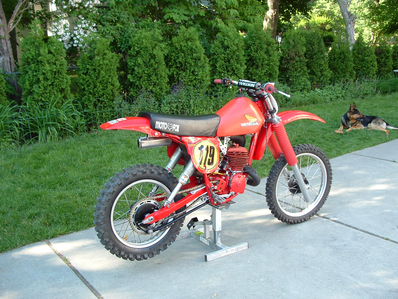

Here's my new steed I've just restored,79 CR250 also fitted with a nylon front roller as I described earlier,and I would recommend sticking with a M8 Allen headed bolt as I know it works a treat.
