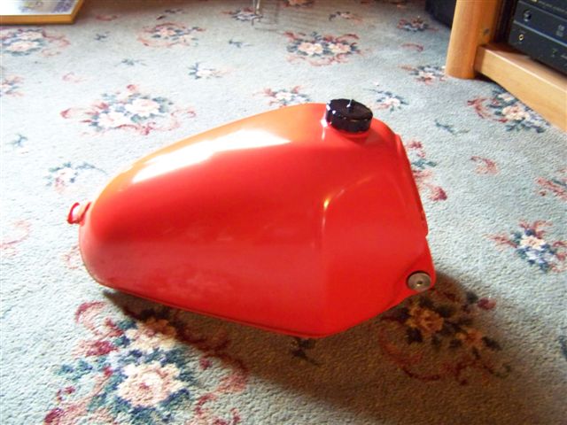

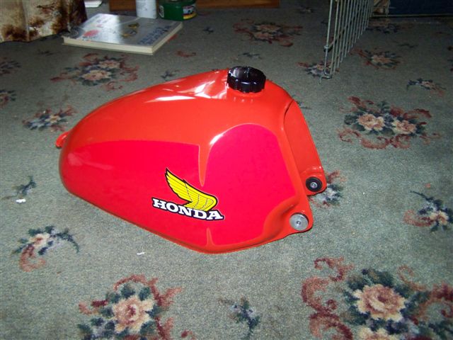

Here are some pics of tank 30 hours of prep tank had quite a few dents ( probably would be more if I rode this for the last 31 years :lol: ) filled, sanded, self etching primer, paint from vmx tahatian red came out pretty good for a rattle can job, then graphics to help protect from knee rubs etc. started the wheels last night hubs will get powder coat black new Excel rims I hope to use the old spokes
File comment: graphics looks pink in pic
File comment: before graphics

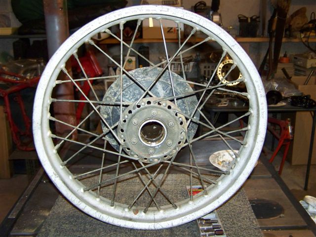

finished rear wheel tonight powder coated hub ( just got powder coat system) , spokes wire wheeled,buffed,zinc plated then polished. I broke 1 spoke with torque wrench. attached are b-4 and after pics

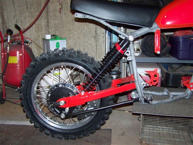

more pics before of bike as I got it and pic of rear of bike waiting on bigger oven to PC frame IMS pegs, John Astelford chain guide NOS chain tensioner previous pics of rear wheel I redid they were done with gloss PC I redid them with satin and new stainless spokes from Buchannans, bike had Progressive shocks I replaced with the same
