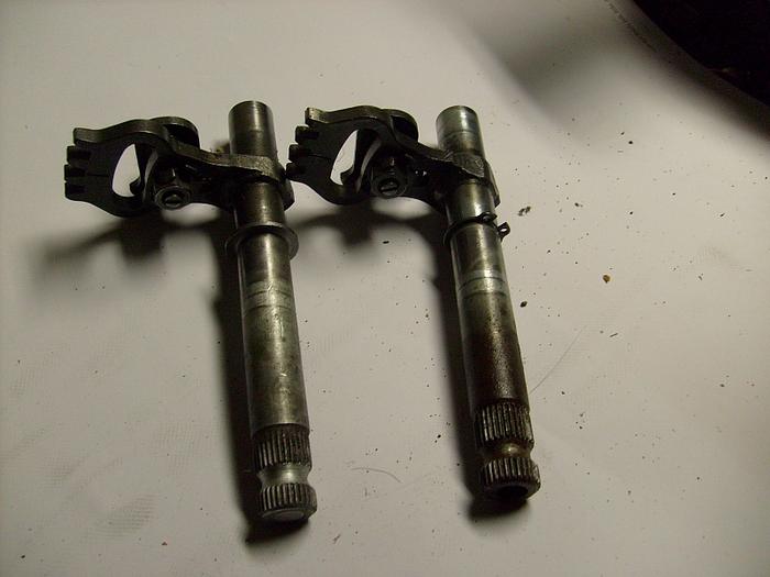

I am replacing the shift shaft in my 80 cr250, the splines are in pretty bad shape. WIll a shaft from a 78-79 bike fit as well?

I thought I could help because as far as I was aware they are the same item's, however just checking the part number the 79 came at as 24610430000 and the 80 as 24610467000.
On that basis they may not be interchangable though I can't see what the difference is.

78 & 79 interchange not the 1980 honda-dealer.com has an excellent cross reference if you know the part #s click oem then enter info on right side box,all bikes that the part # you enter will come up must enter with dashes (24610-467-000) Craig

they are interchangeable.
the right one has a circlip and a washer(not shown)
the left only a washer pressed on the spindle.
the parts catalog doesn´t show this difference. :?
many parts of the bottom end have such minor changes but can be used in all three years.
the partnumbers are no help in this cases.
