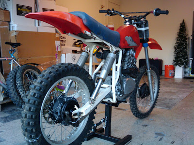

I bought a 1982 CR480R front end to fit on a XR500 C&J.
The inner bushes and guides got damaged during dismantling (and somebody else had been inside there before). I bought the parts and it turned out that the 43mm fork is actually a 1983.

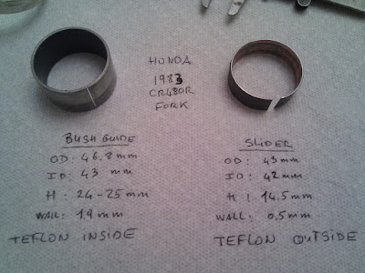

This is still ok for my project, but I am struggling to find the bush guides.
- Bush guide 51414-KA4-711 or no.9 on the diagram. They are 24mm high and coated inside with teflon or something similar.
Anybody would know where to get these?
At worst, these bush guides look very similar to those on a 1984 CR250. Would anybody know for sure?

Here is a picture of the project as of today (not with the 43mm fork)

Here is a picture of what I am looking for:
and finally a picture of the bike while it is being rebuilt, one part at a time.

Westernhills took my money and say they have the parts!! Cant wait to see them in the flesh and be certain.
MX-Tech also told me they have them.
Also found one guy in Holland who has the bushes.
Amazing what the internet and the advice of a few folks can do...
Will keep you updated.

are these the bushings you are looking for?
http://www.alibaba.com/showroom/kyb-forks.html
about halfway down the page.
Let me know if they work?
Tom

Hi Tom, those on the Alibaba page look about right. They are also much cheaper than the OEM ones... If I had seen your post earlier... :)
