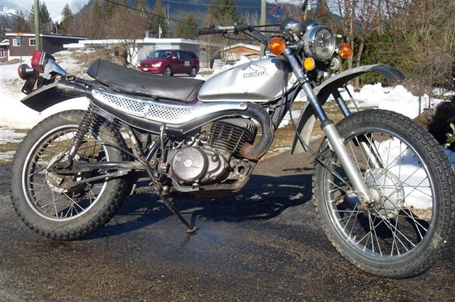

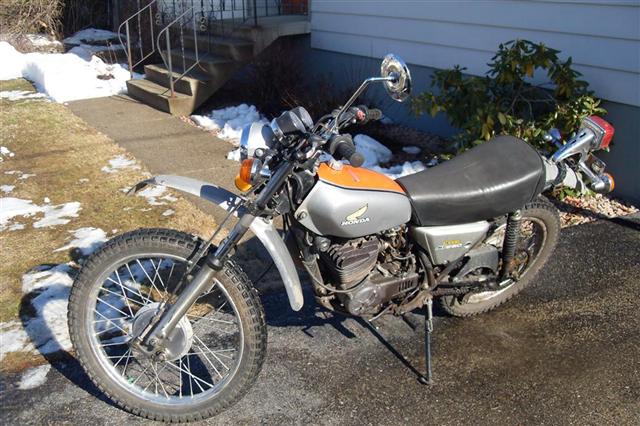

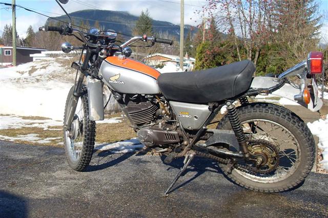

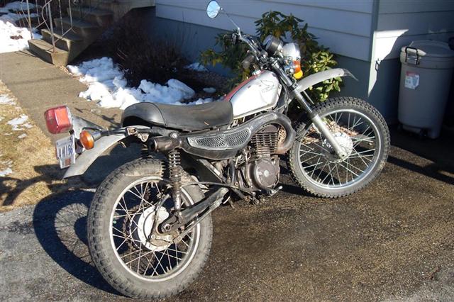

Hi I think this will be my first post of many, Last spring I bought a 74 MT250 and I am in the process of restoring it. My tank is coming back from the body shop in a couple of weeks and I have had no luck finding the paint codes for this year, Can anyone help me with this? I need the code for orange and silver for the tank, also I believe the silver is a little different on the fenders and oil cover, the oil cover is in great shape so I will not be painting it, and I should be able to color match this. I hope?
Any help would be appreciated
