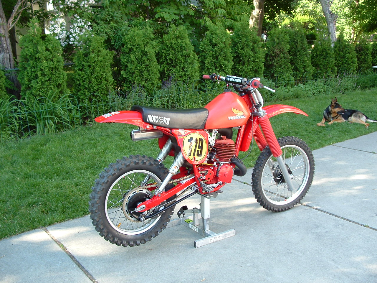

Also, I don't use any exotic fuel blends - just 93 octane Sunoco Premium. I also have two Maicos (76 and 81). They run on the same fuel and oil mix.
I have never owned a Honda before and after a season of racing, I am very impressed with how it works for me.
File comment: This is the completed Honda with the watch dog.
