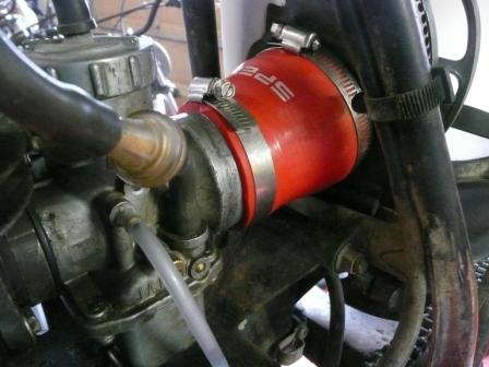

File comment: Aftermarket autoparts intake boot (Specter 2.5-3in) fits 36mm Mikuni to '74 CR125 airbox

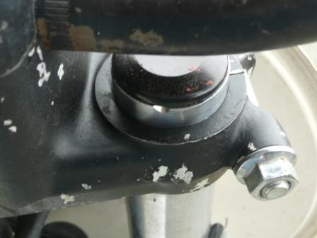

File comment: Stock forks bend. Make an index mark at the top and rotate them 180 degrees periodically to prolong life. Must rotate them exactly 180 together or they will stick or jam.

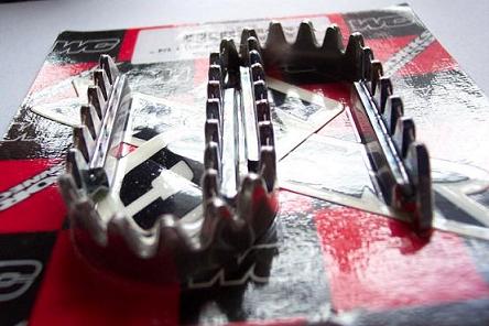

My CR frame's footpegs & mounts were pretty tweaked from years of hard landings, so I tried Works Connection's footpeg wideners:
I positioned them on the old pegs at right angles to the frame and tilted upwards very slightly at the ends, then had them welded on. It came out pretty well; just like when the pegs were new & unbent, except wider and with better grip.
