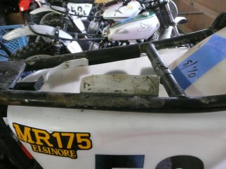

File comment: Duct tape sidepanels to frame at top, Seat will hold them on and they won't fly off during a race.
File comment: Make oval plastic shim from Clorox or detergent bottle and punch holes to mount it inside sidepanel with rubber strap. Keeps frame tabs from wearing sidepanel

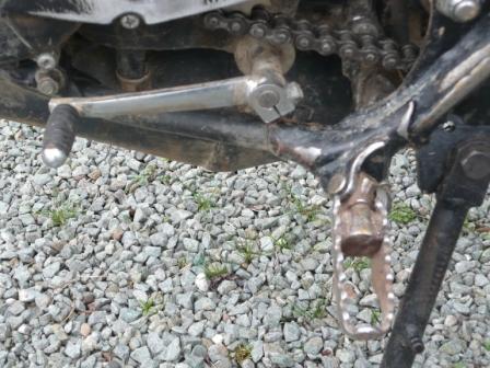

File comment: MR175 shifter will bend in a fall and not damage tranny like solid CR125 one. MR175 footpegs are wider and direct swap

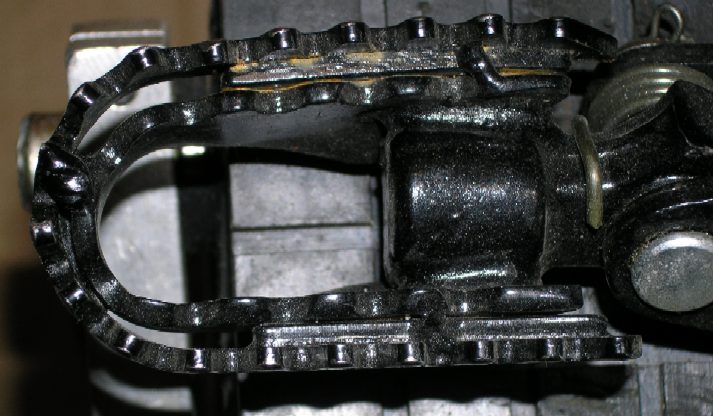

My CR frame's footpegs & mounts were pretty tweaked from years of hard landings, so I tried Works Connection's footpeg wideners:
I positioned them on the old pegs at right angles to the frame and tilted upwards very slightly at the ends, then had them welded on. It came out pretty well; just like when the pegs were new & unbent, except wider and with better grip.
