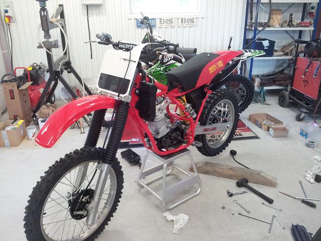

Here is a pic of the rocket taking shape :D
