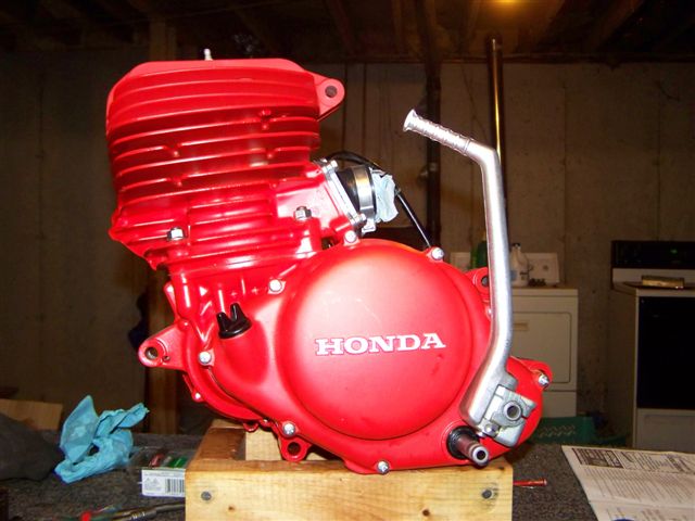

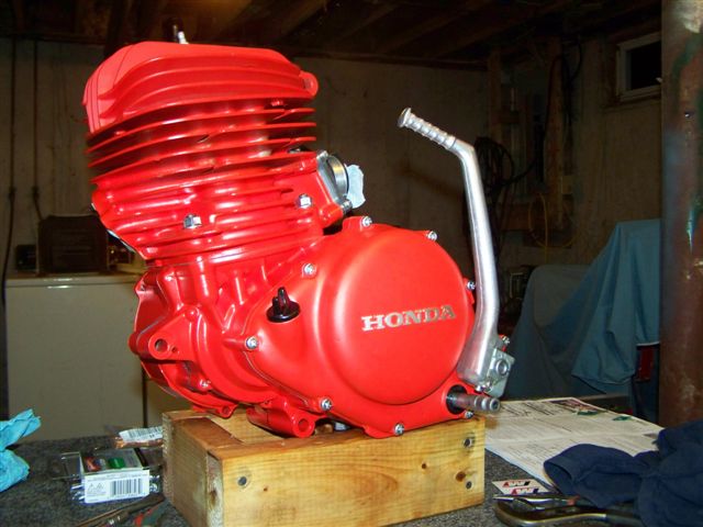

:D finally completed motor had problems with clutch cover as there was damage that had to be repaired I tried Lab metal this did not feather edge well at all ended using usc all metal filler (Napa)motor is powder coated so I needed filler with metal less than 3 weeks till 1st race still much to be done! still in search for the rubber piece that holds the rear of the gas tank to frame any help willl be appreciated thanks, Craig

PostPosted: Wed Mar 16, 2011 11:15 am
What recipe did you use for the powder coat?
PostPosted: Wed Mar 16, 2011 8:37 pm
I got the powder from dogger (thanks Don) motor was gloss then pc'ed satin clear to get the matt finish the HONDA lettering was taped before color was applied then removed b-4 clear was applied so there is a coat of clear over the lettering also
