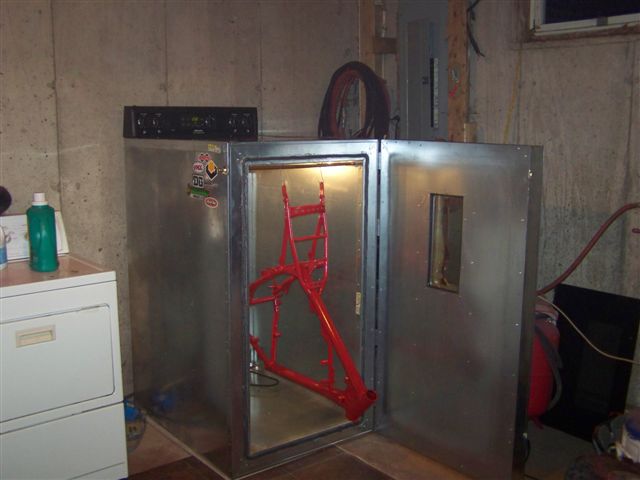

here are some more pics of 79 cr250 resto and pics of powder coat oven I built to get frame into. frame, springs, seat brackets,swingarm, hubs, brake pedal, triple clamps not in pics, foot pegs ( IMS ) all are powder coated.gas tank done with rattle can bacuse of filler also posted b-4 pic
