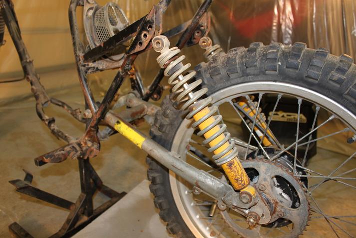

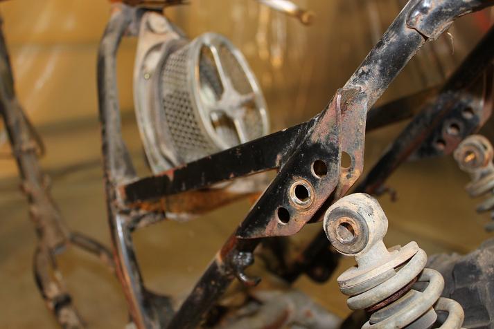

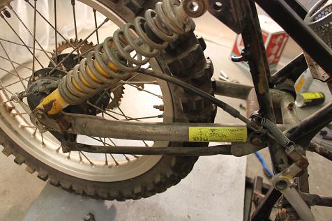

i need help identifying the rear suspension mods. on the '74 cr125m i'm restoring. the dg swingarm could be extended but i don't have any information on it. i am inclined to remove the forward upper mounts as they prevent the side panels from being used without cutting them. my two questions are; if the swing arm is longer, how will it effect handling with the stock upper mounts. Also..with the forward mounts removed the bike is closer to original and valued more right? anyone seen this kit?

The trouble with the modified travel versions is that they aren't legal for AHRMA competition, so they are relegated to just sitting around and looking pretty. The handeling of the bike would suffer only slightly slower steering and enjoy better high-speed stability with an extended arm. Extended arms were used by some people with the standard travel configuration. This is just a matter of preference, as I haven't heard from my ridding buddy who has one on any headshake or other issues with the regular arm. Full on DG equipped bikes do command a premium, but the optimal bike values will either be seen with pristine OEM reproductions or the full DG bikes. Normal bikes with laydown shocks are too in between to be show pieces, and aren't legal to be raced, so they aren't as desirable.
I am building a full DG racer right now and could use that super early rear-mount-only DG arm you have. I also have a stock swingarm that I won't be using if you want to go the oem route. I also have an original unmodified frame that I don't need either. That frame does have some rust issues, so let me know if there are specific frame sections you need and I'll let you know if they are rusty or not. In the end, if you do keep the DG arm on an otherwise stock bike, it will work just fine. Let me know if you do decide to sell the DG arm. If you'd want to trade for a Redline arm, or a later model DG arm with both front mounts and rear mounts, I should be able to do that too. The older DG would match the other early 74 parts I have on mine more accurately.
