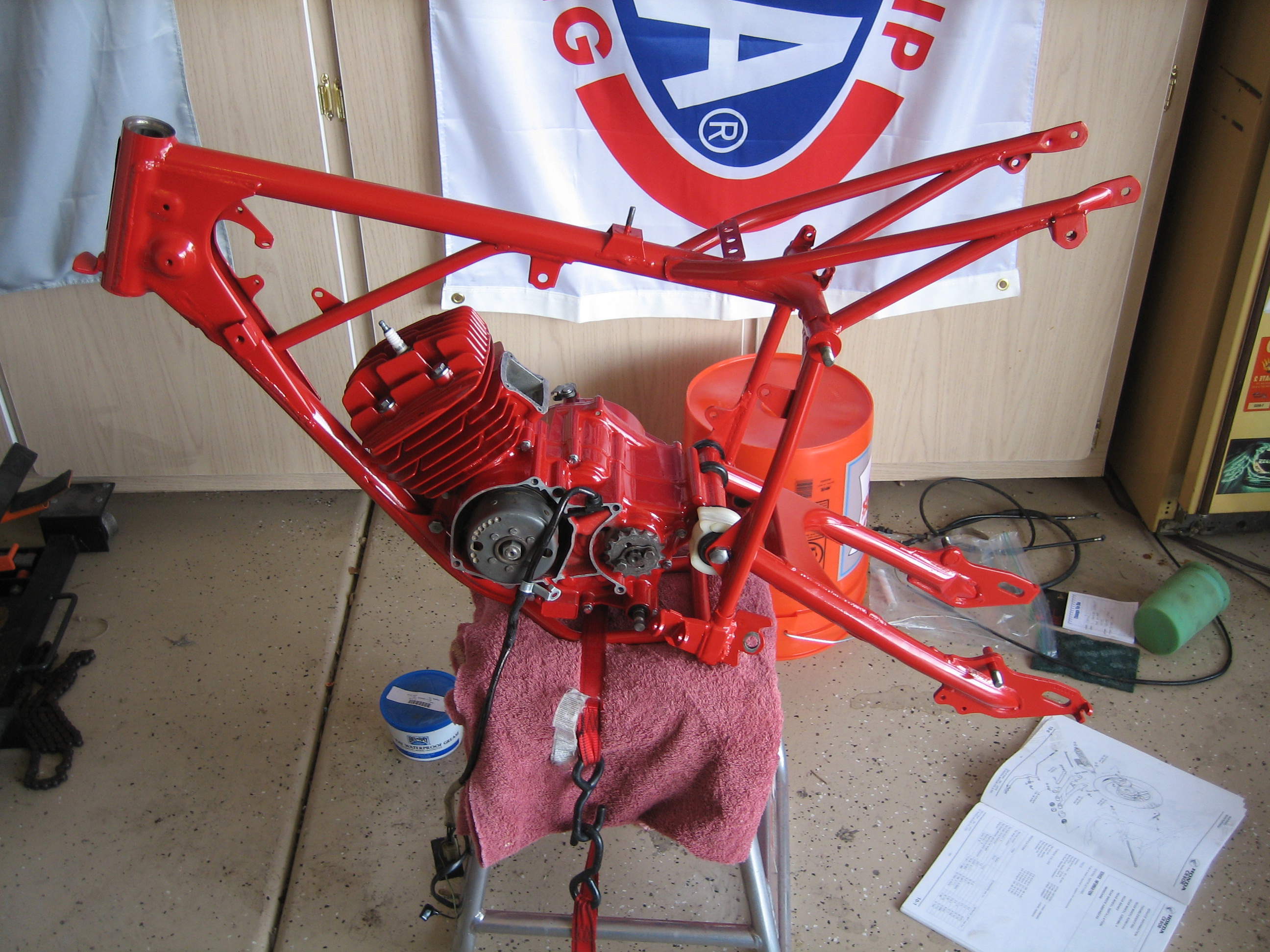

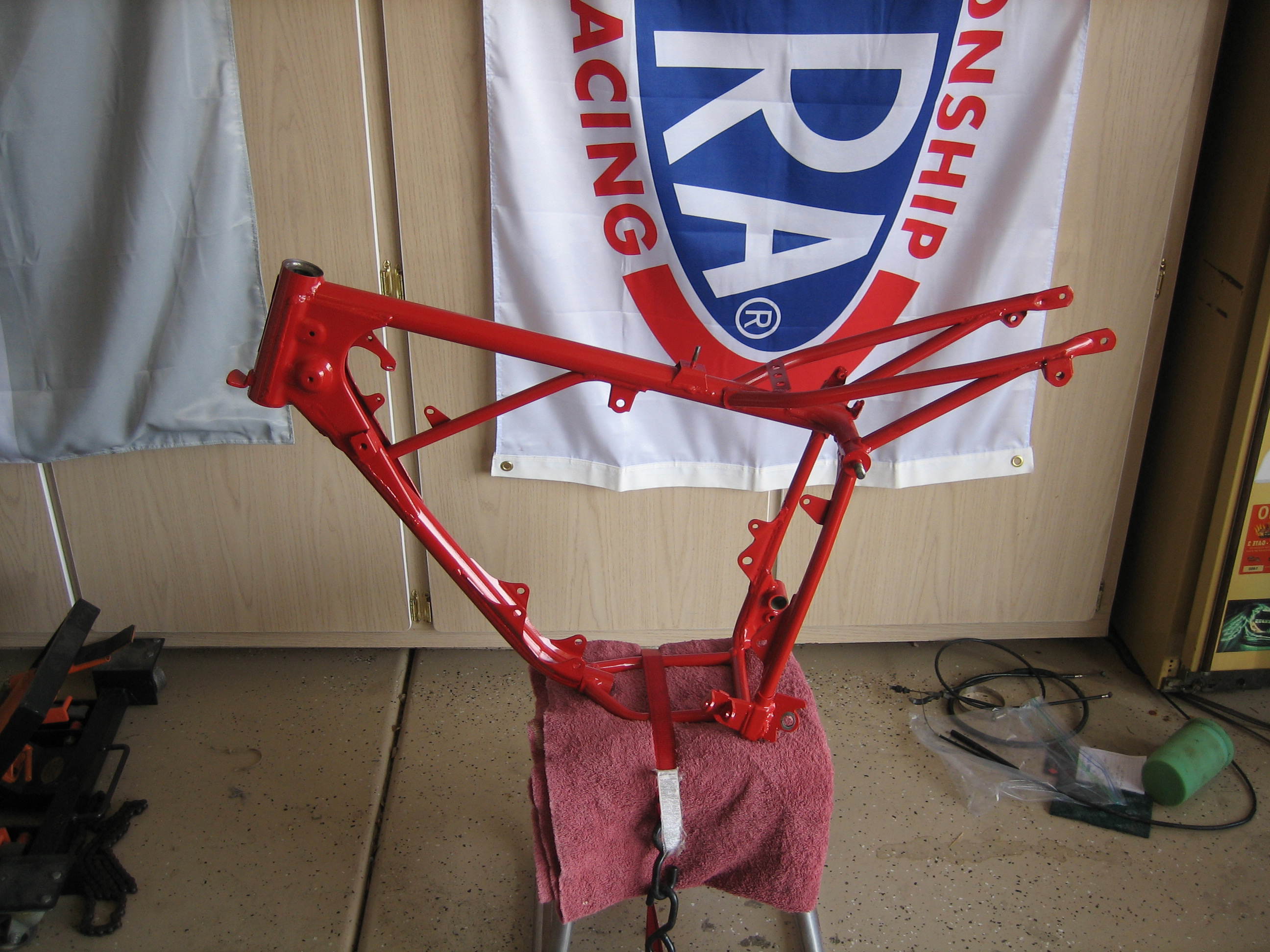

Here's the first picture of the frame. Amazing how close the thing is to a bicycle in size and weight. It took a decent amount of time in the parts washer to get the years of grease of of it. We sanded and painted it. Considered powdercoat, but opted to keep this more of a true "garage" project.
I saw on a message board somewhere that one of the high temperature spray paints out there was a close match to Tahitian red. We sprayed out a little bit on an extra tank that came with the bike and decided it was actually very close. The color is Ford engine red. We decided to proceed with that as it was readily available at our local paint store.

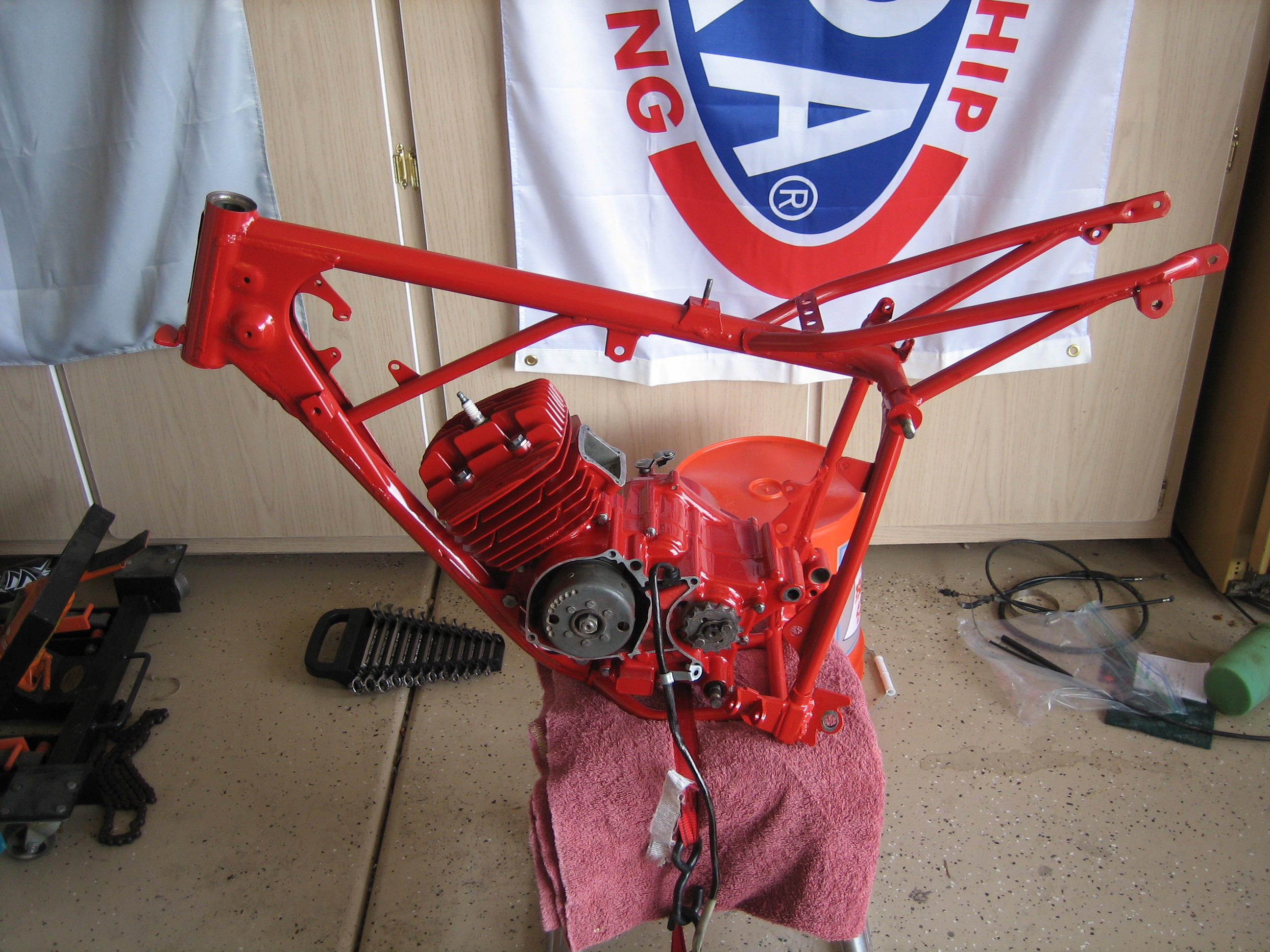

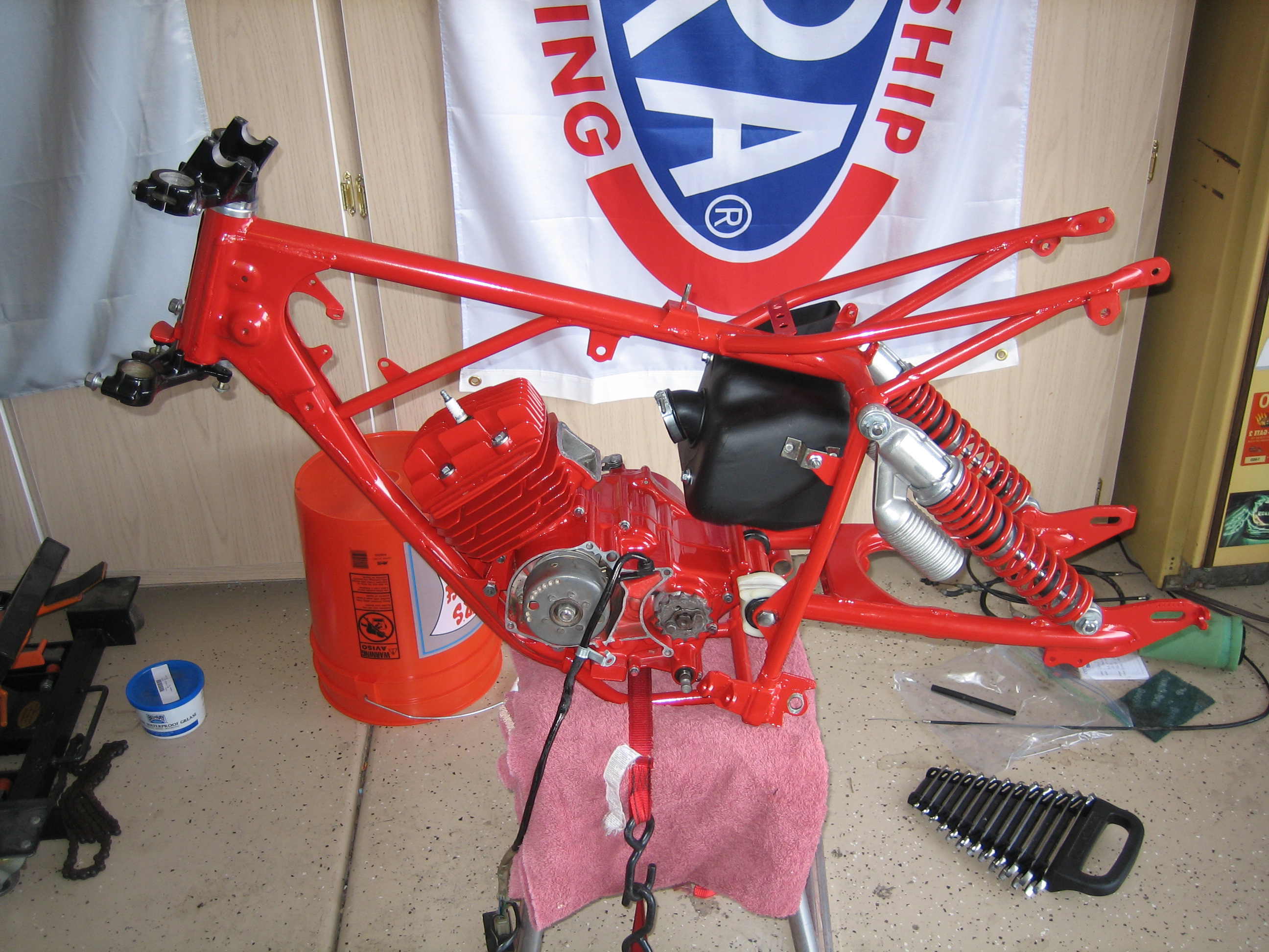

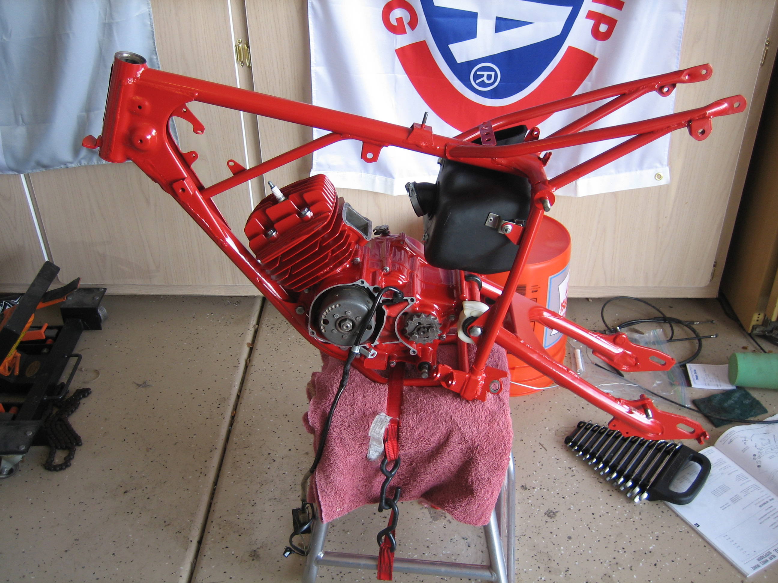

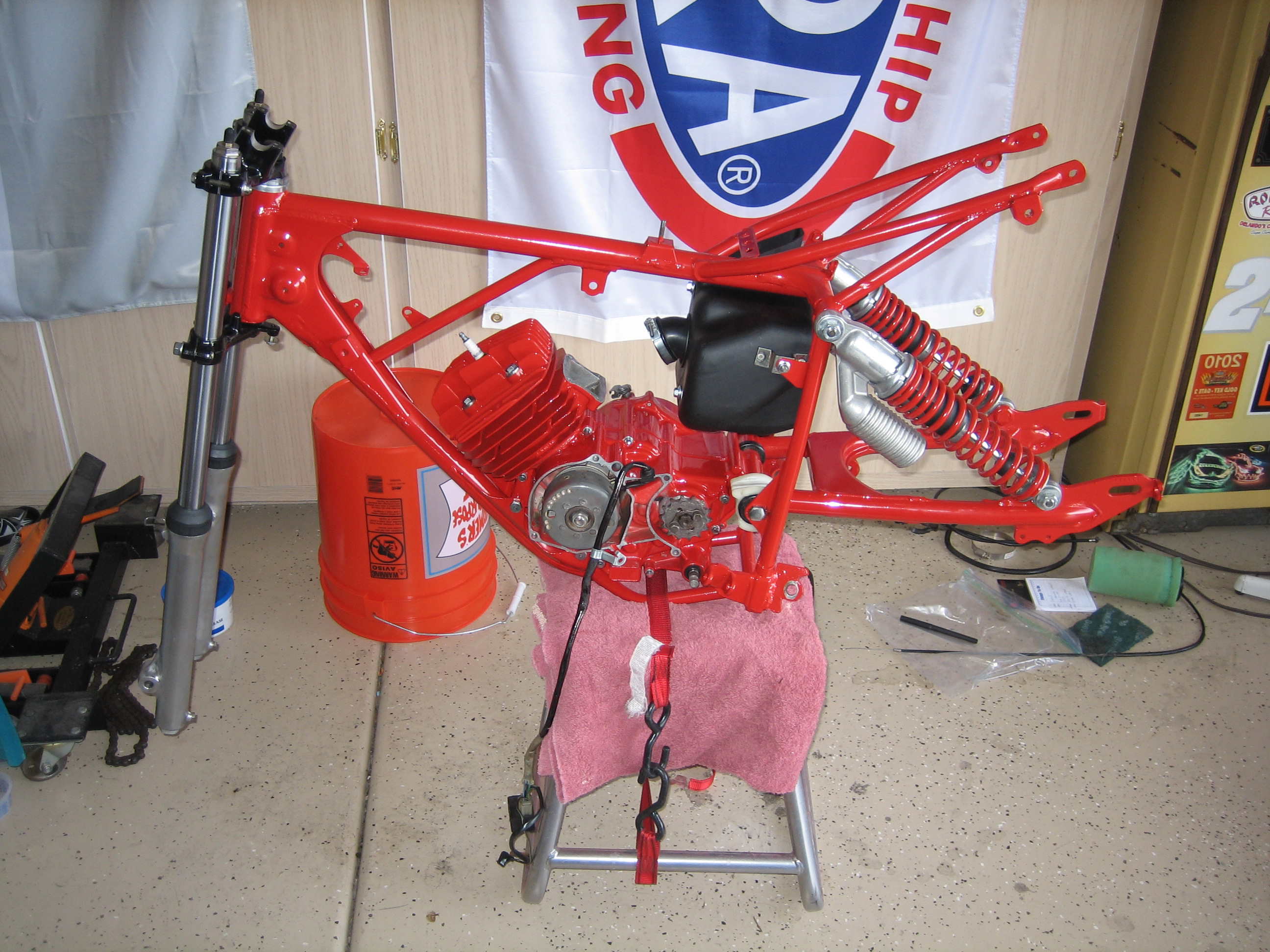

The next step was to get the engine in the frame. We spent a lot of time painting the engine. We removed the head and cylinder and carefully painted each piece. We did half of the engine case at a time. Removing each bolt and polishing them one by one.
Other than removing the carbon deposits from the piston and head, ther wasn't any reason to break open the case. The bike ran great before we tore it down. We marked everything carefully and removed all the little bits before painting. It was great to put something back together rather than taking things apart.

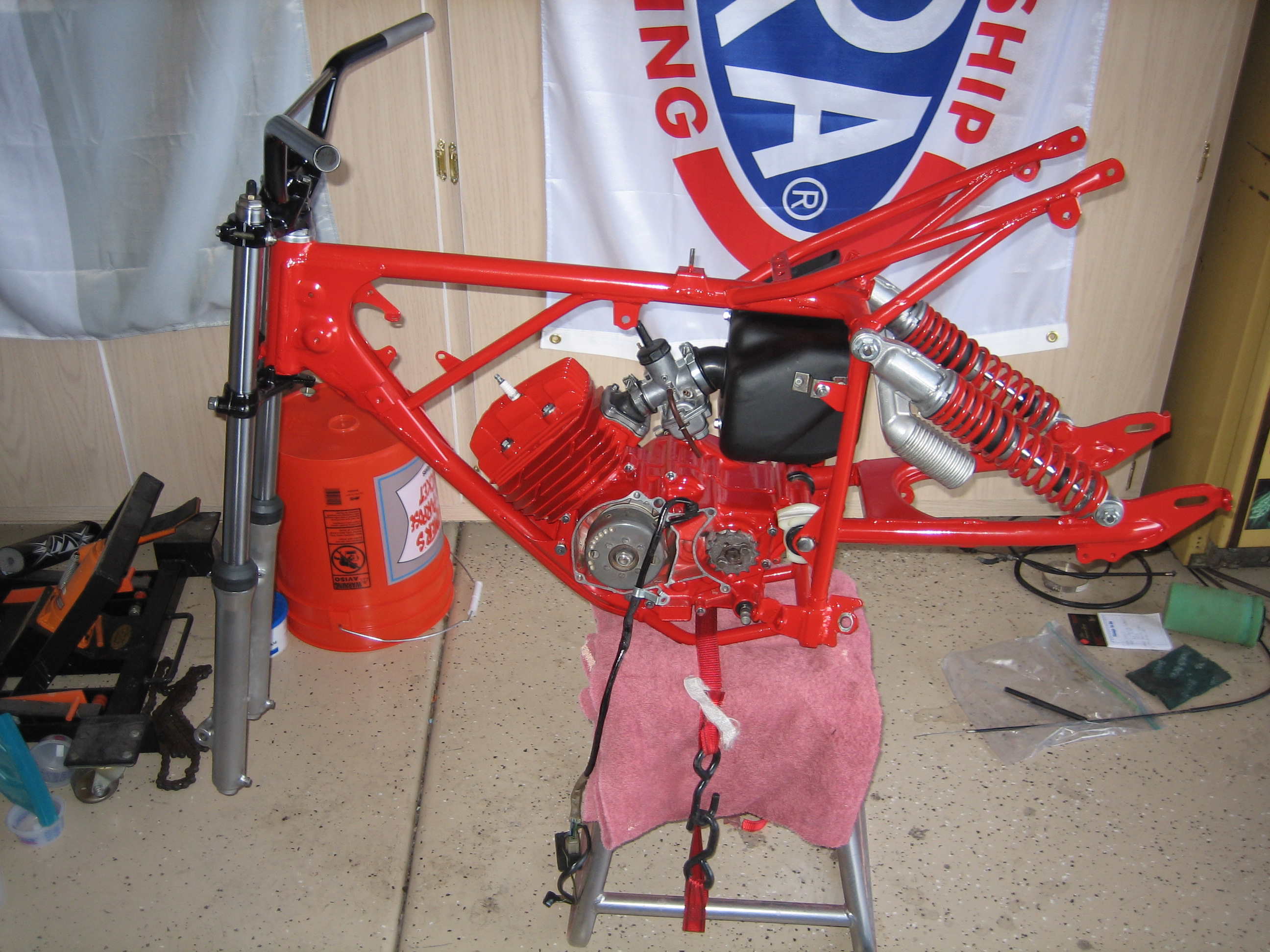

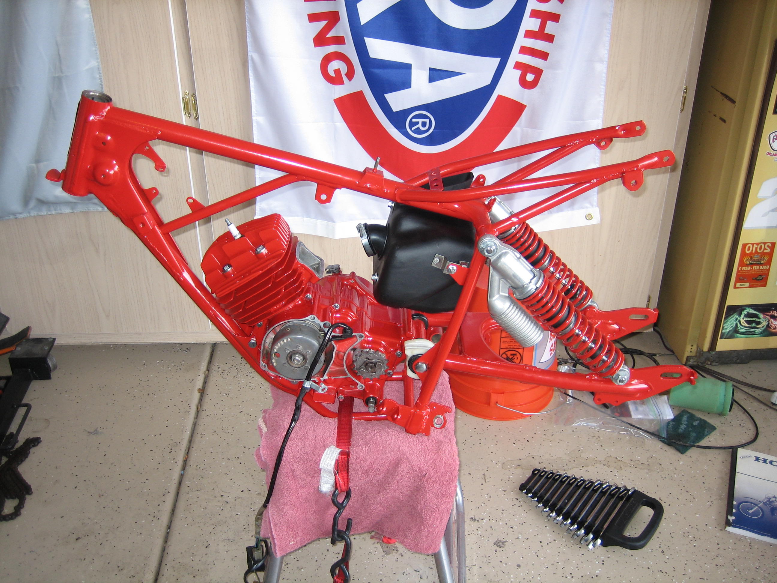

We had to start thinking about the black colors as we added the airbox. As we studied old photos it was hard to tell what was matte and what was gloss. We decided to keep most black parts on the lower parts of the bike in matte hi-temp black and use gloss for the more visible upper parts of the bike.
The airbox was the first matte finish. We, like most people with these bikes, are missing the air box cover. If I ever find a nice one, I'll add it. For now, we ordered some black foam from Uni-Filter and made an air cleaner that keeps the missing cover from standing out.

The shocks were a real challange. Compressing the springs to get them apart was tricky. We used an automotive spring compressor that we modified by cutting off a couple of the hooks to grab enough of the spring to compress it. It was sketchy to say the least.
Once compressed, the shocks came apart easily. They were still stiff enough to meet the spec in the owners manual. We spent a few hours with the wire wheel cleaning up the metal and then used a wheel clear paint to cover them.
The springs went in the bead blaster and then were painted.
Re-compressing and assembling left a few nicks in the paint that we touched up later. They really came out great.

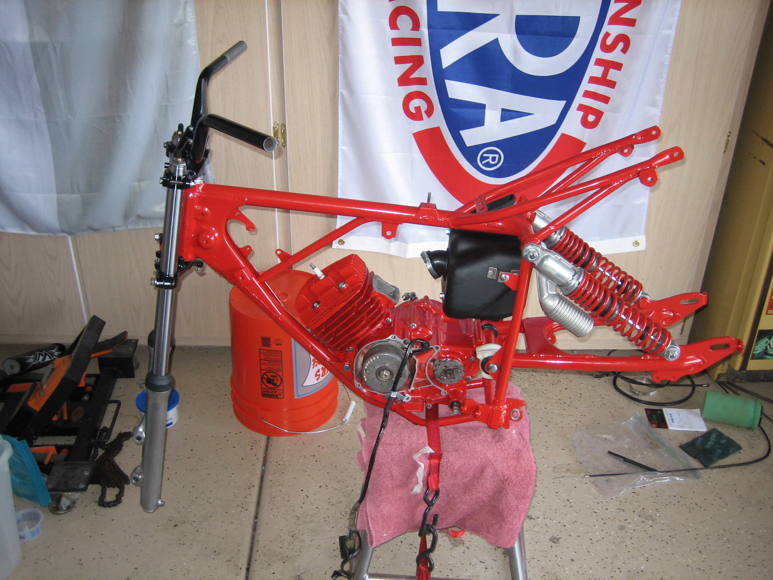

Like others, once the triple tree was removed, we were searching around on the floor for bearings. We painted it with gloss black, repacked, and spent some time getting the torque right so the steering movement wouldn't bind.
The front shocks had to be re-done internally. Once past that hurdle, we spent a bunch of time on the wire wheel and then sprayed them with wheel clear to preserve the finish,
The original handlebars were bent. We tried to straightent them on a press at work but only made them worse. A "reproduction" set wasn't even close when it arrived. We eventually found a straight set on ebay. We refinished them in gloss black also.

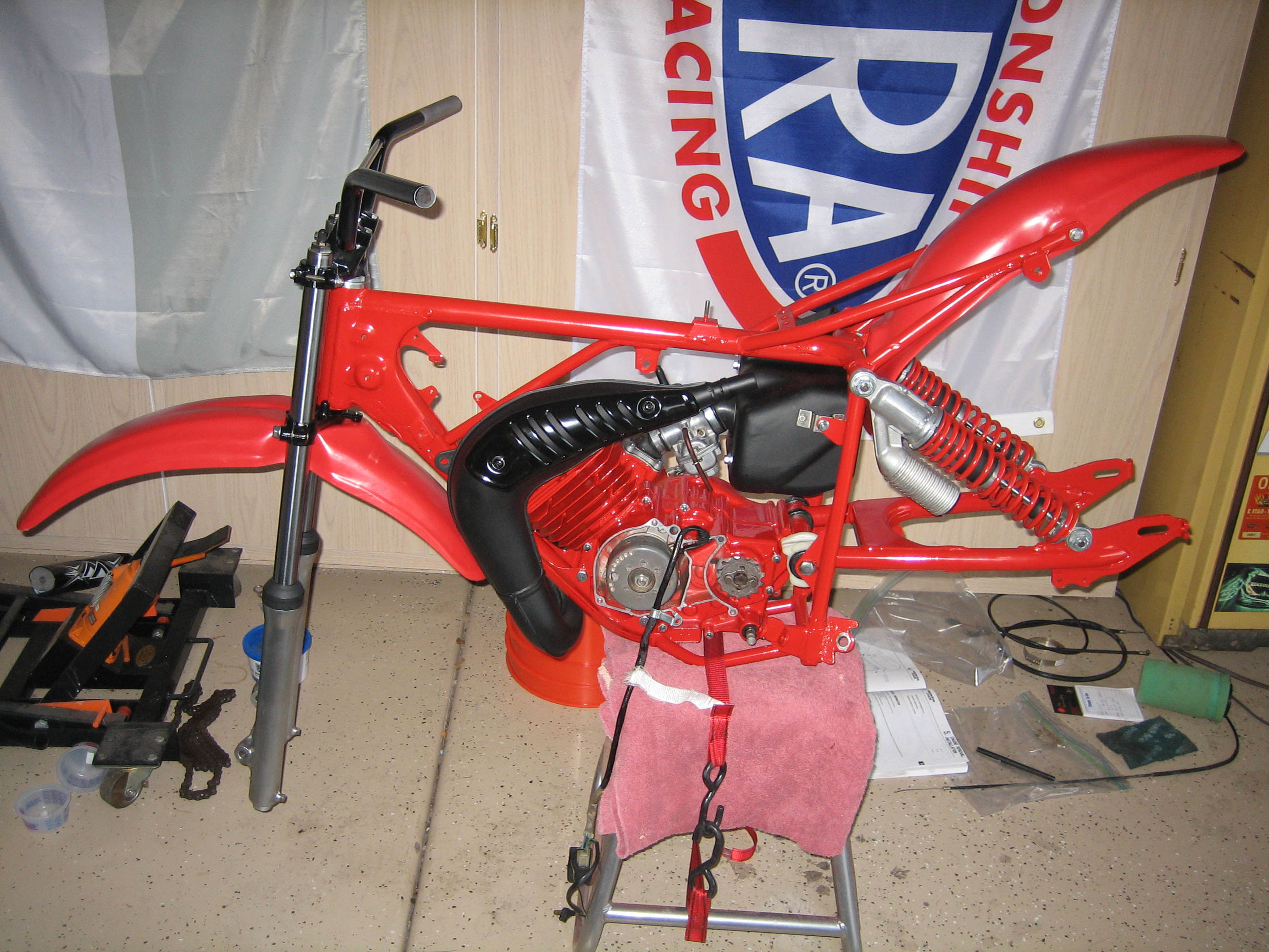

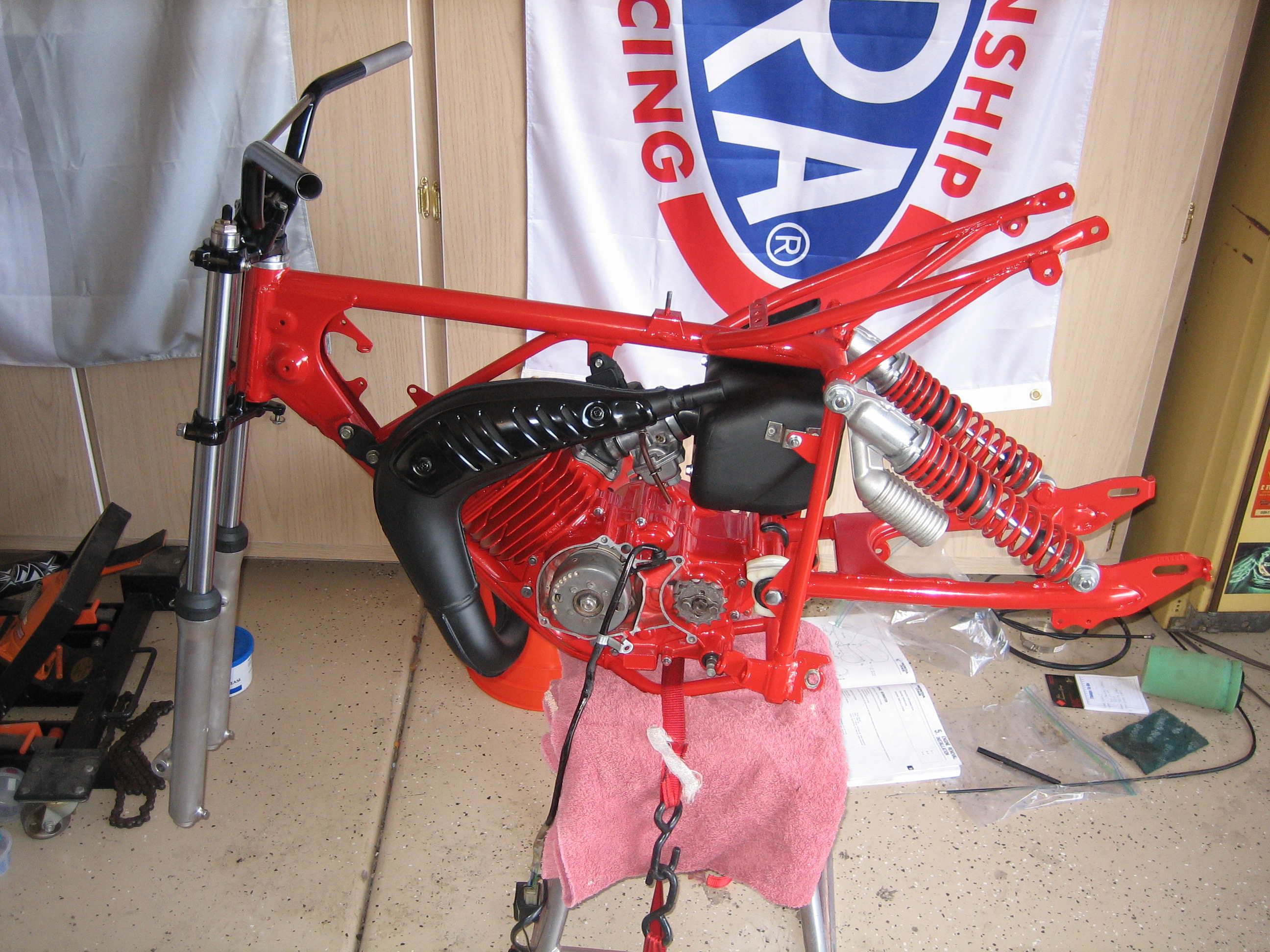

The expansion chamber had a few dings we worked out with a torch and pick. It is by no means perfect, but the matte black paint hides a lot. the heat guard was painted gloss for a little contrast.
The exhaust mounts were torn pretty badly. Some hi temp epoxy put them back together. We'll see if it holds.

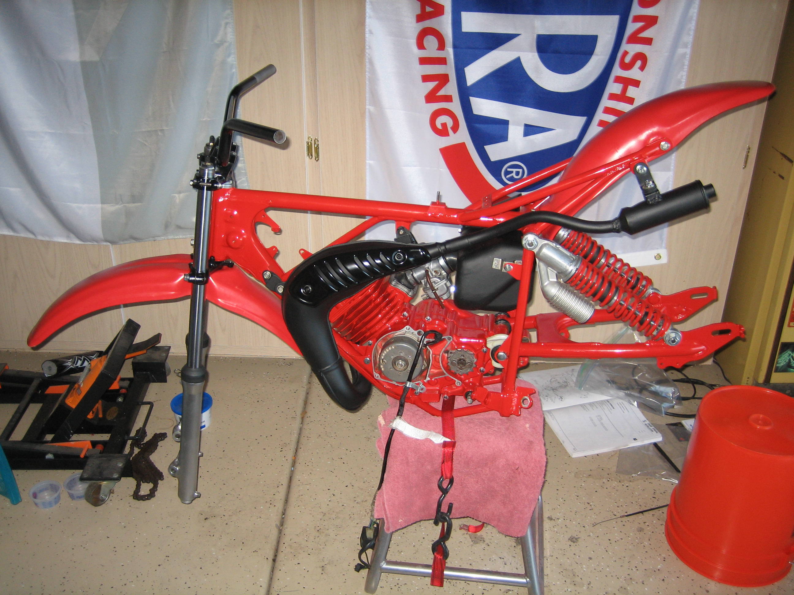

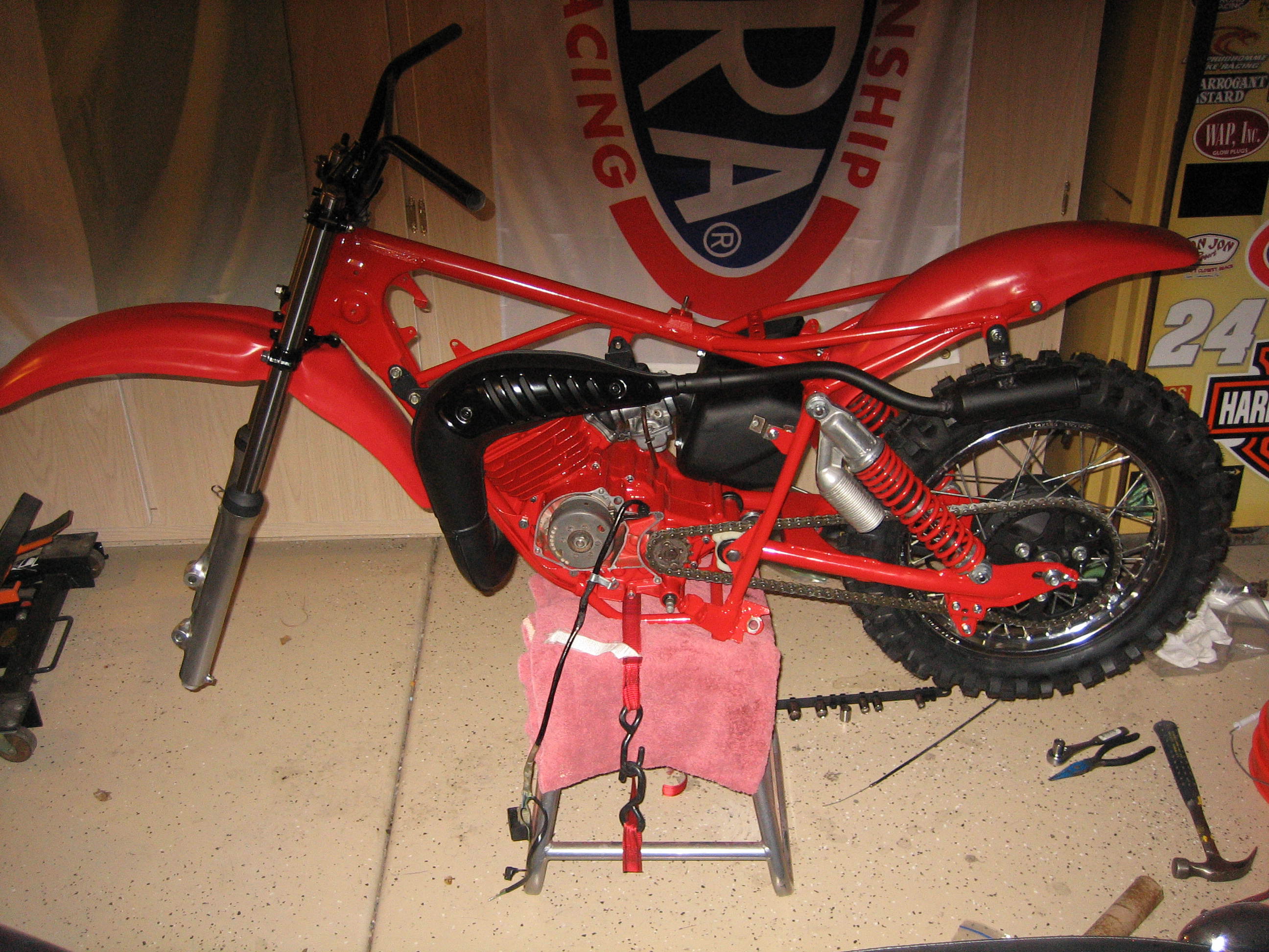

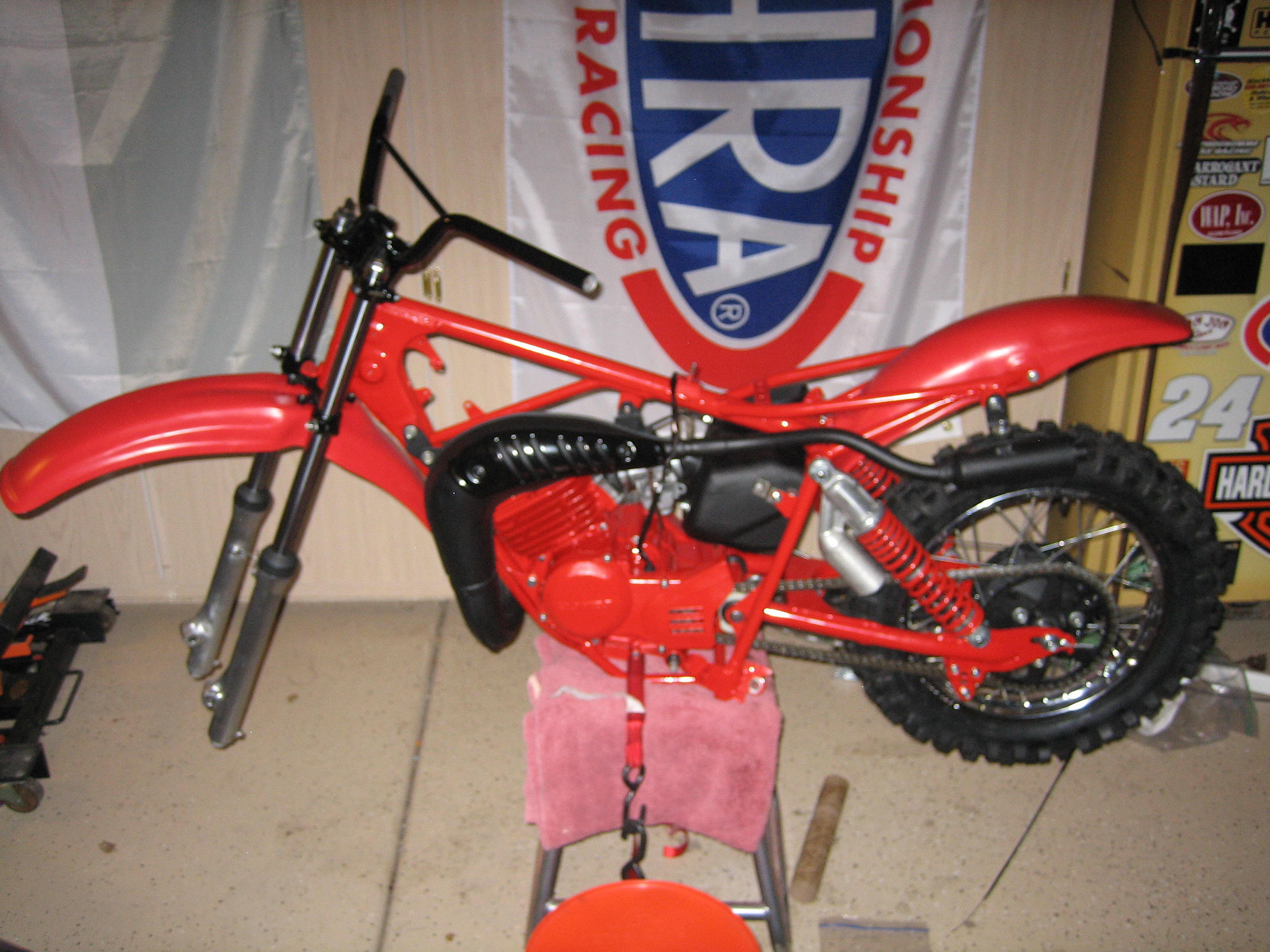

We got a set of DC replacement plastics and added the front and rear fender.
The exhaust was pretty beat up near the back so we straightened it out and painted it black with the same high temp paint.
We started out thinking we were just going to buy hardware new as much as possible. We quickly learned how much time that takes and how much it costs and decided to brush up our wire wheel/polisher skills.
