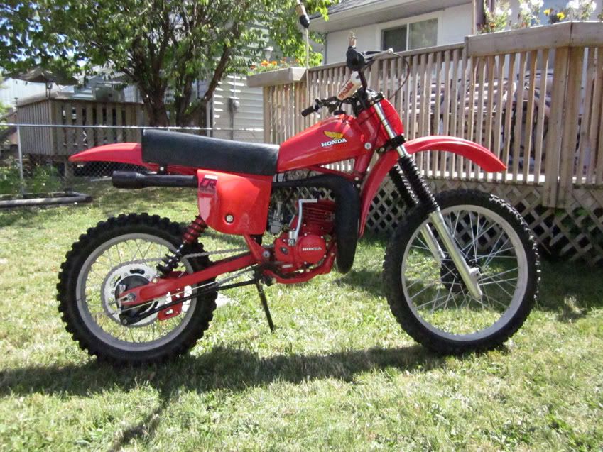

Well to cut to the chase, my 79 CR125R restoration is now done, but I am having an engine problem. It appears that tranny oil is getting into the cylinder and eventually running out the exhaust manifold and pipe and coming out pure black. I rebuilt the engine the first time a couple years back and got this problem right out of the gate.
Part 1...So I split it again, insured the two halves were sealed properly and replaced the primary drive gear seal as well. Oil is still coming out of the exhaust. All the seals were replace on the inside as well.
Part 2...Over the winter I purchased another engine in case maybe the one I have has a case crack or flaw (which I never saw upon the first or second splitting of the first engine case). I never split the second one I purchased. I painted both engines in case I had to swap them at some point. I took a look under the primary drive gear of the second engine and there was silicon all over the underside of the drive gear from the previous owner. I cleaned it off, swapped it with the first one just yesterday, fired it up and yup......same thing. Oil puking out the exhaust.
Now this got me thinking that I am not the only one that this has happend to. Sooooooooooo?????? Is this a design flaw or is there something I am missing. Is it possible that oil is travelling down the spline of the drive gear into the crankcase? I really don't want to silicon it all up if I don't have to. That seems like a cheap way of doing things, but if I have to I will. I filled the tranny with the recommended 10W40 as well.
One other thing, I mixed the fuel as per the manual 20:1. Now I know this might be a bit rich, but whatever is coming out of the exhaust is way more than the rich fuel mixture would account for in my opinion. It is litterally running down the exhaust pipe and dripping onto the ground when the engine is running at an idle.
I don't think I am a "back-yarder" type mechanic, and consider myself relatively intelligent, but this issue has me questioning myself quite a bit!! Has this happened to anyone else? Any help would be greatly appreciated. I need some sleep!!!! Thanks

Good looking resto you have there!
