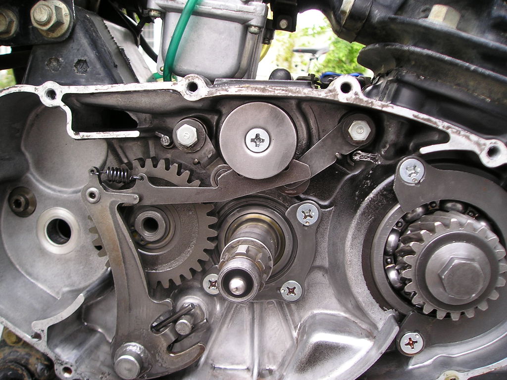

All looks good, from the outside, I guess it's time to go in...

What happens in the photo when you upshift/downshift with the lever? (the countershaft will have to be rotating for the gears to engage, obviously). Can the shift drum be rotated by hand, or is it jammed in position?

What happens: when I shift up and down, the exposed mechanism ratchets and move the way it should ( I believe). When I turn the back wheel, I can see the gear and shaft move lightly. I say lightly, as when I hold either with my hand, they won't move, zero tension.
Everything inside looked good, even the clutch basket/plates look new! Years of Bel-Ray have done pretty well. I mean if you don't count whatever is broken!
I've never split a case before, guess it's time to learn!

It sounds like all the gears continue to freewheel regardless of the shift drum rotation. I think woosh is right, most likely some kind of shift fork or drum problem.
