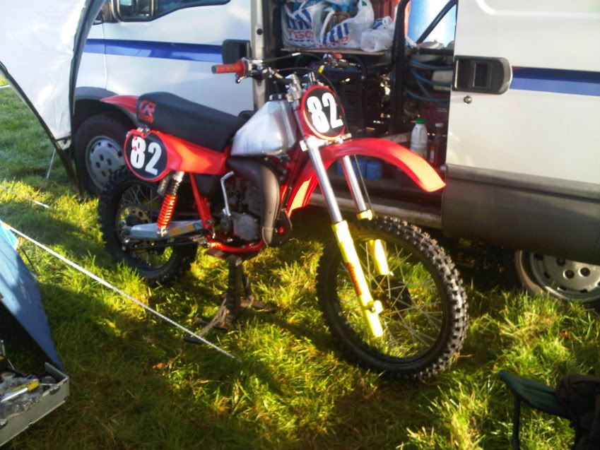

I have 83 480 forks on my Rocket and run them 10-12mm throtugh the forks, remember the top yoke will be higher as the stem is longer as well.
ImageI have the same setup on my 1980 125, again the forks through the yokes, I used the 125 stem with some shim paper as it was ever so slightly smaller.
