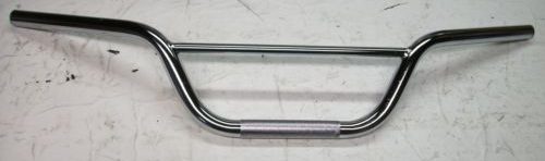

These look similar - notice how tall they are compared to modern bars:
http://www.ebay.com/itm/Vintage-MX-Hand ... 20bf3213a1
My MR came from the factory with one of the 5 different bars specified for the '74-'75 CR125M. I replaced the bent/cut up originals with Pro Taper SE 'ATV Mid' bars, with 150mm / 5.9" rise (supposedly). These bars weren't even close - when I rode standing up, I was looking down at the front fender - but I liked the pullback so I used 2" risers, and everything's fine now. I measure rise with the bars upside down on a flat surface with the grip sections flat, from the surface to the highest point on the center section. Using this method, the Pro Taper bars were a little less than 4.5"; perhaps Pro Taper rotates the bars to get an absolute-max height reading or something.
Hopefully some of this was actually helpful to you. :) If someone out there has found exact replacement CR125M bars or something really close, that would be great to know.

Ray,
I'm starting to wonder if my bars are original then or off a later CR model then, looking at your photos.
They look exactly like the chrome example you sent, with grooved lines all the way across in the same manner - except mine are Black.
I was thinking the original have a split groove with a smooth section in between where the bars clamp on. I'm not sure now...
