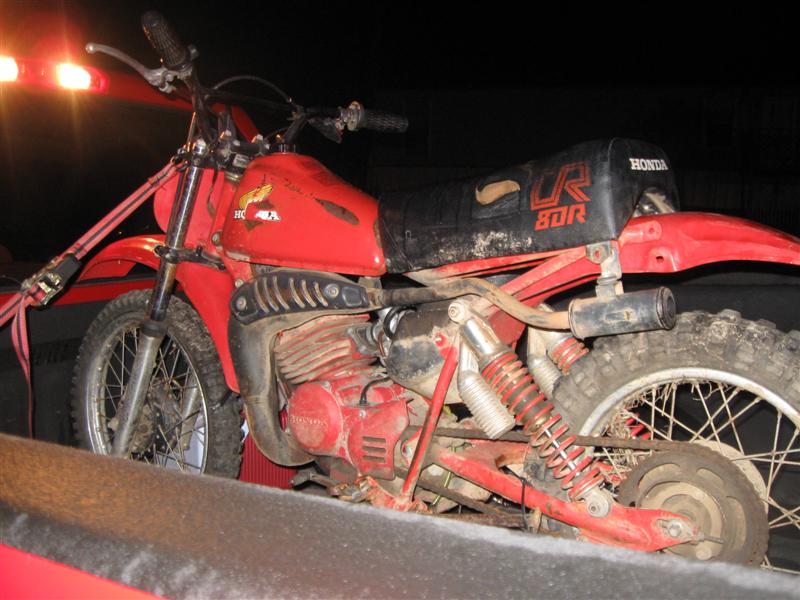

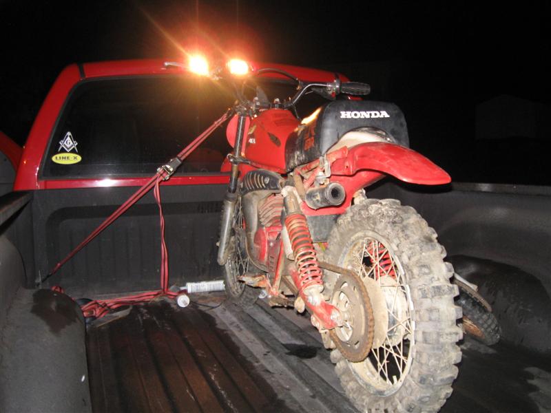

I traded a Yamaha PW50 for this bike somewhat accidentally @ 3 weeks ago. I put an ad in Craigslist B'ham Alabama asking for a fixxer-upper XR70/80/100 to replace the PW80 as my son had outgrown it. I had had the PW for @15 years-it was the first year offered. A man called me asking if I would be interested in a CR80R, 1980 model. I asked for pics and 48 hrs later we traded.

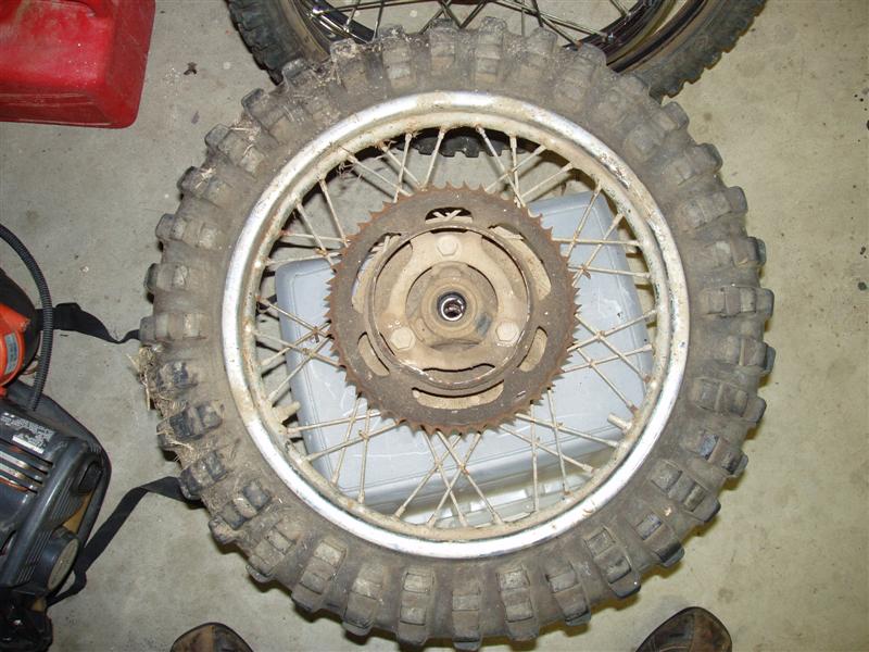

Here is a few pics of "BEFORE," as well as what it looked like 2.5hrs later after my 9-yr-old and I compleetely disassembled it. Motor had NO compression and the prev owner told me "someone had put a new piston in it but it still did not run..." After pulling head I saw why--brand spanking new piston with the used rings on it!!! SO i have ordered a Wiseco overbore piston (50.00mm) bottom end looks good.
Motor also interestingly had NO base or head gasket...piston ringls looked good and cylinder walls looked perfect--no scoring or scuffing at all. I considered just putting a new set of stock rings back in and honing it and seeing what kind of compression numbers I could get out of it but then changed mind and decided to do it right for sure first time with new piston/rings/wrist pin.
Generally it whas complete MINUS the rear plastic side panels and the airbox cover.

I will include some more pics of different stages of process in the thread for reference for others doing similar projects. WIll have to come up with side plastics and an airbox cover here in USA--apparently seem rare and expensive so far!!!

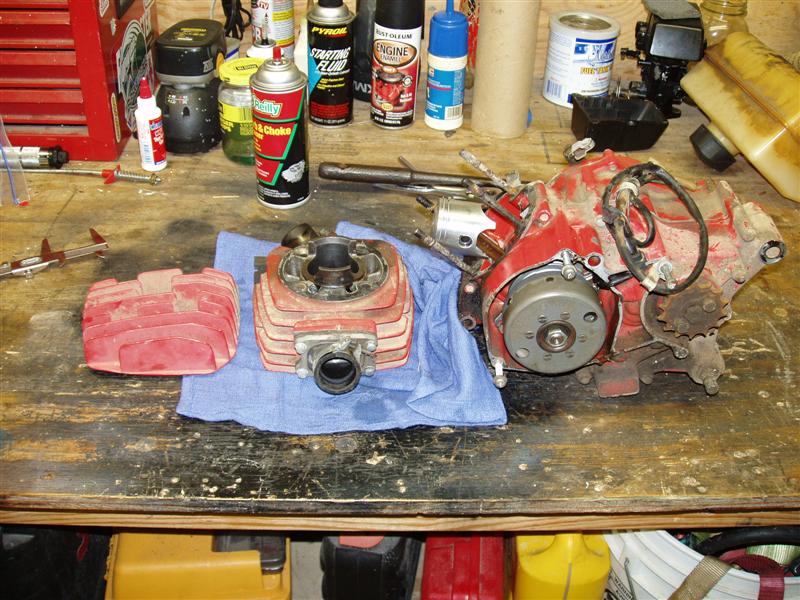

ANd here it is taken apart a couple hours later.....

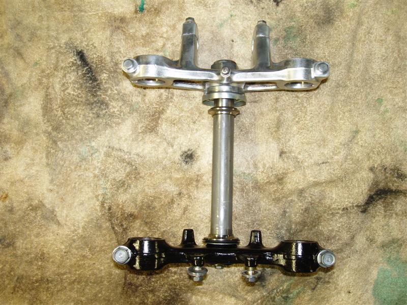

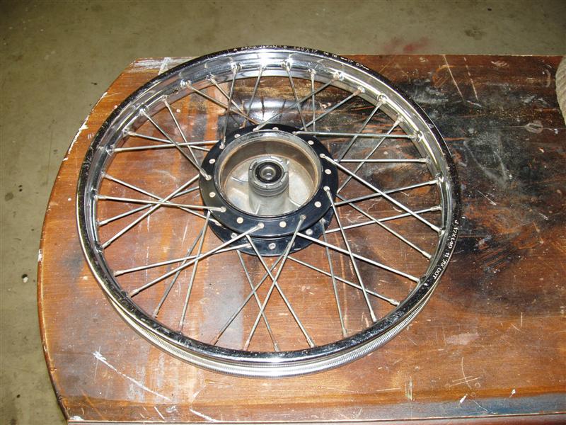

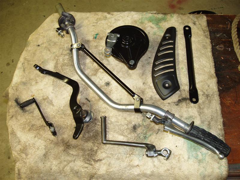

Here are some pics of misc. painted parts. I have also taken every single nut and bolt and washer from the bike and run them on the wire wheel to remove an rust/corrosion/residue. The rims were a little rusty but 99% of it was surface--it came off with a 0000 steel wool pad and water. A few rusty spots were pitted some but by no means severly.....the rear wheel is in need of cleaning and also as you may see in the pic if look closely, someone wired EVERY SINGLE place the spokes crossed each other---never seen that before. Could it be because they were loose maybe? Any ideas or explanation is welcome on that one.....
You can see Renthal bars I am using a polished/cleared upper triple clamp in this pic also.
The kick starter had lost its ability to fold in/out, so I disassembled it and cleaned and greased the little spring and ball/groove and WOW! what a difference--better than new I think!
Forks were in very nice shape also with VERY minimal pitting or rust--and none of it in the travel area fortunately. Polished them out nicely and replaced the fluid also so they ready.
Need to take rear springs off the shocks so can clean them well. I dont have a little mini spring compressor--any body got an idea how to do that also? Thanks DOUG
PS-will post pics of frame/tank/swingarm when get it back next week. Found some DG/Honda tank decals and was thinking of using them instead of the Honda only tank decals.....any thoughts?

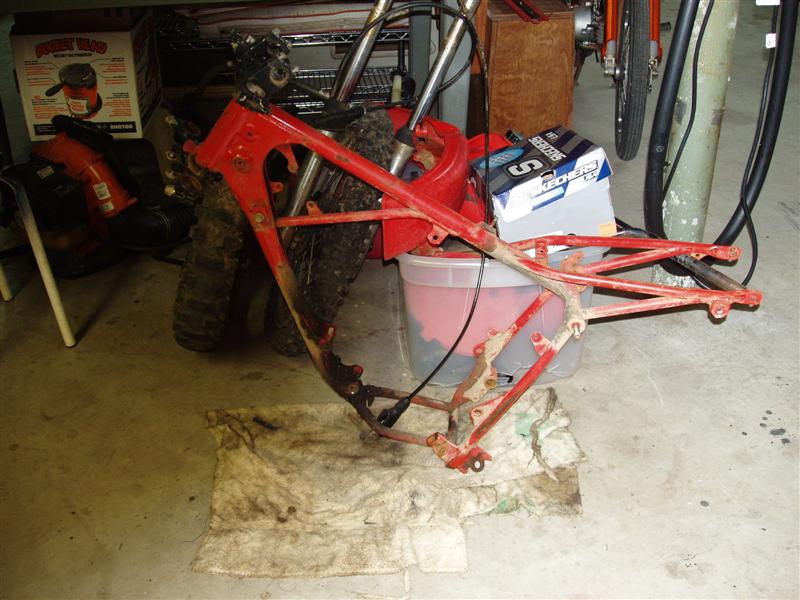

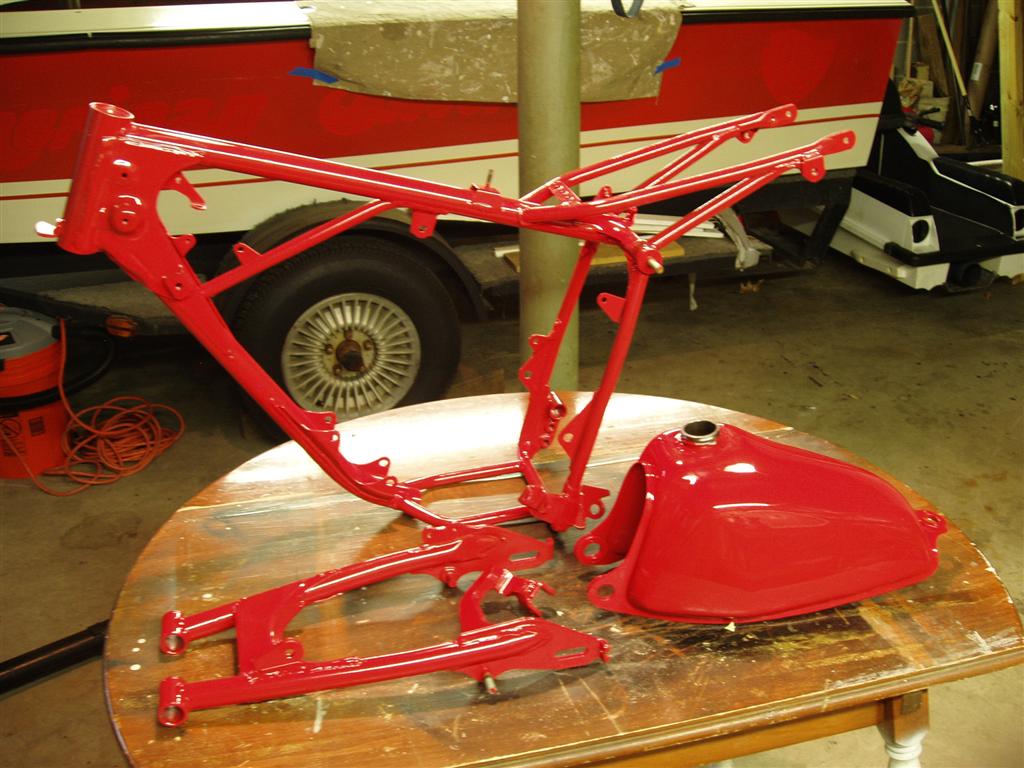

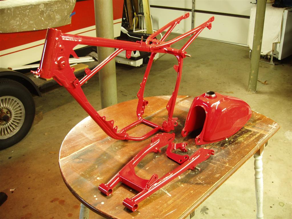

Got my parts back today--painted back to original--the tank looks SWEET! Can't wait to start putting it back together! Here a few pics.....
Hey-- if that was your CR80 "before" picture you get the prize for being obstinately determined to take something from nasty to awesome....nice work...LOVE me some "before/after" pics...will keep you all posted with pics on progress.
I am missing only the side panels and airbox cover....still looking

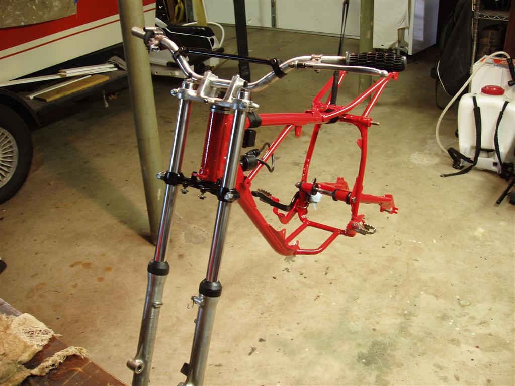

OK--got frame hung in shop sling and started re-assembling it last night. I had originally dropped most of the ball bearings from steering stem onto the floor when I removed it and thought they were lost and gone forever----but miraculously (you would understand that better if u saw my shop floor...!) I located all 42 of them down there so was able to reuse after thorough cleaning--the race and cone and balls were in great shape so did not want to have to spend the $$$ on new bearings if could avoid.
Got steering stem back together and triple clamps and forks installed. Put CDI/electronics back in frame stays and mounted handlebars and footpegs and rear brake pedal. Also installed swingarm temporarily. I have to take rear springs off shocks to clean thoroughly yet before installing them to frame/swingarm and dont have a spring compressor that will fit yet--may have to rig something...? ANybody got an idea other than the Honda tool to compresss that spring?
I am waiting on rear sprocket and inner tubes so can finish up wheels to install them. ALso waiting on brake/clutch cables and a clutch lever. Kind of at a standstill for now. I also need a grommet for the gas tank--I have 2 of the 3 rubber ones for it. WIll prob use them on front and go to Home Depot/Lowe's they have pretty large selection of rubber grommets should find one that will fit ok for rear tank mount bolt hole.

Here a couple pics of frame hanging--MUCH easier to assemble this way if you have never done it--just a couple eye hooks in beams overhead and use two Ankra type tie-downs to nylon straps--you can raise and lower it very easily as you work on it at comfortable level until you reach rolling chassis status---just an FYI...
Will keep posted as I go--DOUG

looks good, but sorry you installed the swingarm in a wrong way. :D :D turn it up side down.
PostPosted: Wed Oct 27, 2010 10:22 am
Posts: 64
Yeah, noticed that right off after shooting pics! It switched over now--I was dry-fitting a shock and realized I'd put it on there upside down! Have to remove it again anyways for engine install, so....will post more pics tonight --got it mostly together minus wheels/engine last night.
Waiting on brake/clutch cable, f & r inner tubes, and sprockets/chain to make it a roller--then will go through engine.....new piston/rings/wrist pin should be here soon also maybe today or tomorrow.
