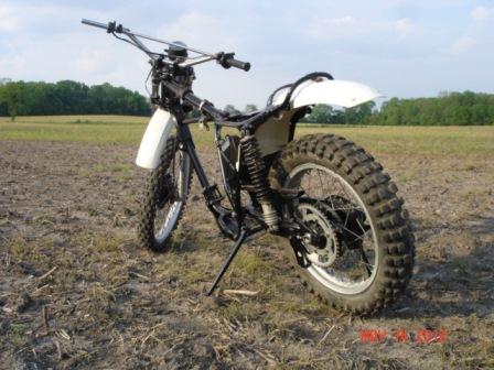

Well this is the best I can do at this point. Hopefully they are a little larger.
Thanks for looking.
