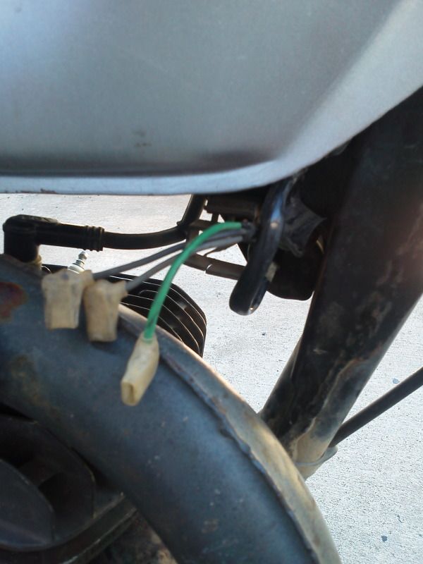

I seem to have posted a little prematurely on this. I went and messed with the wiring a little, and found one of the green wires at the taillight unplugged. Plugged it in, and now the brake light works. Still no taillight though, so I'll have to test that a bit. I also found three wires just dangling under the tank, I'm assuming this is where the "winker relay" is supposed to live, but there's three wires. Everything I've found says a two prong relay is used, so I'm not totally clear on how this is supposed to be wired.

I have downloaded and studied the diagram, but it's not the clearest scan and what it says doesn't always mesh up with what's on the bike. Whether that's manufacturing variance or just this bike having been messed with over the years I don't know, but that makes it a bit difficult to get to the bottom of this whole thing. As an example, that diagram shows two greens and a brown to the relay, where there's two browns and a green here, it also shows one green not connected.

The green wire is not used on the "winker relay" the "G" in the wiring diagram stands for Green. the "Gr" stands for gray, and the "Bk" stands for black, look at the wire colors closely. I recently purchased a new winker relay from Bike Bandit for my MT just a few weeks ago, They carry quite a few parts for the MT. I have purchased numerous items from them for mine. The website is www.bikebandit.com. Go to OEM parts and input the year, make, and model of your bike, it will bring up every part associated with it. They don't have all parts, but a lot of the small stuff that might be needed. I just got fork seals, levers, numerous screws and fasteners, new rubber for the pegs and kick start just to name a few. And on the rear tail light, and this might be a "Duh" moment, try replacing the bulb and make sure there is not a lot of rust inside the socket where contact points of the bulb might be. Make sure it's the right bulb as well, that takes a "1154" bulb. Hope this helps ya out some.

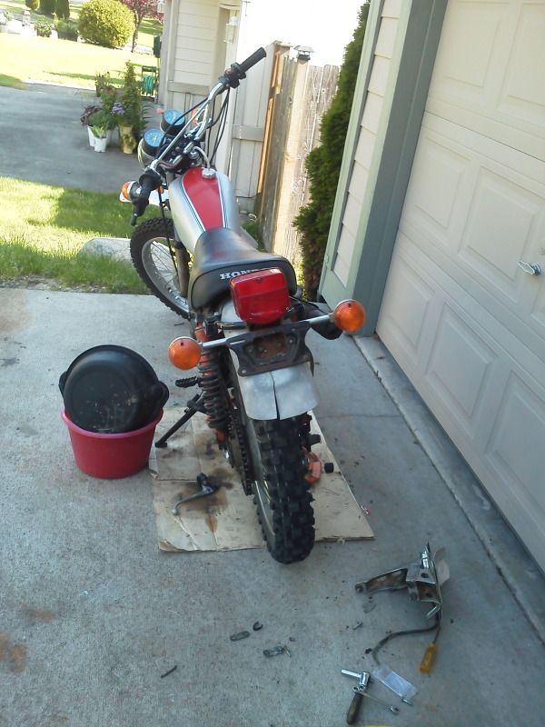

The stock style rear turn signals are difficult to find, and prone to being ripped off, so I adapted a different setup:
It's off a slightly newer road bike, but all the wiring just plugged in and worked. It also stiffened up the already damaged rear fender.
