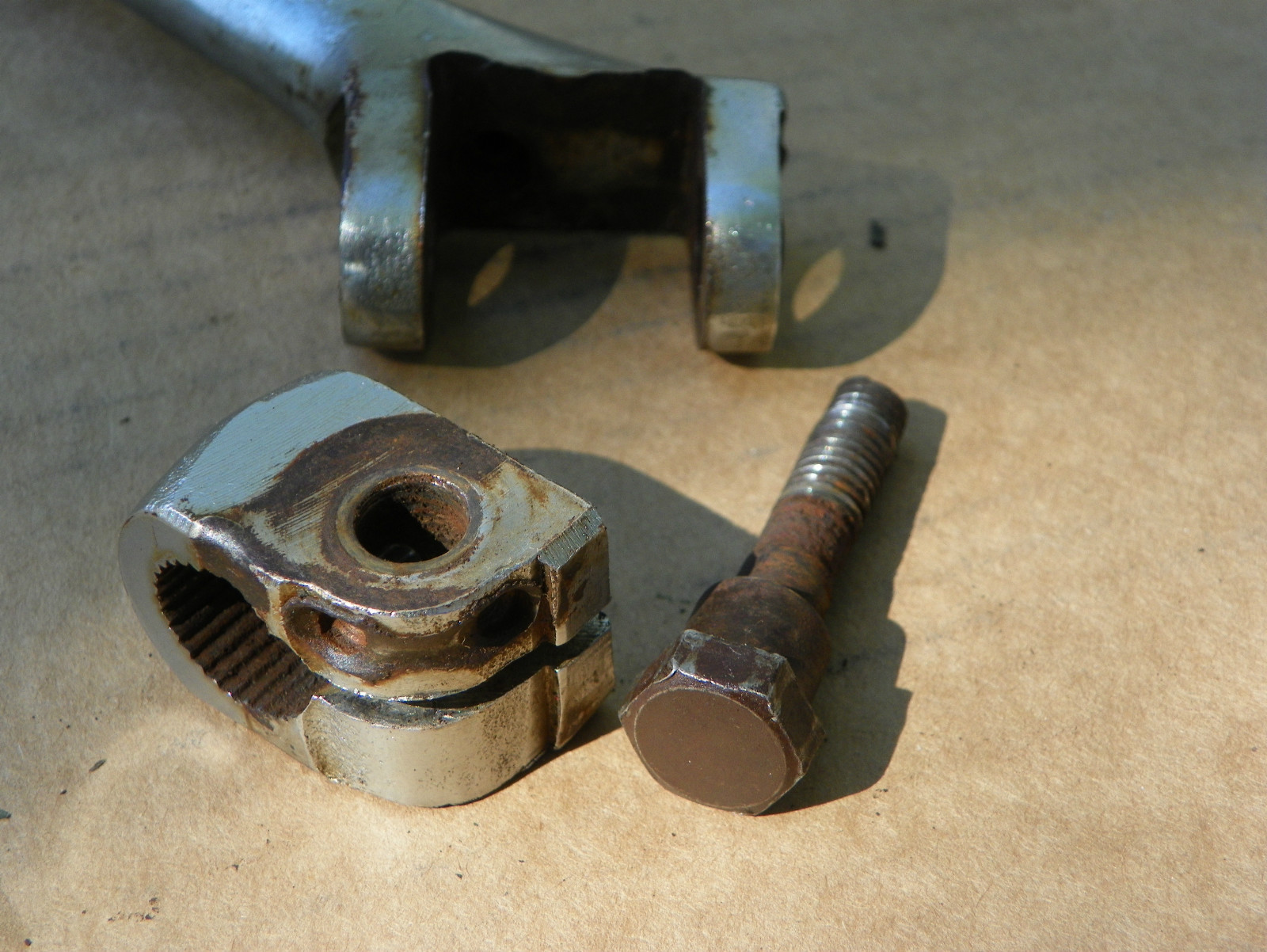

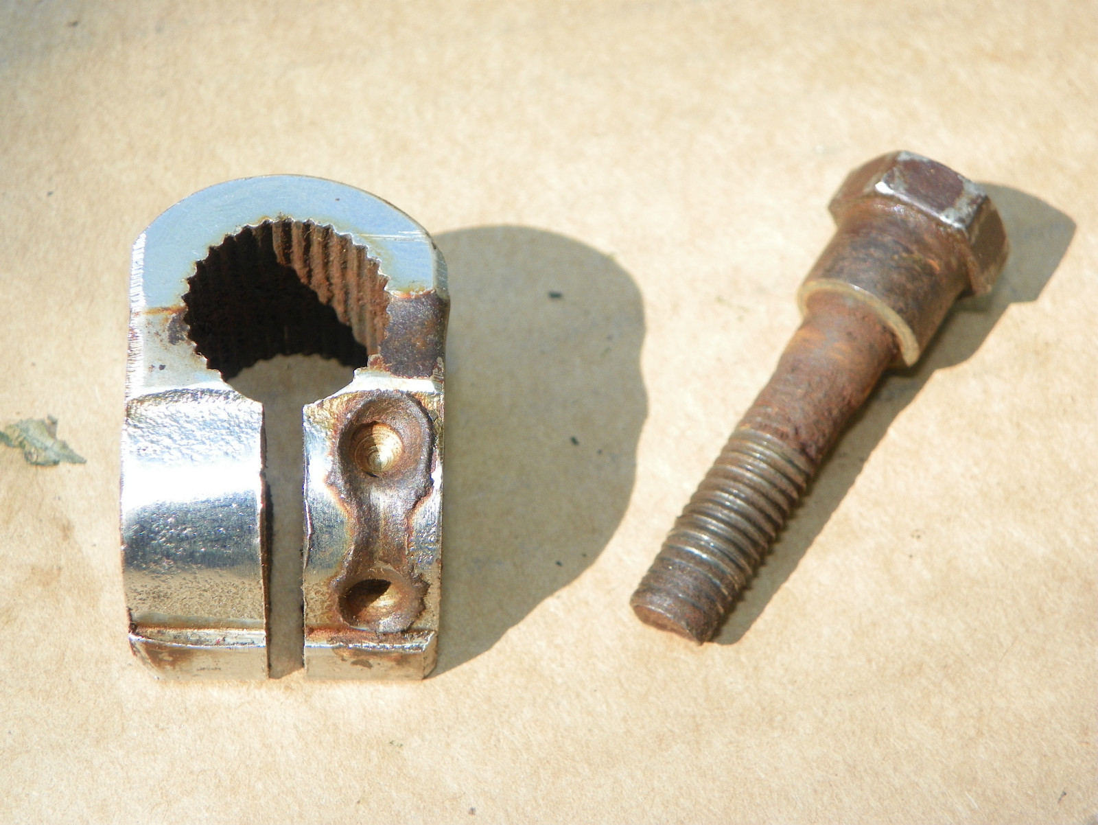

I have an original kickstart, clamp, bolt and nut, spring, ball, from a 1976 Honda CR125M. Anyone know what I'm doing wrong...When I tighten the bolt just enough for the clamp to hold onto the kick shaft it binds up the kick lever so it wont freely pivot...??? If I loosen it up enough to pivot it's too loose on the shaft...??? Am I missing spacers or somthing??? This is the type that only uses one bolt for both the the pivot point and the clamp...

Here's a couple of pics...just to be clear, when I tighten up the bolt so it is tight on the shaft it is too tight to pivot around...when I loosen it up so it pivots, it's too loose on the on the shaft and if i leave it like that it could ruin the splines...

I have attached the pics to this post, hopefully they show up now.
 Post subject: Re: CR125 KICKSTART
PostPosted: Mon Oct 01, 2012 10:34 am
Those photos are fine. Here's my thoughts:
1) The bolt is definitely incorrect for that clamp type. From the raised writing I see on the top, it looks like it may have come from a hardware store etc.
2) I can't see enough of the nut to be sure, but if it's not a cylinder with a hex head on one end. it's not the right nut.
3) As mentioned earlier, the washer is not original.
4) There's a possibility the lever is not the correct one for that style of clamp joint. If the pivot holes in the lever are less than 12mm in diameter, it's the MR175 one that uses separate pivot pin and clamp bolt, but otherwise looks identical.
If the lever is the correct big-hole unit for that style clamp, the proper shoulder bolt/barrel nut setup should hook you up. If the lever is NOT correct, you'll need to find the correct lever (you could try an MR175-style clamp, but it may hit the brake pedal when the brake is applied).

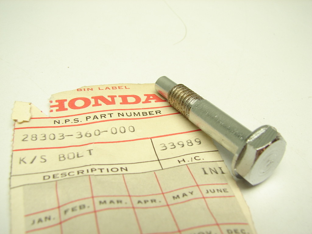

Hi rayivers, does this look like the right bolt?...the guy says its from a 74-75 but it looks similar to what you described and your picture. Thanks.
PostPosted: Thu Oct 04, 2012 8:13 am
Yes, that sure looks like it, I saw that kickstarter this morning and immediately thought of you. :)
