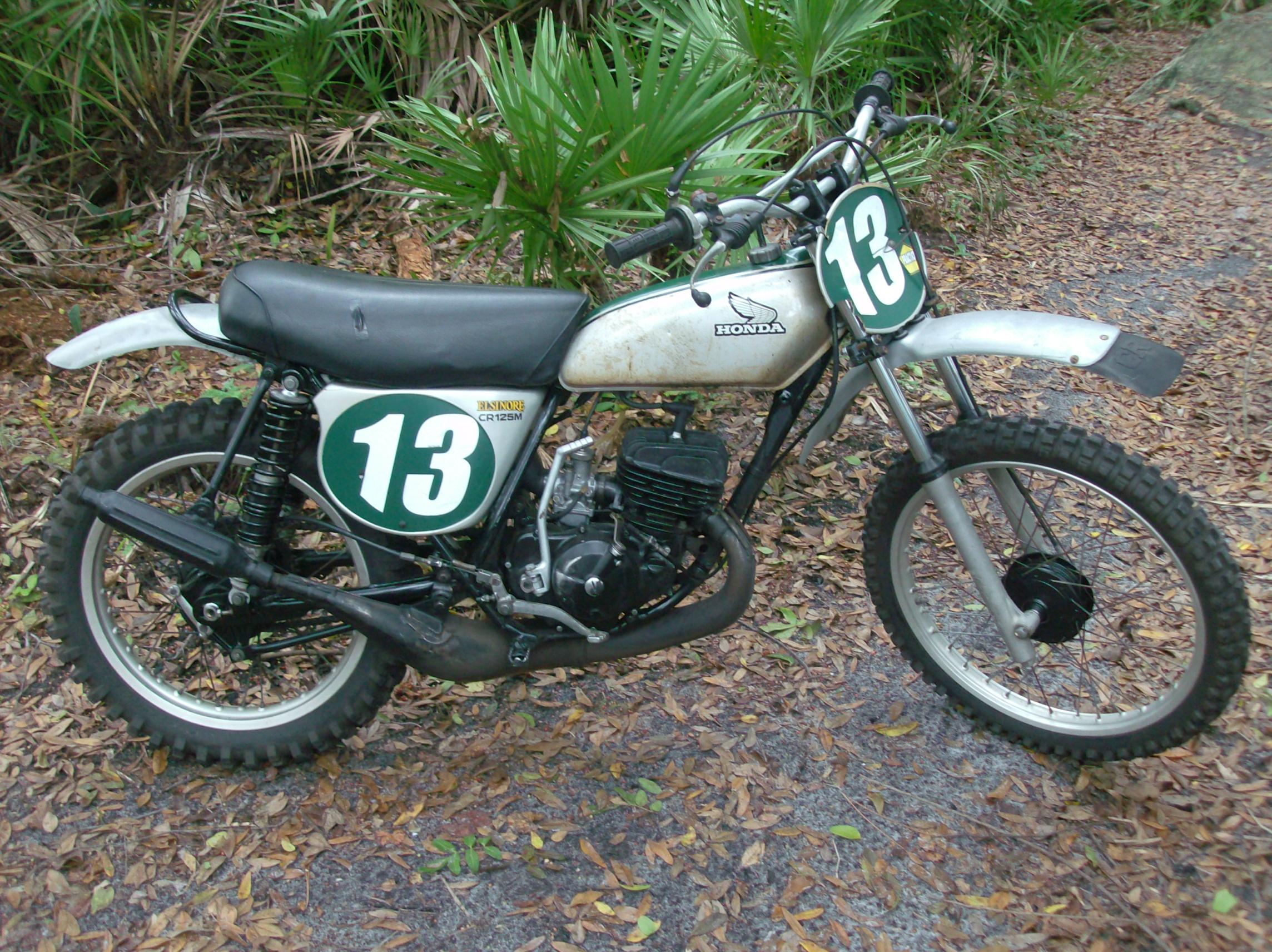

Just wanted to say hello, I'm new here. I am in the process of getting a 74 CR ready to race hare scrambles in Floriduh with FTR. My wife, two kids and myself all race modern bikes in MX and HS. I set out to race an EVO bike also, but wound up vintage.
My 125 came from the original owner and is a local bike. Bike is completely original, right down to the tires and tubes. It was sitting since the late 70's until last July of last year. Engine and trans are new now with all Honda NOS parts and I am starting to work on cosmetics. I am not trying for a full on restore as I intend to race this bike. Actually, it was already raced recently at Mesa Park MX and brought home a 1st place trophy. Bike runs perfect, just needs a facelift.
File comment: Only thing changed are the bars.

Welcome! That's a cool bike - does it have a low frame serial number? I've never seen fork sliders like those on a '74, if they're original they may be quite rare.

Good catch. The fork sliders are newer, but travel is the same. I have the original forks and am working on them.
Bike is number 9557
Do you happen to know what bike those sliders are from?

I believe they are from an XR125/175 from the late 70's. Direct fit, but about 1.5 inches longer. I fabbed some internal spacers to limit them to the stock CR travel and ride height. Stock springs work with this setup.
The original forks will eventually be back on the bike. I need new inner tubes.

Got an ignition problem, but should be ready to race again in a few days, thanks to the generosity of the vintage community.

She's running again, better than ever. CDI was bad and the coil was going bad.
