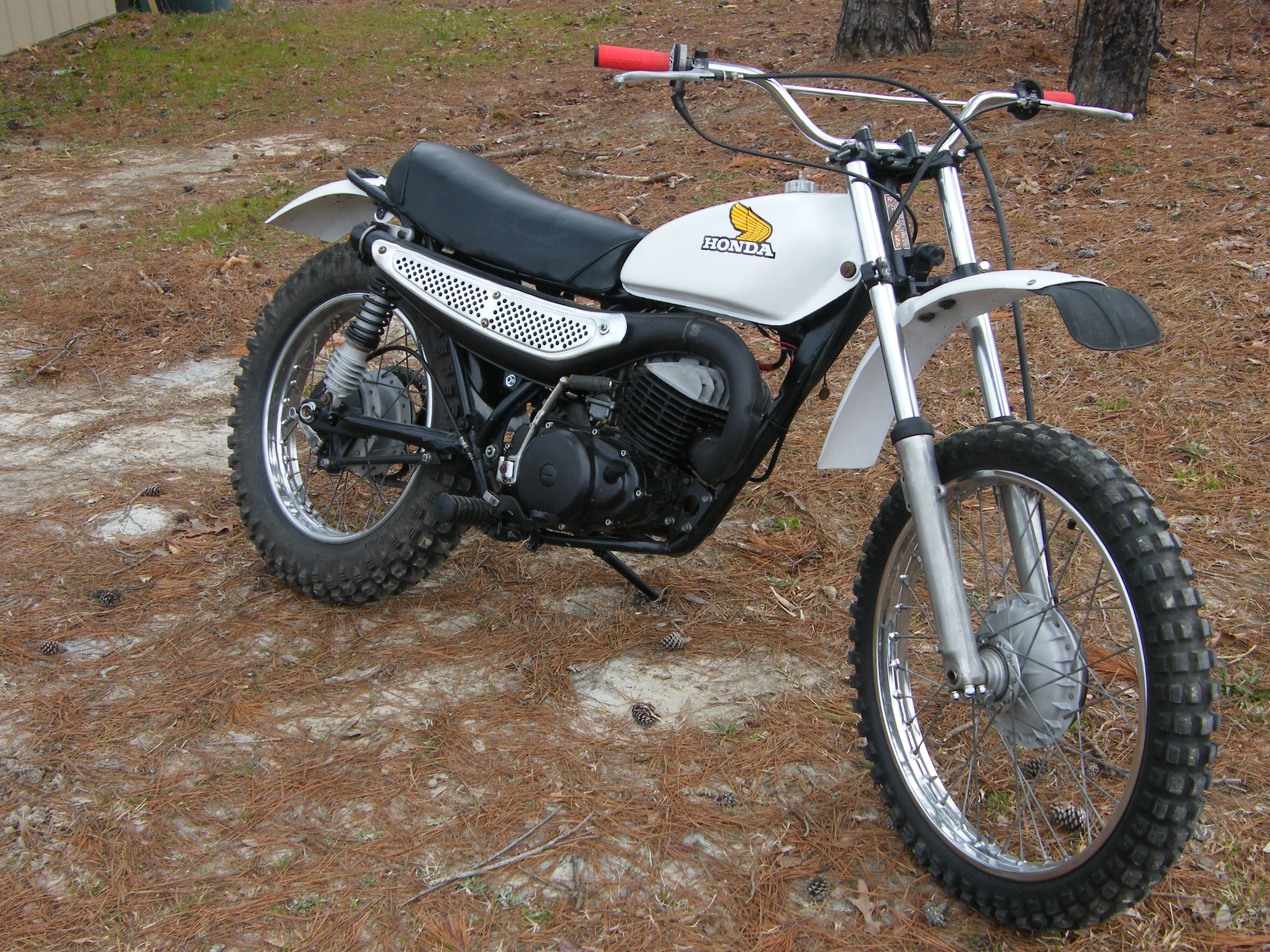

Finally got the bike together, long process. The bike was accually a barn find, it had 3600 miles on it and had been really abused. No lights, blinkers, horn, seat was rotted, tires were rotted, and you know the drill. But it had a fresh bore with a Wiseco piston bored 75 over. The bore may have been done yrs ago but it was clean, slick cylinder and no carbon at all on piston. It must have been really bad to bore 75 over with 3600 miles. Want to add a down swept pipe but thought I'd see if it would run before I drop the bucks! Dumped a pound or two of acorns and corn out of the exhaust before installing. Anyway, it started on the second kick, ran like a top and fouled a plug after about 5 mins, put the cap on the second plug, started first kick ran great for 5 mins fouled another plug. CRAP! my luck. Fouled 3 plugs, tranny has not lost any oil, crank bearing keeper plate has been removed so Im hoping new bearings and seals were added with the bore (who knows). Fitted it with a k&n air filter, put a fresh plug in today, removed the k&n and it started with the first crank reved out good, held my hand behind the carb and I am getting some blowback, not alot but I would think you shouldnt get any. Pipe seems to have plenty of pressure out the end. One thing I have not checked is the timing. Anybody got any ideas?
