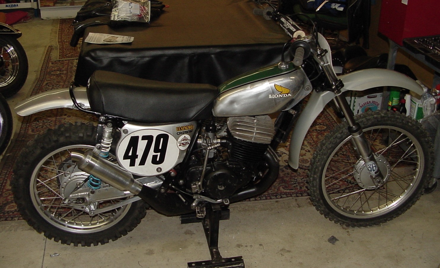

Finally got my 73 Elsinore running pretty good after some tunning. I recently completed an overhaul on the stock points and ignition after losing spark. My Elsinore is stock for the most part, stock pipe, modified fmf silencer, stock ignition. Found a couple issues today at the track I'd like some input on. Bike seems to need clutch in most corners to get into the pipe's mid range. I know the bike doesn't pull arms out down low, but the mid range hits hard and pulls clean Into the top end. Carb is clean respone is crisp. Using 110 vp mixed 50/50 with 91. 40-1 yamalube R. NGK B8es gapped at .500mm. Gearing is 13/47. Is this a common issue with these bikes and can adding a few teeth take care of this or is it another possible issue. Second as a result of clutching, I believe I may have used up my clutch as the last session I went to feather it and it was as if the cable had snapped. Then it would come back after I stopped using it for bout half lap. No other complaints as it ran in front of my buddy's worked 75 Bultaco most of the day.

Thanks for the reply, I was beginning to think I offended someone. I will do the clutch. Pulled the ,motor last night after finding a crack in the frame under the left foot peg. Drooping peg tipped me off. In the process of rewelding and reinforcing the frame now. Then I found a sloppy countershaft sprocket due to a worn countershaft 23221-357-040. Interested in a replacement part if anybody has one. Still trying to decide on the gearing. Up to a 14 or down to a twelve.

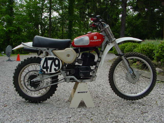

MUST MUST MUST beef up the pipe mount on the frame. I welded a new tab in the "V" of the frame and used vibe mounts and nyloc nuts. ( shown in pic dscooo44) My first snore build in 1993

I swapped my snore for a hoosk and it was night and day better.
Better: frame, engine, reed valve, electronic ignition, up pipe, radial head, air box, nuts/bolts (nyloc)
Same or worse: brakes, clutch, forks. ( you will notice a Honda front end on my hoosk, primo suspension and stop on a dime front brake.
A MAG Hoosk is the way to go

Well after doing some welding, shimming, tightening and prepping I got the 73 elsinore out today. Spent a lot,of time on the points, timing and carb. Moved clip up one slot. Seems to have paid off. Found some bottom end that had been missing from the motor. Mid now hits hard. Was capable of pulling the front wheel at will today with just a good twist of the throttle. Went back to stock gearing. And the clutch seemed to have regrouped. think ill try a couple of barnet springs. Ran a Spectro two stroke oil today specifically made for air cooled smokers. Mixed at 40-1 into sonoco 110/91 50:50 mix. Seemed to,run richer than the yamalube mixed the same. Overall really fun day. Next on the list, fix the leaking forks. Second set of seals and still leaking. Starting to think maybe the lower legs could be worn, doubt the chrome is thin. No pitting or rust. Any advise on good seals or techniques.
