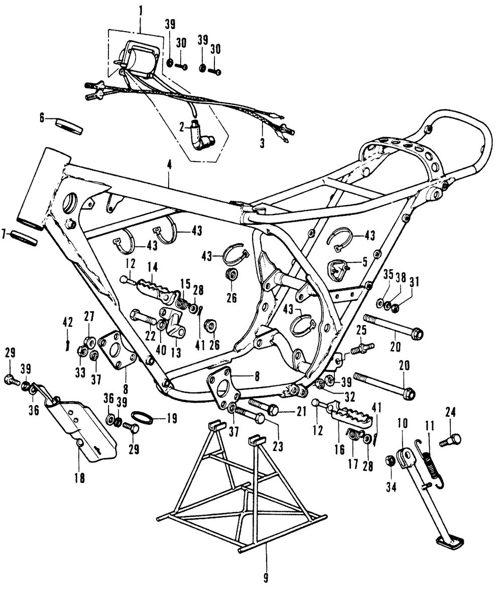

I noticed a part on call the "engine splash guard" when looking at an exploded parts view of the frame for the 1973 CR250M. The bike I am restoring is all original and this part is not on my bike and I have not been able to find any pictures of the part on any other restorations.
It looks like the part is still available though Honda, does anyone know what this actually is and why dont I see any on other restorations? Hopefully I am not totally missing something, any help would be great!
The Splash Guard is # 18 in the picture.

The guard and work stand have been long depleated from Honda. I had them do a critical search waaaay back in 1993 for them. I had at least 6 of them.
I rarely used them even in heavy mud races simply because I wanted as much air flow to the head as possible.

Thank you again! From what I can tell the splash guard was an optional part, is that correct? If that is the case I dont think I will bother with it unless people think it is important when doing a full restoration. I do believe they are still available through Honda and are listed for sale on ServiceHonda.com

Yes the splash guard, work stand among many other items with the last 3 digits of 810 to 820 were Honda "optional" items. Other items were things such as fork springs, rear shock springs, handlebars, chainwheels etc, anything that could be used to modify the machine as an option to stock.
Again I would say I have done a critical search of 99% of the "810" numbers from the 125 which has "360" as the middle part number code. Example 50500-360-810 the work stand for the 125.
The number code for the 250 is 50500-357-811, so if you happen to visit an old Honda dealer that has a ton of parts in a pile and you find a cache of "360" parts in bags you know you just found parts for a 125.
Sweet items such as the mud guard or work stands are gone, other optional items like cables, handlebars and other things of that nature were probably scrapped by dealers and I know Honda destroyed those long ago.

The splash guard was indeed an optional part and is definitely not going to score you any additional points
for your restoration. I would concentrate my parts search on finding the "big ticket" items that define the
"Green Striper" - fuel tank, pipe and silencer, seat, shocks, plastic. Once you have those, start working on
the next level of specific "357" parts - kill switch, perch covers, clutch and rear brake cables, coil, wire
harness. That should keep you busy for a while.
