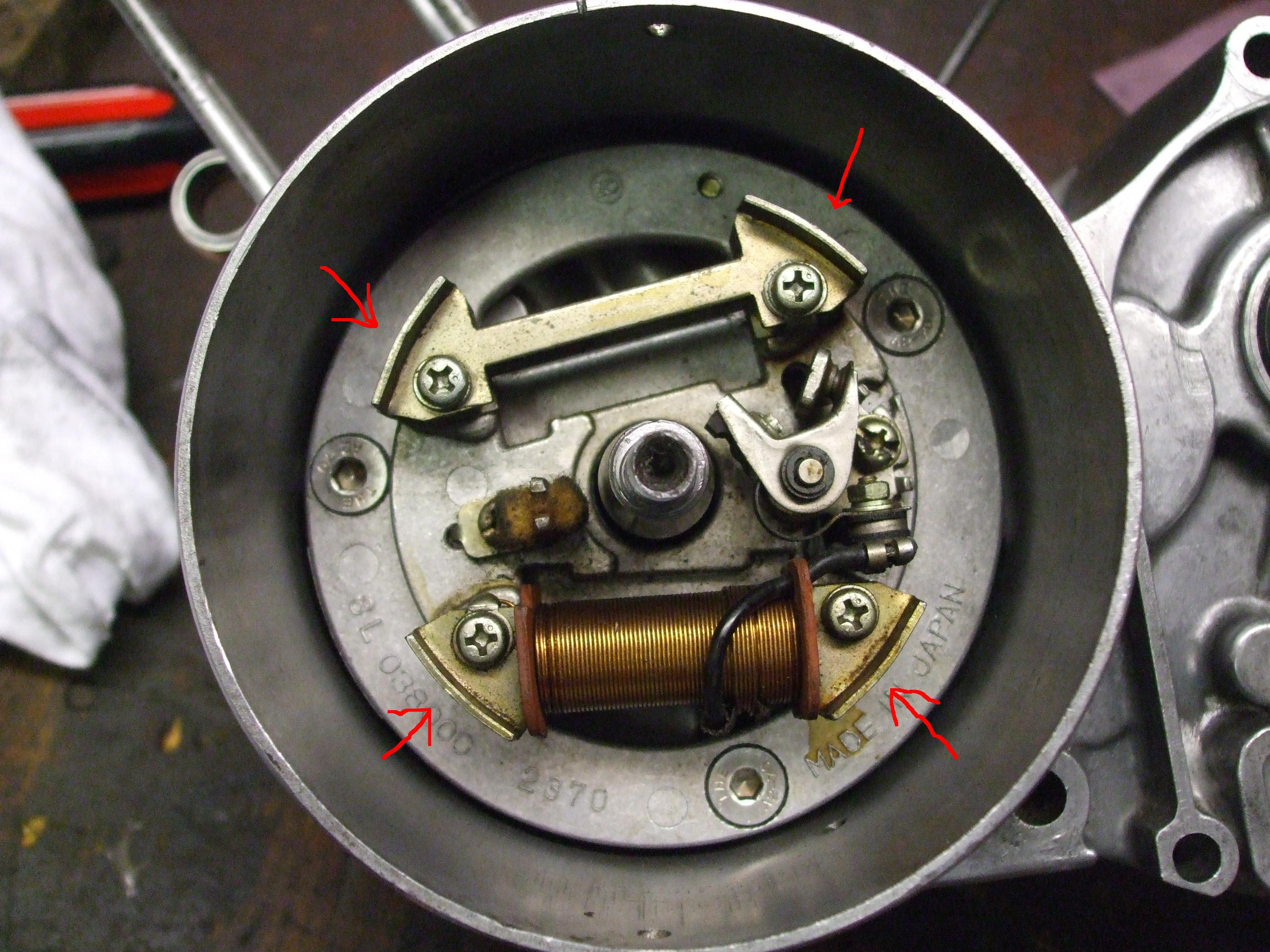

 Post subject: Re: 1975 MR 50 no spark
PostPosted: Wed May 01, 2013 7:13 pm
Joined: Fri Dec 28, 2012 4:46 pm
Pull fly wheel again and clean pick up at the stator and flywheel as well to make sure you are getting good pick
