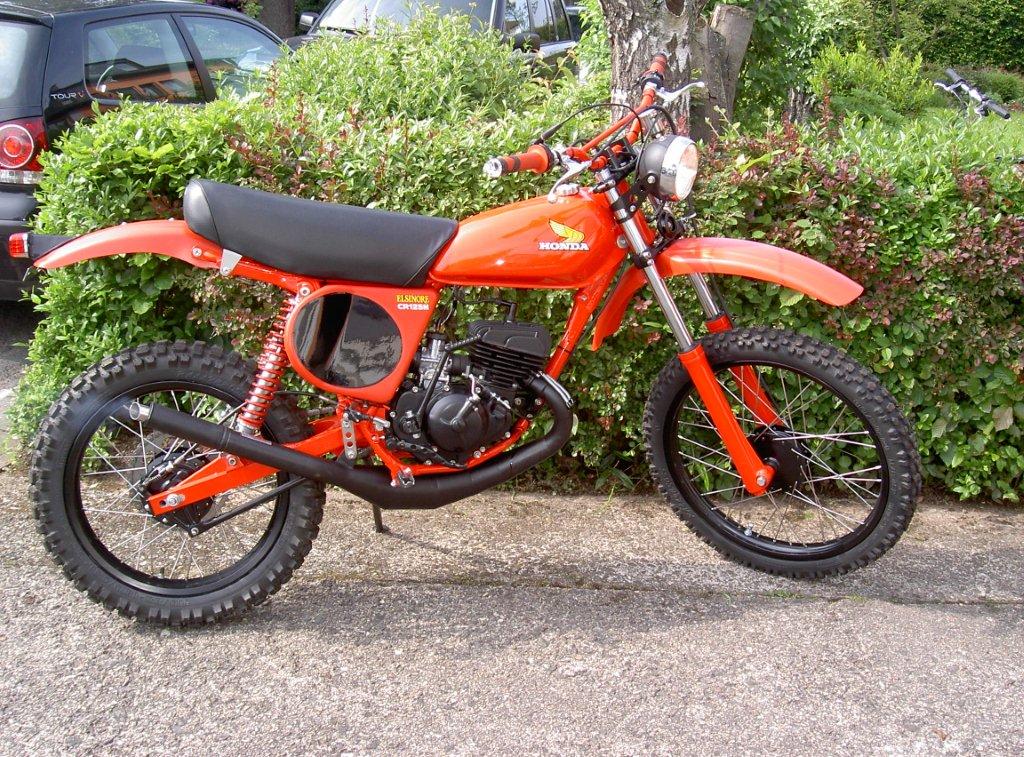

p.s. here's a little pic of the bike I'm going to road register it soon hope ya like it!!

The bike looks sharp! How do you power the lights, a battery?

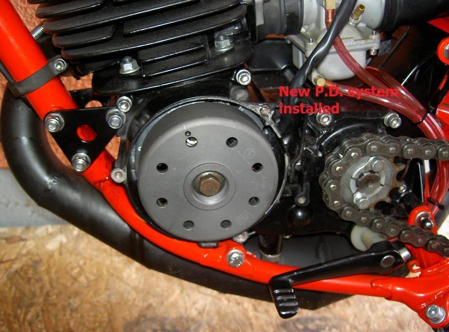

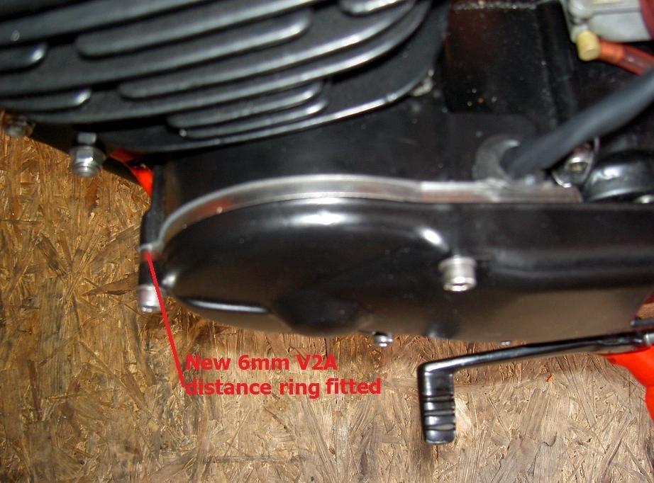

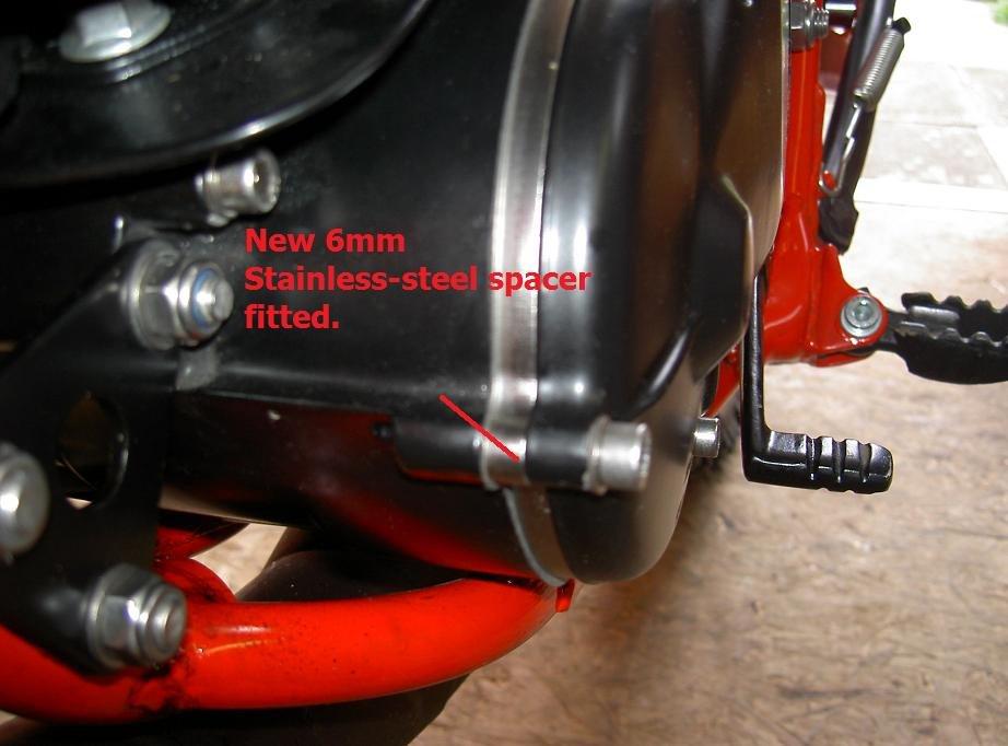

thought about modifying to a reed system but I think it would be a lot of machining involved not to say that i might have ago at it with an old cylinder sometime I'm just trying to get a happy comprimise.
the lighting is a German system I had made, its absolutely great no machining to do, simply replace old with the new one and fit the distance spacer between engine and crankcase cover (see pics) the system delivers around 120 watts more than enough for head and taillight, horn and a couple of indicators, wiring it all up is around a 2 hour job when you have everything at hand.

Wow, that's some serious ignition system you've got there. Honda really should've put ignitions like that on the MT and MR bikes (like Suzuki had done years earlier with their TS series) which would have made adding lights to the CR's much easier. Can the German place produce more, or was this a one-off?
The reed valve suggestion is an excellent one. If I ever get around to resurrecting my original CR motor, that's the route I'm going to take.
I believe Honda kept increasing CR125M intake port duration to try and keep up with the reed motors at least in peak power, but that makes piston-port motors run crappy down low. If you lean out the jetting to compensate, you lose your throttle response at higher revs. The MR175 (and MT125) have very different intake timing/duration, and pull cleanly under load from below idle if jetted even close to correct.

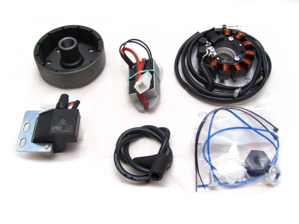

Hello Ray
the igniton system is now developed, I believe this system could be made for any bike really, Cr's, Rm's, Kx's, Yz's and just about anyother.
If you've noticed on the pic it's changed from an internal rotor to an external if you get my drift.
I have them on my yammy TY's all the range from an 80 through 250
I can order as many as you want. The distance spacer I make (or rather programed on a laser cutter)
I forgot to add:- the system is from circa 200 to 18,000 rpm with a smoothing condensor to limit overcharge, basically it's a full kit:-
new stator
new rotor
new coil + H.T. lead
smoothing condensor
rotor tool (for removal)
and instuction leaflet
all fits very neatly under the tank on the original mounting lugs no drilling needed. everything runs off the system (of course only when the engine running) no battery required
hope thats enough info for ya let me know if your interested! I could give the chap a call
the only problem I can see is the price per unit, I reckon around 450dollors + postage.........possibly cheaper for maybe 5 units
all depends how serious someone is I suppose
cheers Ray

Malcolm,
Thanks for the photo and info. That looks like a really nice ignition. I wouldn't mind getting one myself, and a friend of mine may be looking to add lights to his bike so I'll ask him about it too. I assume there are marks on the rotor for setting the timing? Can the maker supply info about the advance curves in the CDI unit?
The MT125 / MR175 ignition covers are wider than the CR ones to fit the stock flywheels, so that might be an option for this setup. My MR is using the stock cover with a CR125 ignition, and there's a lot of room in there.

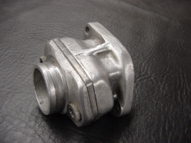

Just get a GEM or DH reed valve, they just bollt on;

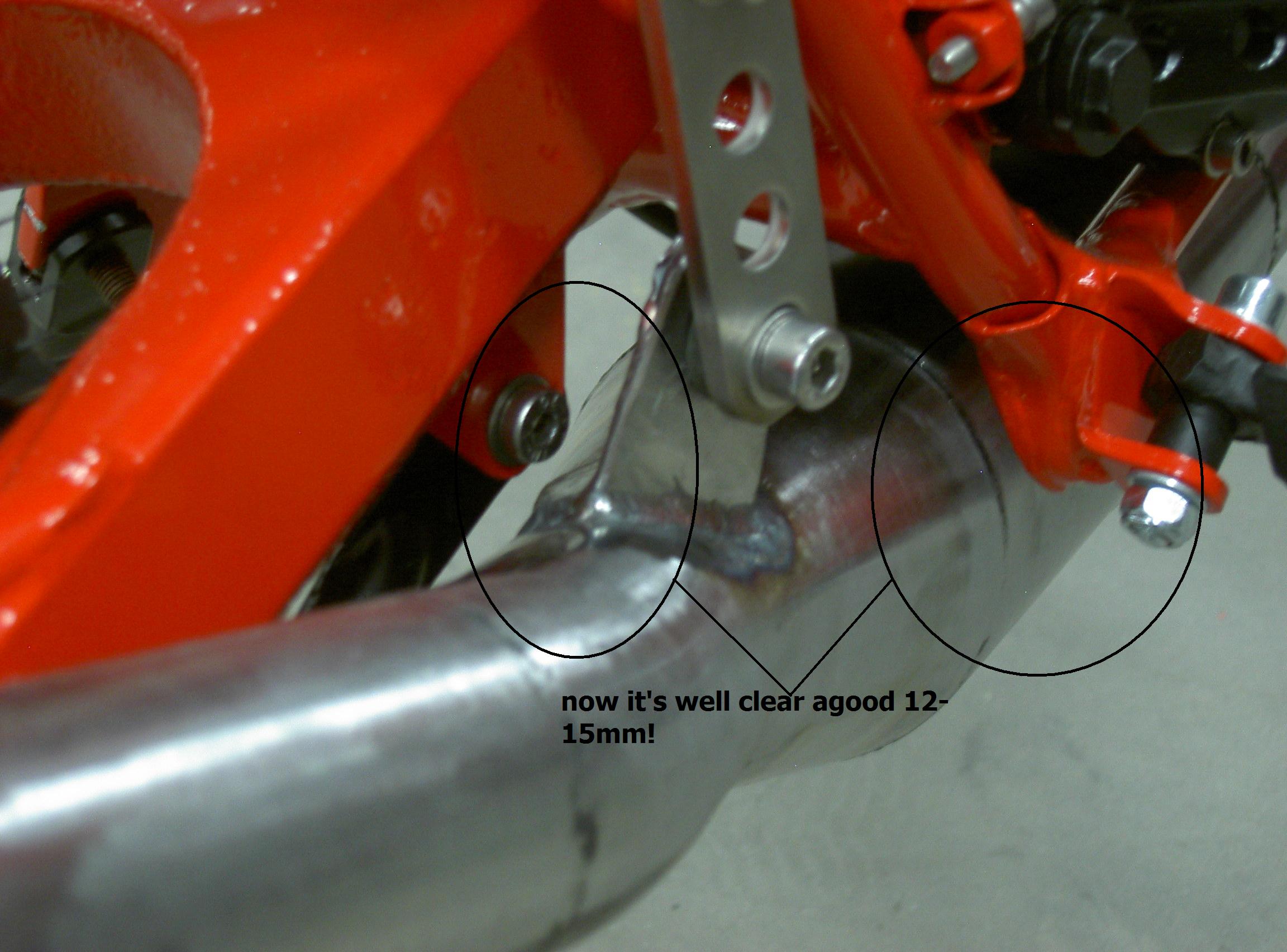

Hello Kenny,
here's a couple of pics!!.............but why do you want the springs anyway? I don't have them on mine....just nip up the bolts with safety nut and leave them a little free play they drop down anyway, the springs tend to get full of crap and scratch the paint off!! but your choice
Cheers Malcolm
