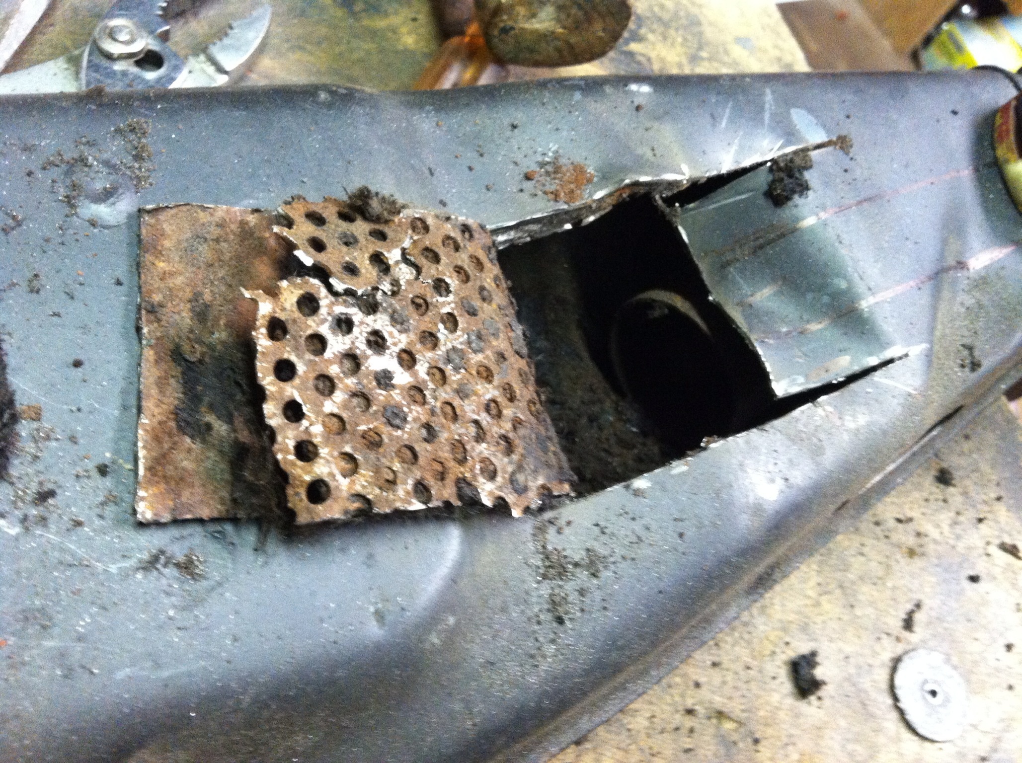

I finally after all other attempts to clear my clogged mt 125 pipe , cut the back open of the pipe . Wow what a design honda had ! I had a mouse nest on top of a lot of carbon in the spark arrester .the pipe has three sections from the front is the chamber area , with a baffle with tube separator . Second area is muffler it has muffler packing held on with heavy screen , separated with a baffle with tube , tube is spark arrester it has a turbine type baffle in it. That is where mine was clogged . It is the tube you see when you remove cover ! I have pics if interested Dave .

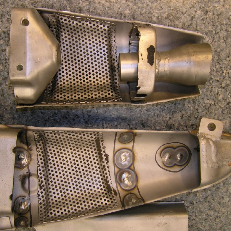

My advice: cut it, gut it, hold on tight. The hollowed-out MT125 pipe on my MR makes huge power everywhere, and should do the same on the MT125 motor.
The top section in the photo is from another pipe, showing what used to be inside.
