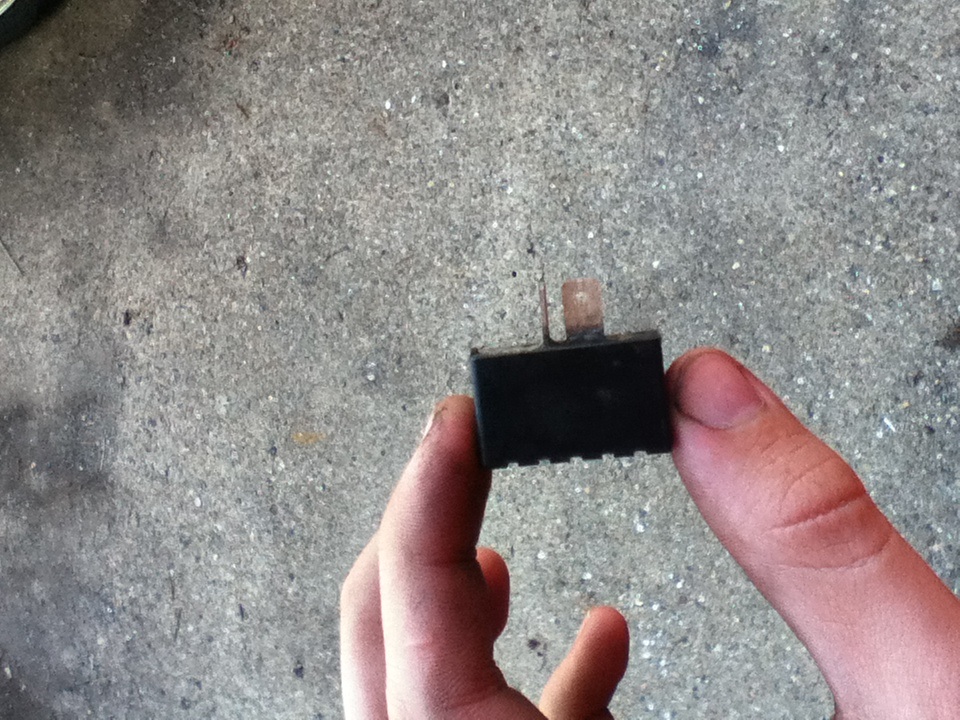

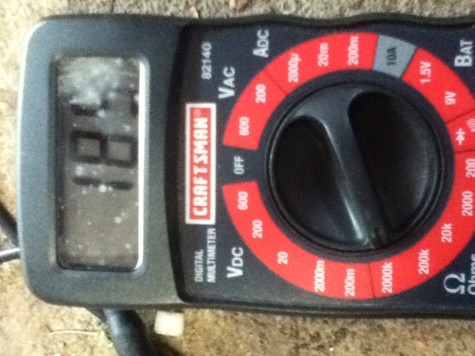

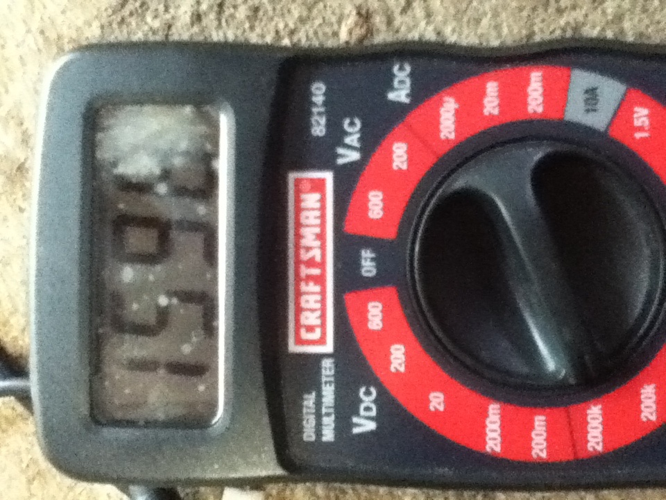

I tested the stator. I'm not very good with a multimeter, so I took some pics. Here are the test results. I did get a reading both ways at 2000k. I also traced the yellow wire back from the stator, and found that it was completely broken. I will be soldering that in the near future.

PostPosted: Fri May 10, 2013 8:34 pm
Joined: Thu Mar 21, 2013 1:38 am
Posts: 55
I dont know if reading it on that high of a scale will affect the readings or not, especially with a digital meter. Just use the 200 Ohm scale and see if you get a different outcome.
Since i can't see how you'r doing the readings, let me re explain. Do not hold the leads on the terminals with your fingers, it will mess up your readings. Place the rectifier on a surface and then put the leads on the terminals. just make sure the leads are the only thing touching the terminals. Then change sides with the leads and check the reading.
You should have a open circuit in one direction and a ohm reading in the other diredtion.

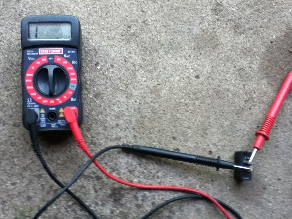

PostPosted: Sat May 11, 2013 12:45 pm
Joined: Mon Jul 02, 2012 5:45 pm
Posts: 37
Location: Delavan Il
I repaired the broken wire, and I am getting 7.4 volts at the battery when running. But I repeated the rectifier test at 200 ohms, and was reading no connection either way.
