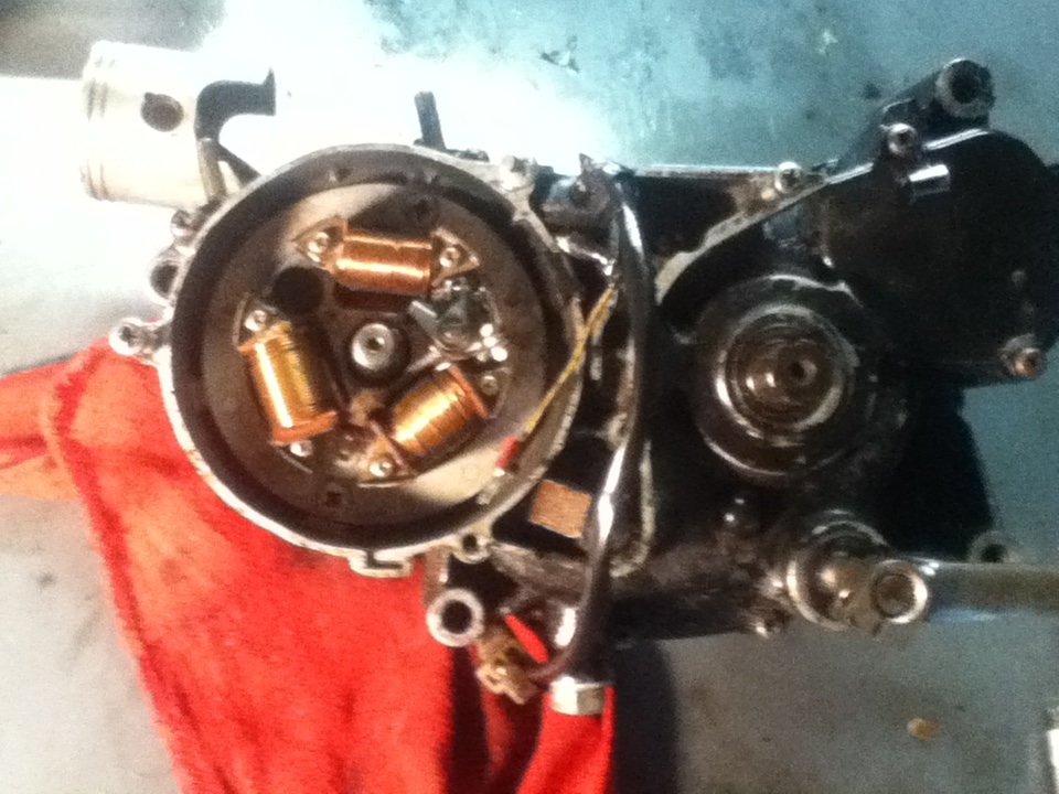

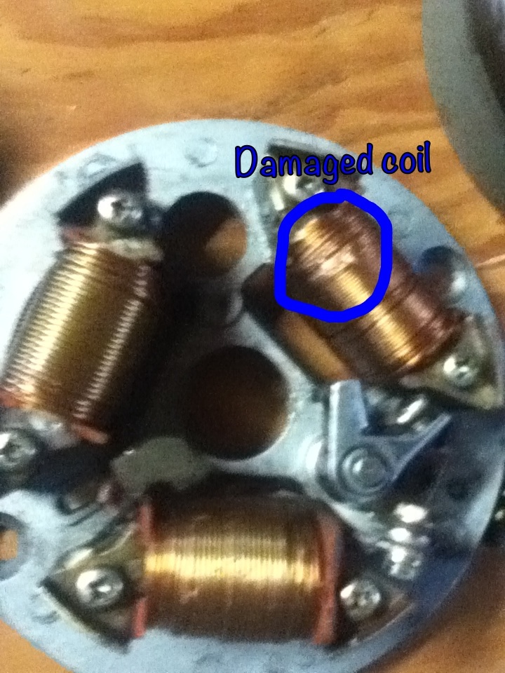

I have a 1976 mt125 with no spark. I looked at the usual suspects (new spark plug, new coil, wiring is good, flywheel is undamaged, gap set at .14 mm) so I looked at the stator and saw A) that there was damage to one of the stator coils, and the ground had been broken. So I probably need a new stator. But before I dropped $100 on a new stator, I wanted to check the stator resistance to make sure it was the problem. I have a honda factory service manual, and I looked cover to cover, and it has no spec for the stator resistance. Does any body have the spec? I called honda and they don't have it either.

Here are some better pics

Here are readings from an MR175 stator, with the MT125 wire color codes. The ignition winding reading should be identical to the MT125, the lighting winding reading is probably slightly higher:
Ignition winding (black/white wire to stator ground) 2.4 ohms (points open)
Lighting winding (white/yellow wire to stator ground) 0.3 ohms (approx.)
If you get similar readings to these, all it really tells you is that the windings aren't broken. In my experience, the only reading that matters is the ignition winding voltage output when the motor is kicked over, which cannot be read accurately with most meters. You can try unplugging the stator cable, setting your meter to AC volts, connecting it between the black/white wire and ground, and kicking the bike over. Hopefully you'll get a reading of some kind, but whether or not that will result in an actual spark across the plug gap is anyone's guess; if you get NO reading, though, the stator ignition winding is bad.

Why not try resoldering that ground? It seems like there's enough wire to work with if you loosened the screw and rotated that solder terminal a bit. Also, it looks to me like the coil was squashed rather than scraped or cut, so the wire insulation may still be intact and the coil is unaffected, or worst case you might have some turns shorted together (not shorted to ground) which may reduce your spark intensity a bit, but probably not a big deal.

I'll try that first, but my soldering skills are not all that great. I also noticed the orange rubber insulators on the sides of the windings are completely hardened and have crumbled most of the way off. But I'll try soldering it today.
