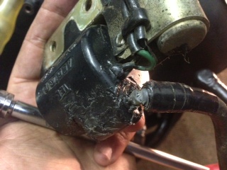

Thank you gentlemen had a good weekend going through the bike and slowly sorting things out. Coil and HT lead look like they have seen better days so going to have to replace soon
Also the boot between the airbox and the carb has more holes than swiss cheese , I am looking on eBay for a new airboot. Anyone still make them new?

The tube is no longer available that I can find. The part number is 17214-358-000, indicating that it was first used on the MT250. So, I doubt there will be any cross platform options. There is a used one on Ebay though.
As to the uni, I was only repeating what the US guy rather forcefully told me. Just forewarning that you may not want to call them looking for part 4026. Contact ebay, the seller's email is eBay Member: dabbernz <dabber_mviy6798ugz@members.ebay.com>. If he doesn't have an auction up for the filter, if you contact him he usually will put one up.
