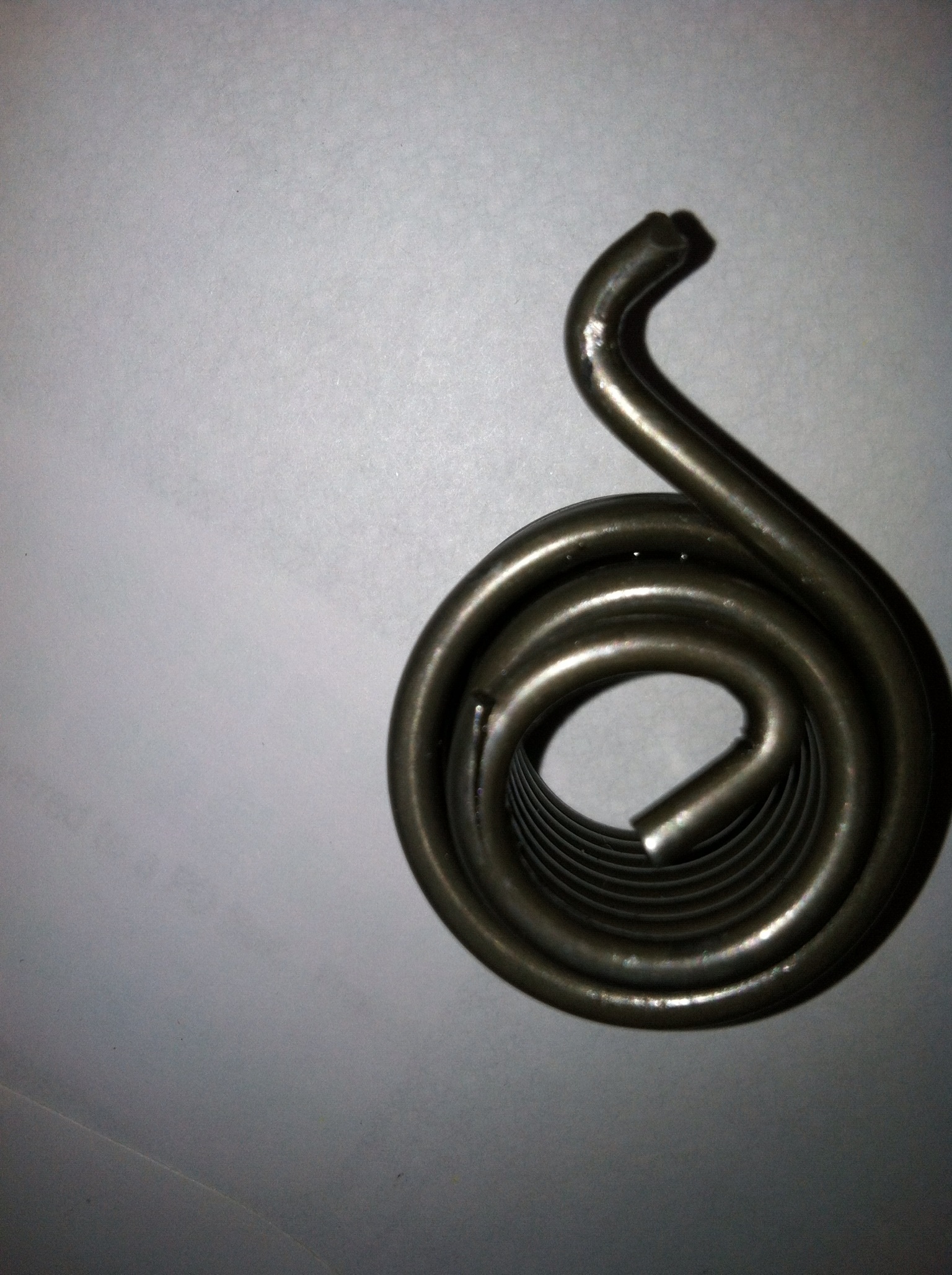

I just started my mt 125 , the return spring I just bought and split cases and installed , broke forth kick just when the bike started !!!!! At least I know the bike runs good , but does anyone make or remake a kick starter return spring for th early elsinore 125's ....... If not I will look into having them made , Dave .

Was this a used, NOS, or repro spring? I believe 'hollyequip' on eBay was selling reproductions about 6 months ago, maybe he still has some. The 28261-360-000 originals are very hard to find, which sucks because they're a high-failure item.

It was used ! It was the second one I bought , the first was cracked , seller did not mention or acknowledge it !!! Ill try holly , thanks
