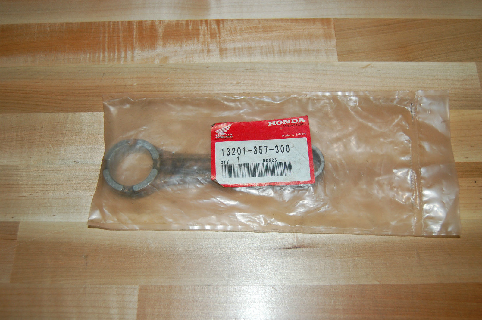

anyone know what the measurements are for this rod?

hopefully I bought the correct rod?? :?

i would think it would work fine in a 73 or 74 CR250.the 75-76 CR250 and MR250 rod is about 2 or 3 millimeters too long so that one itself would not work.
i have used a 73 CR250 top end on a 74 MT250 lower end and it works fine.

hey thanks for the reply Dave! I know the description says it's for an FL250 and MT250 but it the part number is correct for 73-74 CR250M... hopefully it's the right rod and not the wrong rod packaged in the right wrapper!! :lol:

rod arrived, has an S22 on one side of it... measuring with a tape it's approx 120mm center to center
