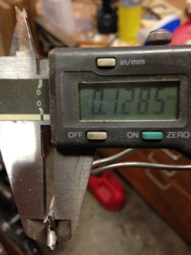

Looks like I have the right rod and spacer kit based on that thread. I measured the squish again and came up with this.
I think it is in spec although maybe a little more than needed. Are you running the oil injector on yours? Have you ever heard of the VME Bonehead ride? It's a dual sport vintage motorcycle ride. Anyway its next month if you have a runner I recommend it, it's an absolute blast.

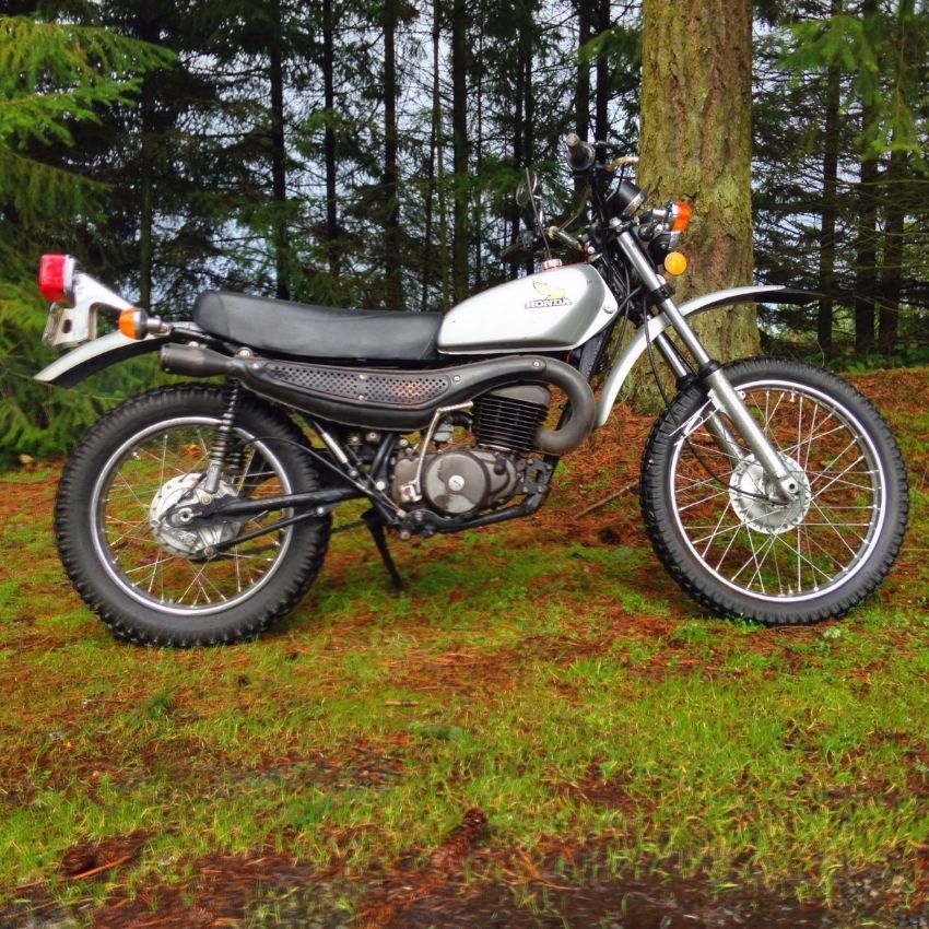

Here's a pic of my bike too
