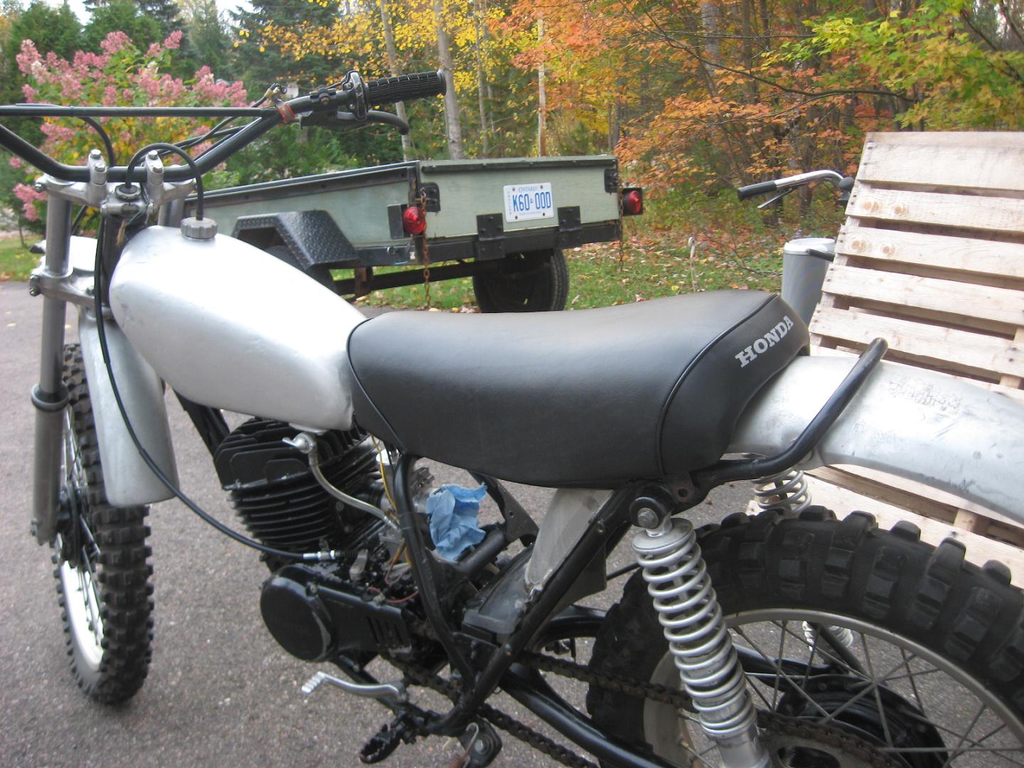

Just registered as I just picked up my first elsinore!! The motor and frame are 30 no's off so that seems like a bonus, rolls nice, kicks nice, carb is free
pipe looks flat but just an illusion, ended up removin it for a looksee and luckily no carnage in the cyl!!
pretty much as found condition and not run in 16yrs... stored indoors for 25! Looks like ol bolly found himself a new project!!! :-D

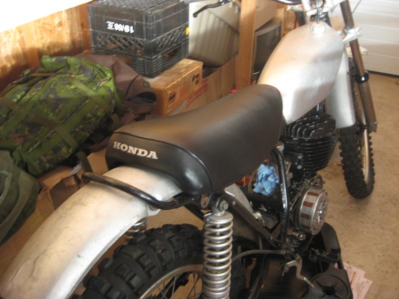

new seat cover installed! not too bad lookin!!

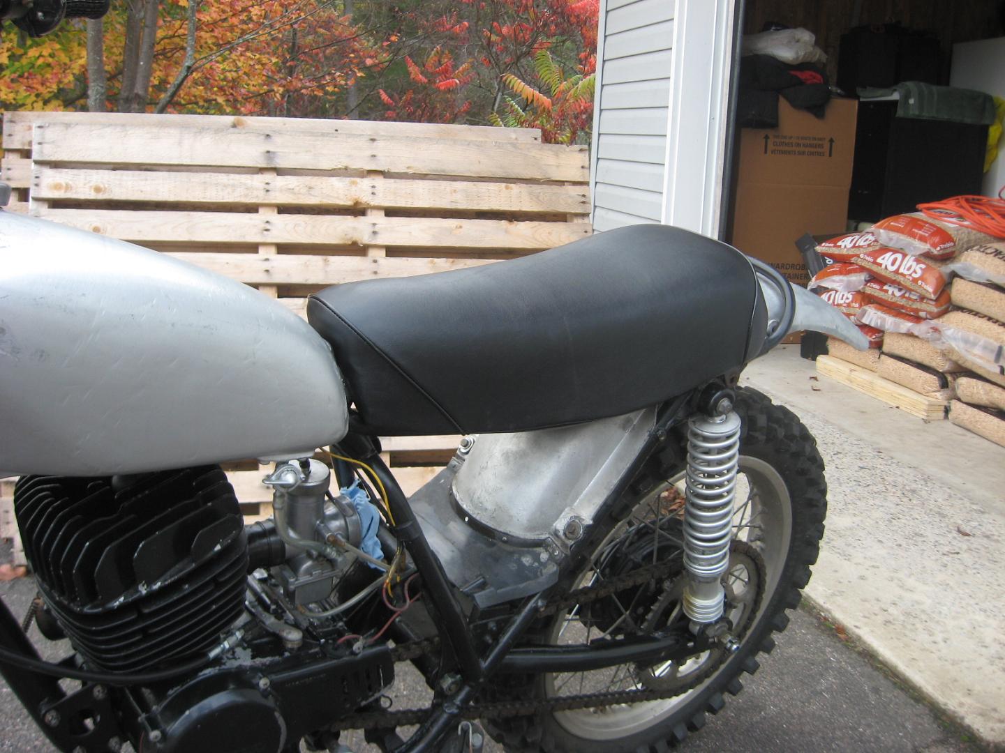

couple better pics! 8)

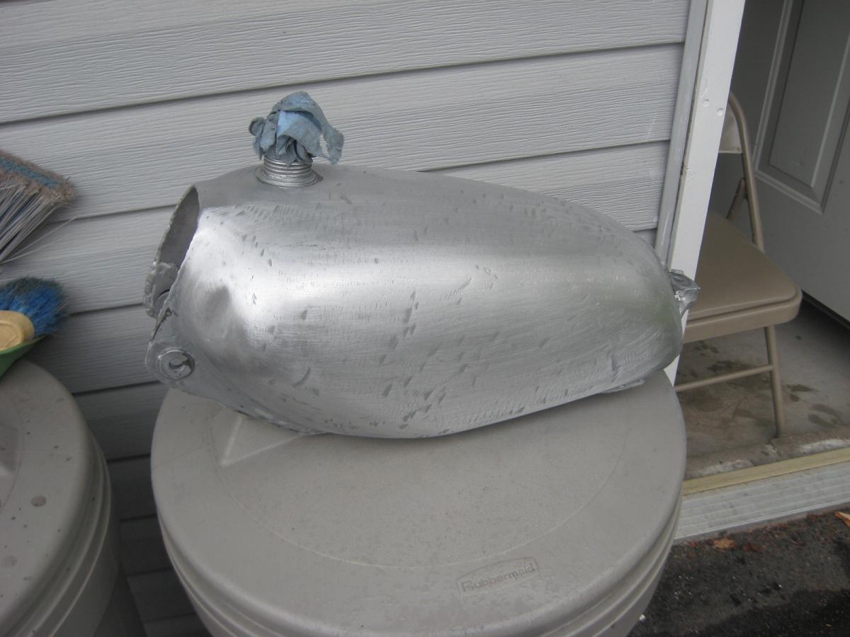

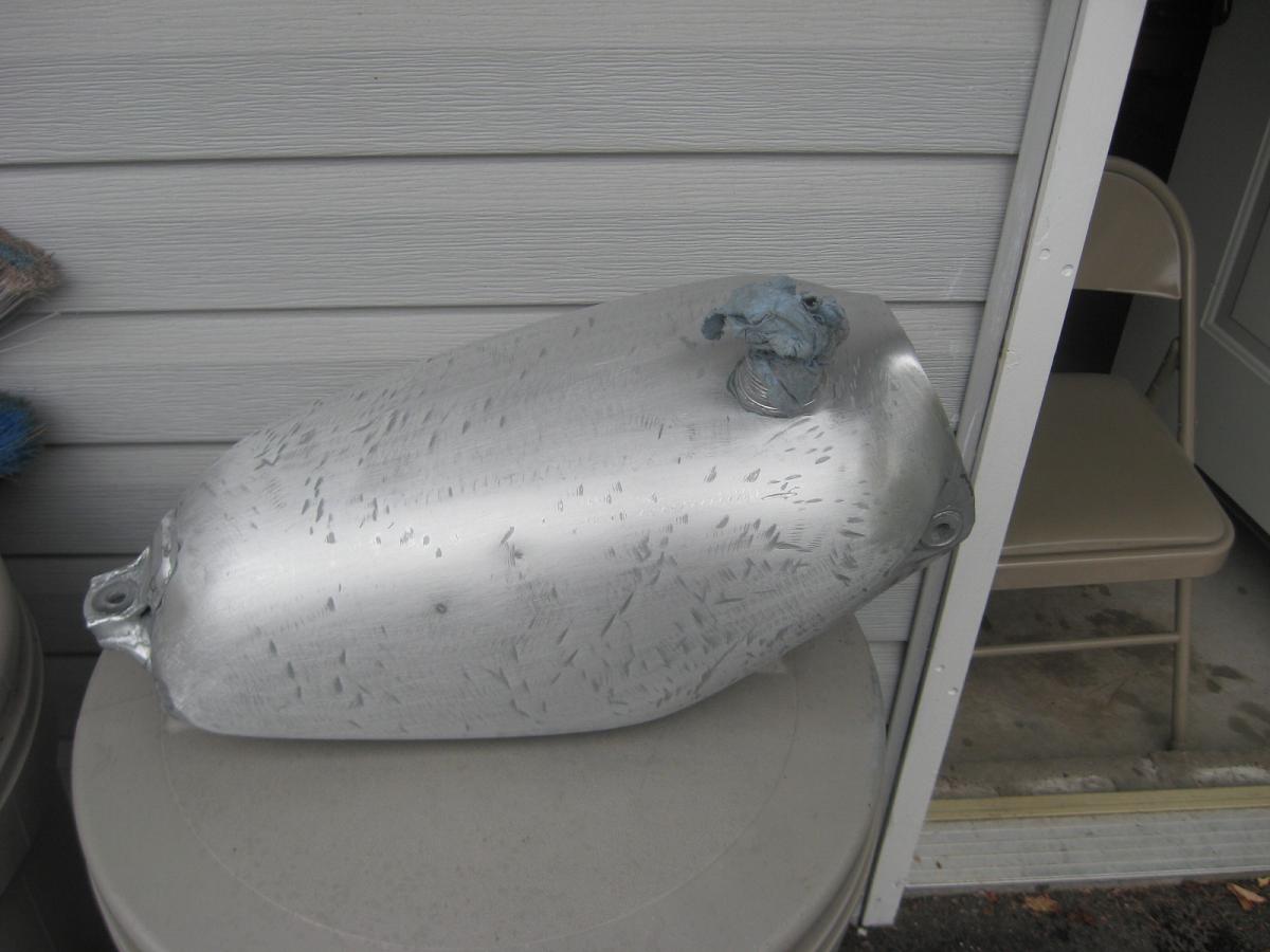

spent an hour or so with the sandpaper, what a drag!!! decided to see what my tank looks like under that damn silver paint, found remnants of the green anyways she's got a few battle scars that need to be addressed and looks like someone even used a damn grinder at one time! :(
.... seen a youtube video of aluminum brazing and think that just might be the ticket for me!

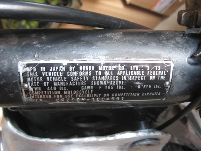

so I'm doin a little lookin around at serial numbers and whatever anyways I'm back at the 73/74 debate.... here's a pic of my vin plate looks like mine is March 1973? :D
On a more serious note, I havent found a specific 1974 parts manual, I did use the K0 and M1 and the 76 online links and found 3 likey part numbers for the 73/74 oem connecting rod(dunno if I need one yet my motor's still together);
13201-357-300, 13201-KA4-700, 13201-38-300... anyone tell me which is correct for 73/74? Is they're a replacement rod other than the long rod kit on ebay? anyone know manufacturers or numbers of suitable replacements?
PostPosted: Tue Oct 15, 2013 8:54 pm
From my KO (73-74) parts manual:
Replacement connecting rod: 13201-357-300
Replacement side plates: 13202-357-300
Big end bearing: 91011--VMO-OC8
Crank pin: 13381-357-330
The side plates and big end bearing are still available from Honda.
The rest is listed as NLA. I found a replacement rod on EBay a
while back, maybe another one will show up. The good news is
the crankshafts are rebuildable and you may only need a new big
end bearing and the pin resized/replaced. A number of shops can
do that work for you.
