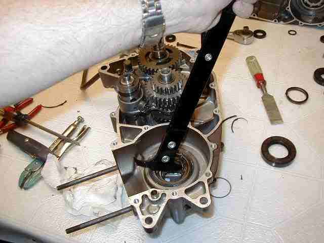

Yes, likely the clutch side seal and or the center crankcase gasket. Im pretty sure the clutch side seal has to be removed from the inside.

The only way to access the Right Side seal on the 74 MT-250

Jake is right I looked it up also and is the same for this vintage of CR,MR, or MT. It's a good example of Murphys Law

Hey, that doesn't look too difficult.
But, what are all those round things with teeth on 'em?!
Wish me luck.
