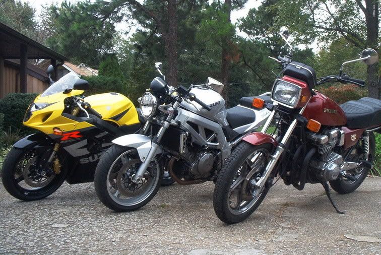

If any are interested, here is my other vintage project, a 1980 Suzuki GS750T. I belong to another vintage STREETBIKE forum called gsresources.com. Another great bunch of folks..
pic:
