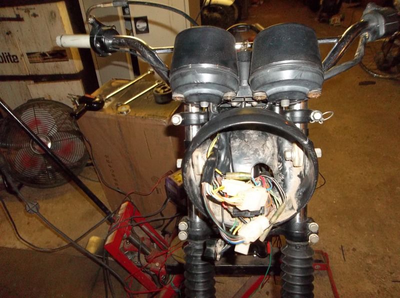

i hooked up a battery and did the switch test.
works great!

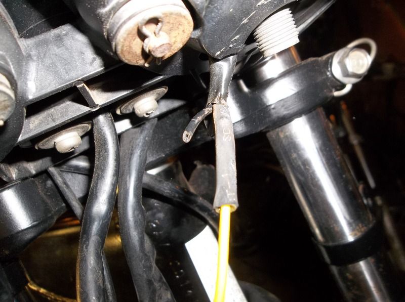

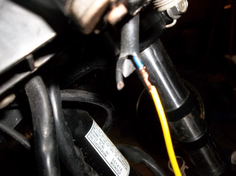

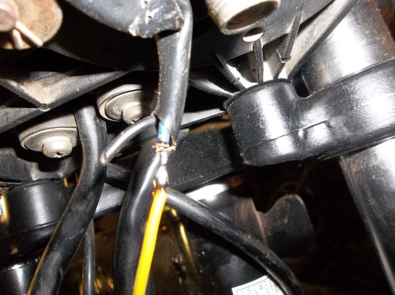

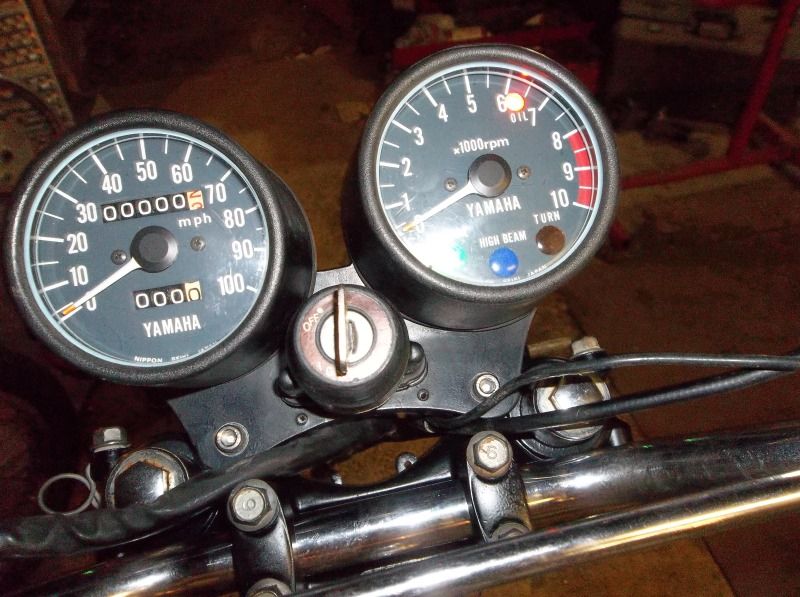

the wires to the speedometer were cut off sometime before i got the unit.i am repairing the damage by soldering in a new section.
making a mechanical connection.
then soldering it.
then apply the heat shrink tubing.
then plugged it in to the harness.

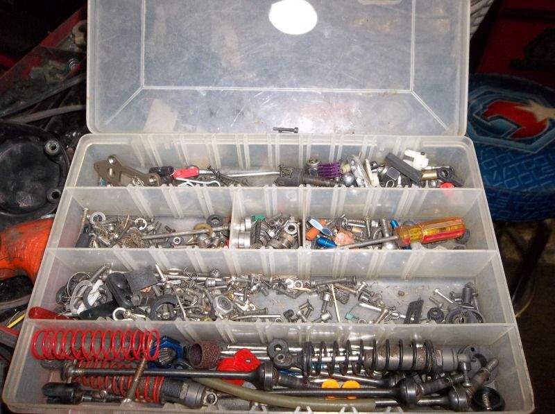

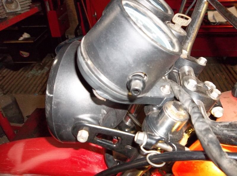

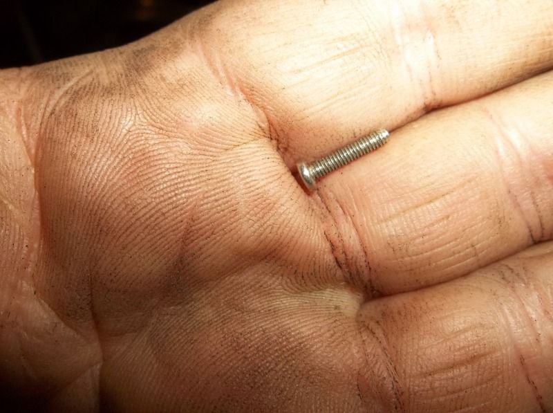

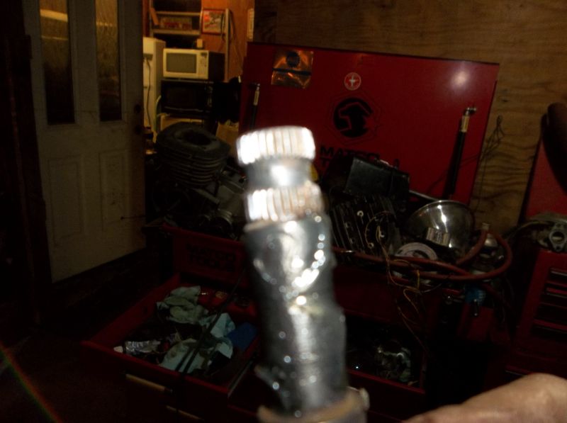

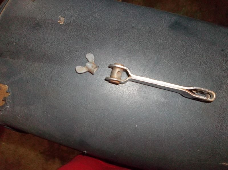

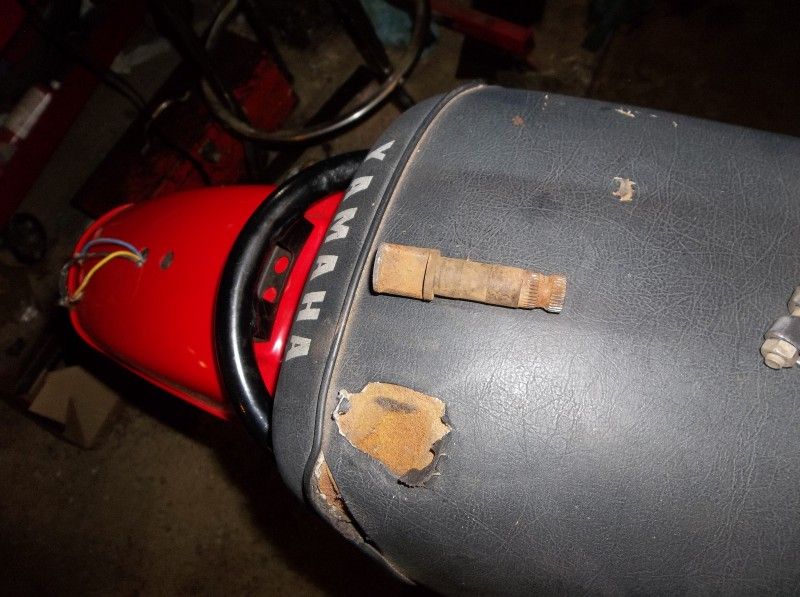

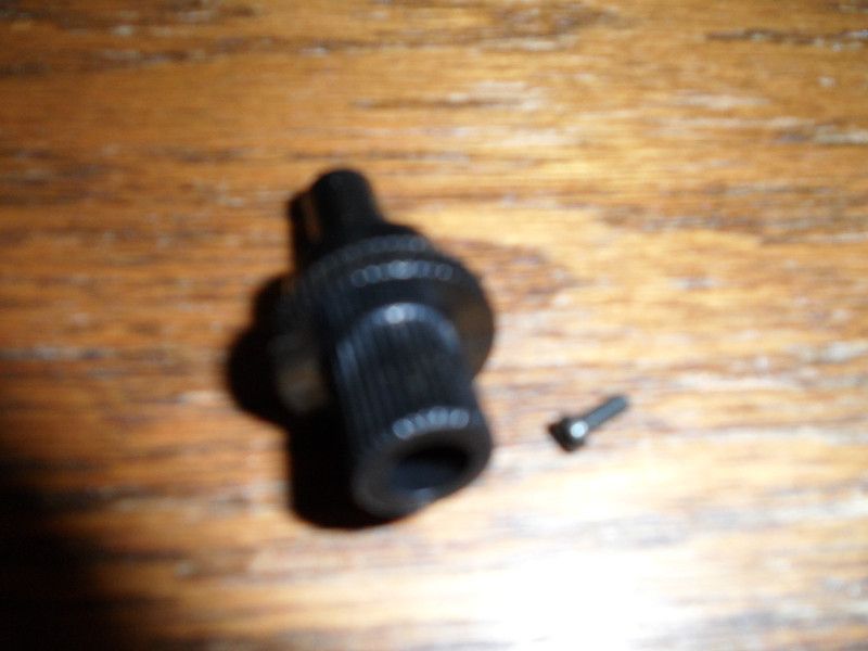

i located a NOS speedo trip knob because the speedo i have has the knob missing.the knob i got had no screw though and this is a pic of the parts i needed.
i dug into some small metric screws until i found one that would work.

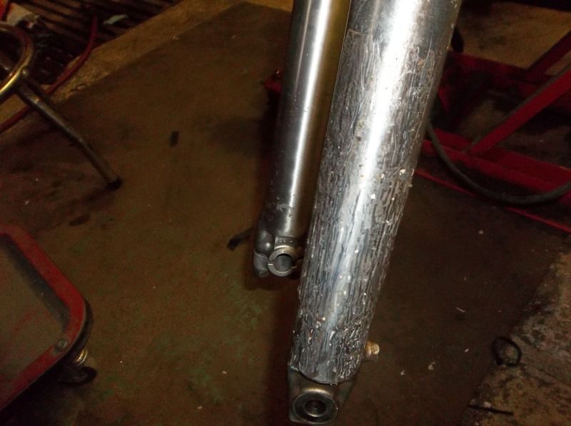

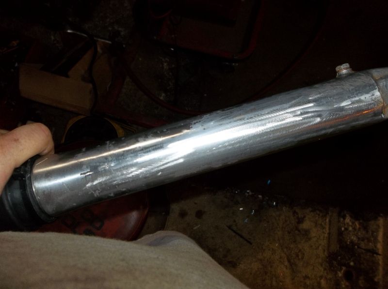

i decided to peel off the stickers on the forks,quite a layer of stickers was found and evidence this bike was registered in 1977 in Oklahoma.
it says 1978 and is good until the expiration date in 1978 but was good for the 1977 year.
i had to buff it off on a buffing wheel and it looked better but not perfect,this is going to be a rider and it is good enough for that.

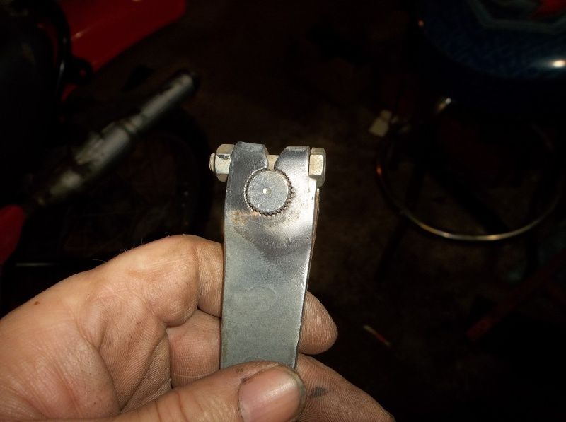

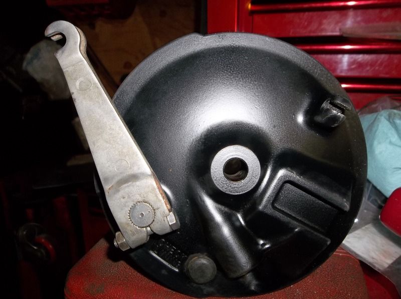

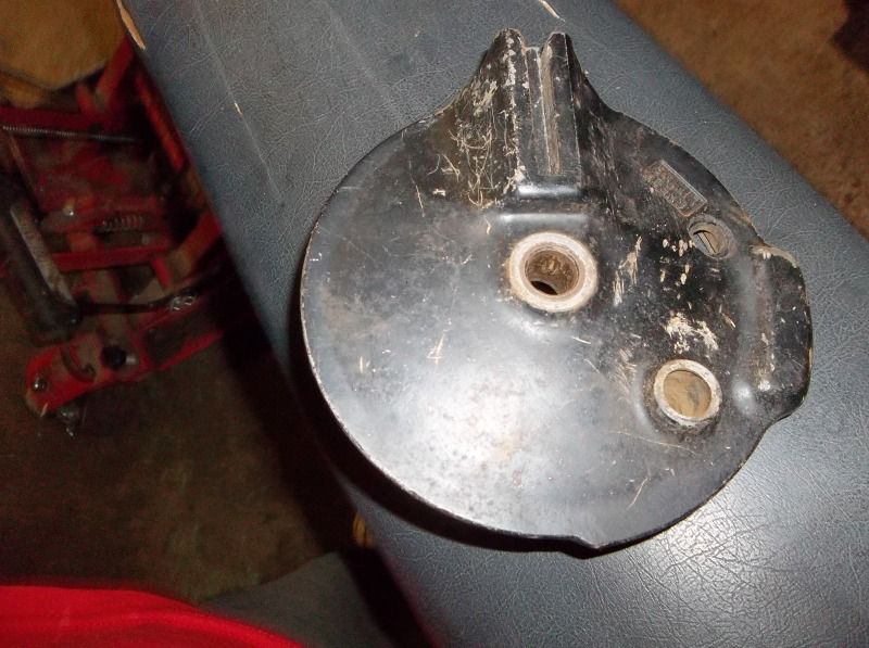

now to work on the brake panels.first the rear brake.

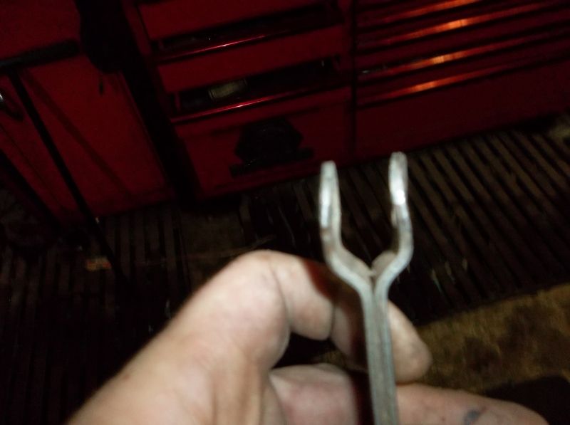

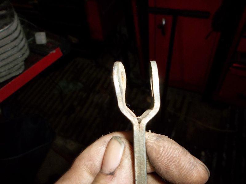

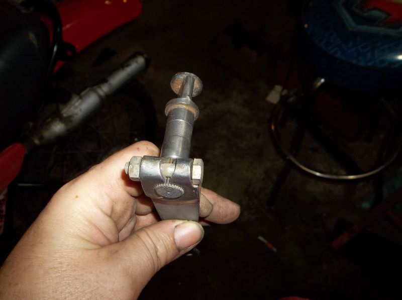

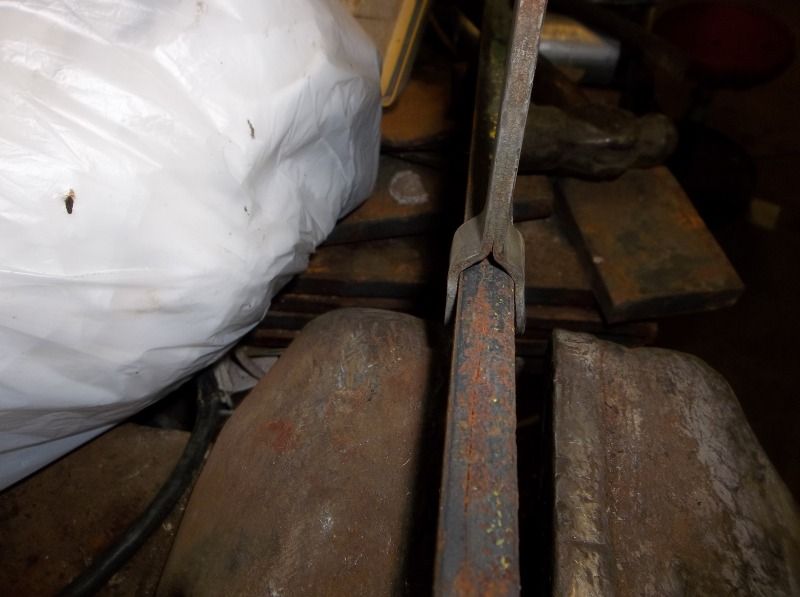

this lever as you can see is quite bent up.
i found a piece of flat bar stock the same width as the opening and used that to straighten the bent parts.
the finished product.
now to work on this very neglected part.
PostPosted: Thu Sep 27, 2012 1:53 pm
after cleaning off some rust.
this had a incorrect 1/4 bolt and nut on it but i had a correct 6 mm bolt and nut for it.i also trial fitted it on the refurbished lever.

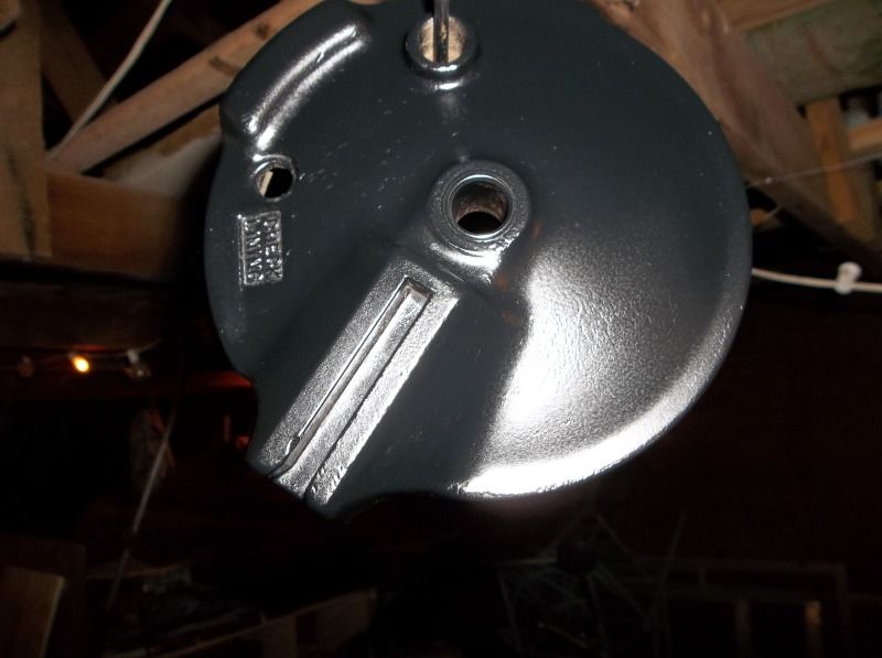

now to repaint this.
i stripped off the old paint.

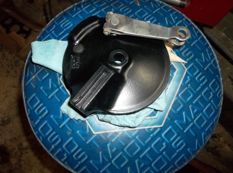

then i gave it a coat of fresh satin black paint.
after the paint dried it was ready for reassembly.
PostPosted: Thu Sep 27, 2012 1:59 pm
i gave the actuating rod a coat of grease.
the finished part ready to put on.

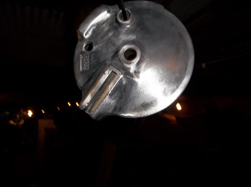

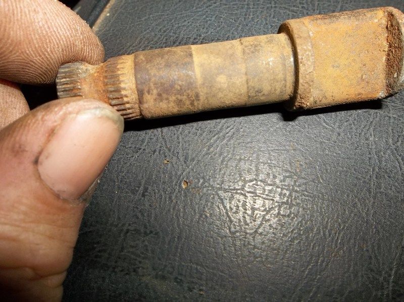

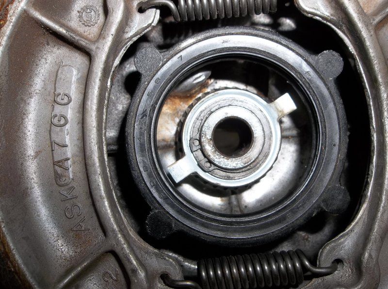

the same process was done on the front brake panel.first to disassemble and clean for painting.
when i reassembled the panel the speedo drive clutch was destroyed because the unit was froze up.i replaced that with a new part after freeing it up and cleaning the associated parts.
ready to go.

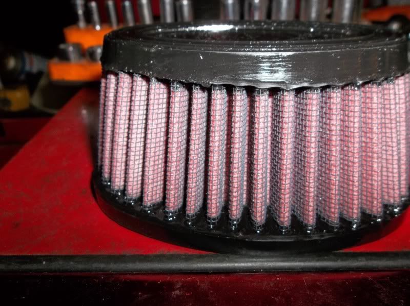

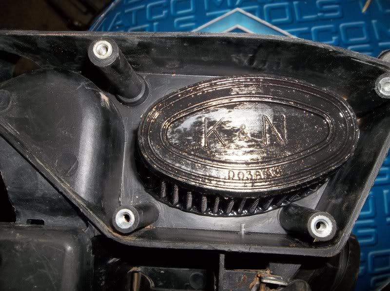

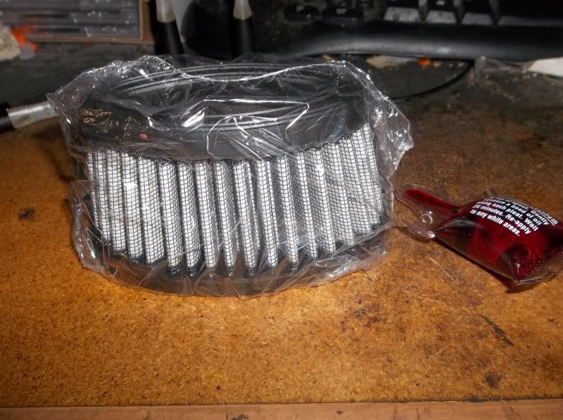

as the time for the initial start up got near i got a new K&N air filter for it.
to oil the filter i used the spray oil K&N makes to coat the filter with.
ready to install.

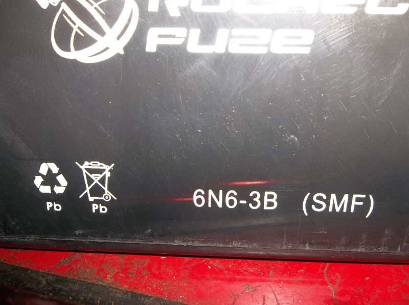

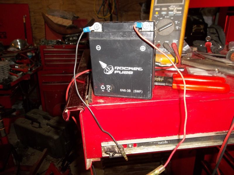

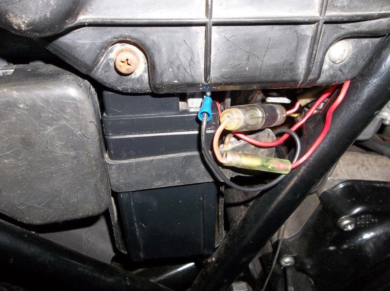

i also got a new SLA type battery to put in.
the battery installed and ready to go.

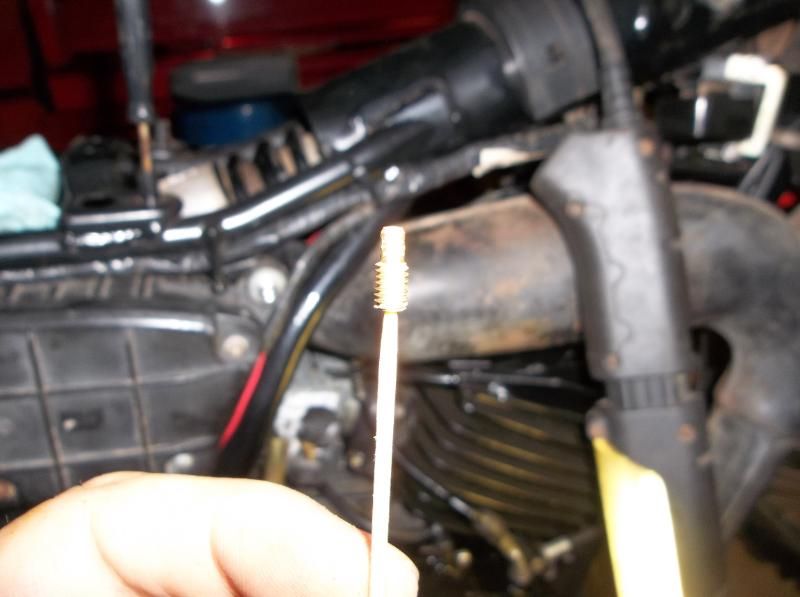

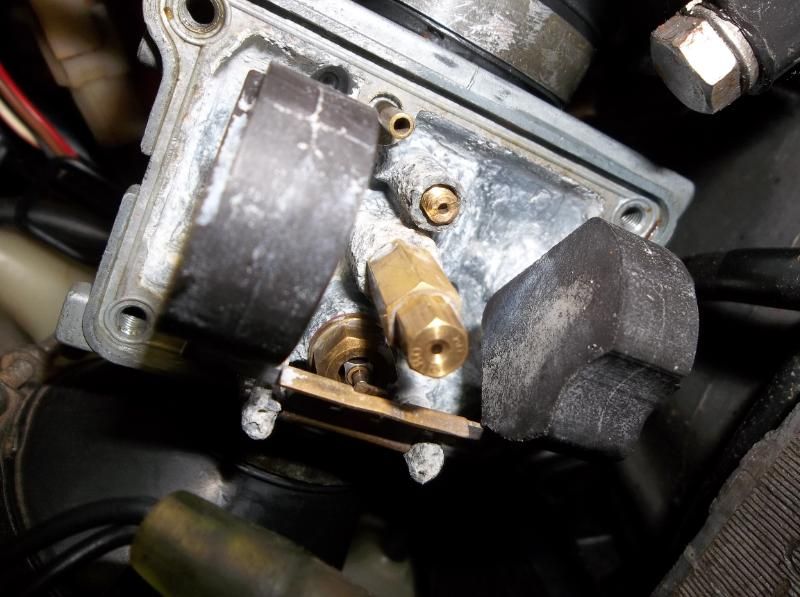

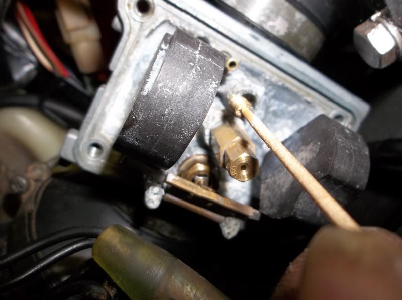

i ran it with the stock 22.5 pilot jet and all i had was main jets and i already replaced the stock 140 main with a 180 main jet.
so i ordered a pilot jet for a Yamaha Banshee which is a 25 pilot jet from the same supplier i ordered some other small parts from.
here i am changing the 22.5 pilot to a 25 pilot jet,it is still a touch lean so next month i am ordering a 27.5 and a 30 pilot jet.
how to get the little guy out with the carb on the bike? with a wooden tooth pick.

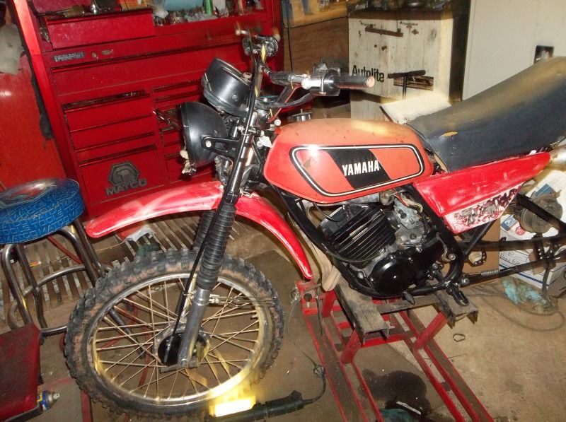

PostPosted: Thu Sep 27, 2012 2:37 pm

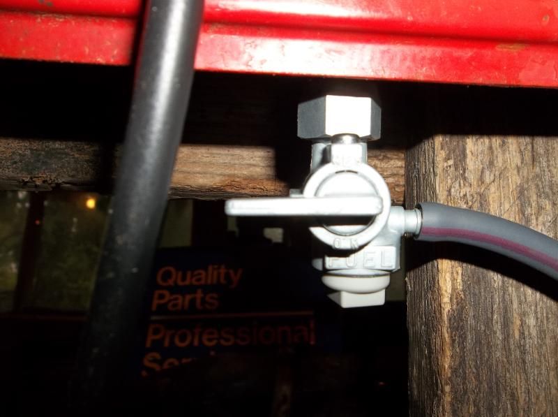

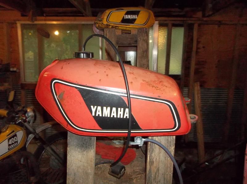

i got another tank for this bike and i am going to use it as a model for decal placement as i plan to either repaint the yellow tank or get one that has fewer dents to fix.
for now i am using it,i fitted it with a new petcock and new vent and fuel hoses.
the petcock is different than the original but other than that it fits and works great.

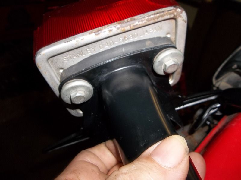

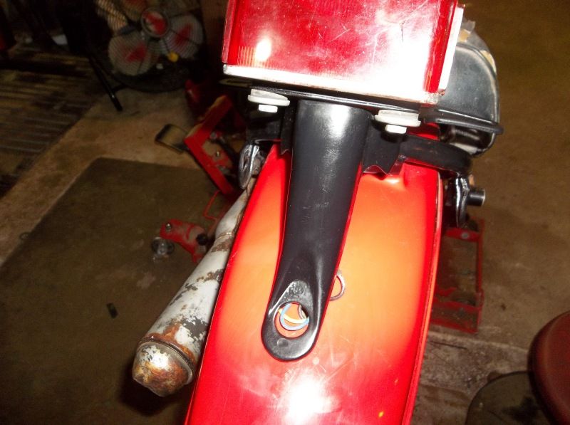

this one is the brake/tail light operation.i need to repaint the tail light bracket and get the mounting hardware as i do not have that yet.

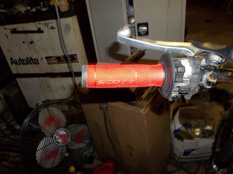

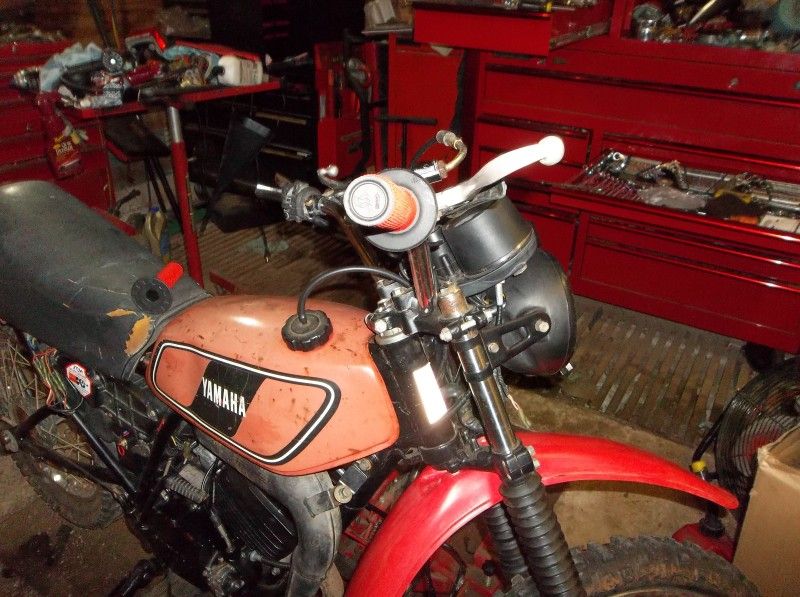

the wheel guy got me fixed up with some beautifully done rim assemblies.it may be a while before i can get them though.

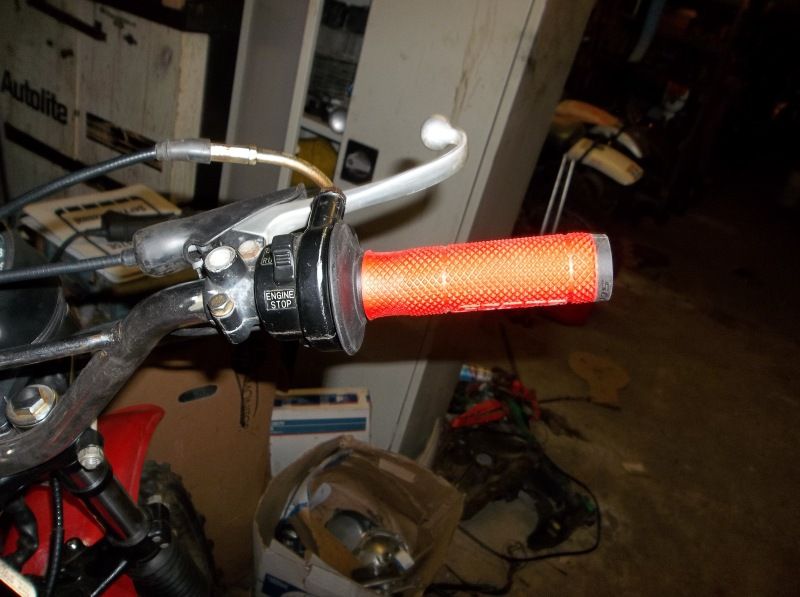

i also got the new grips today and put them on.
i got the mounting hardware for the tail light coming and it should be here this weekend,i painted the bracket but i had not done much with the light other than getting it to work.

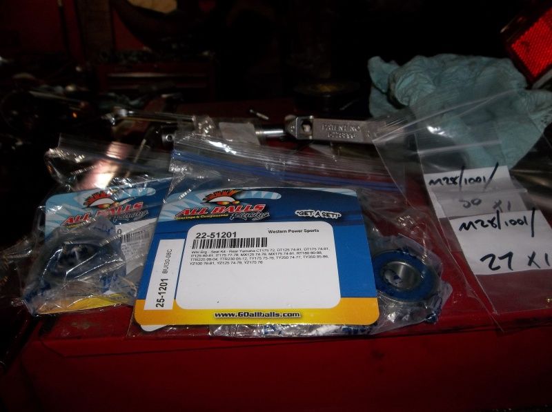

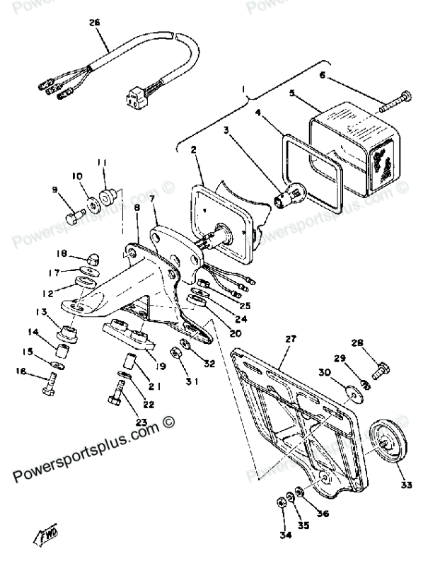

i got the jets,wheel bearings and the tail light mounting parts in this morning.
i did not get parts 12,14,17 and 18 but i know a store has part 12 in stock as it is no longer available but the rest is still available from Yamaha however.
here is a short video of the cold engine being started and a lighting test.click the image to play the video.i rigged up the tail light mounting due to the missing pieces for now.
