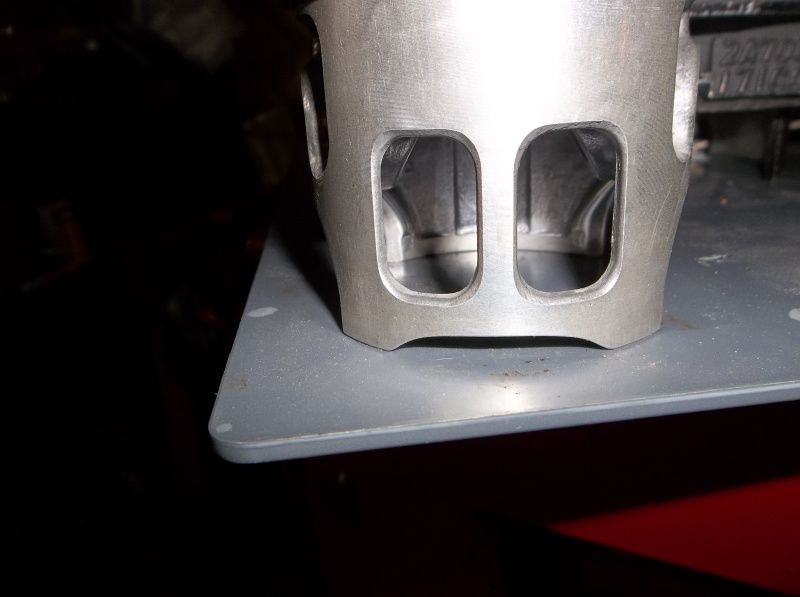

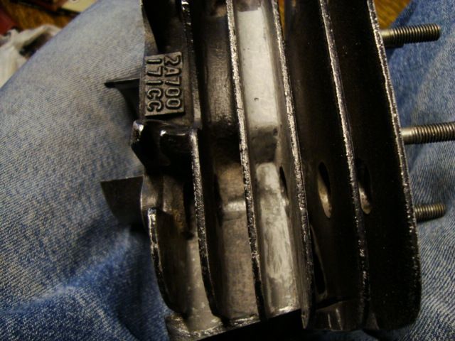

Vforce 3 is a V382A for a 93-06 YZ 85.

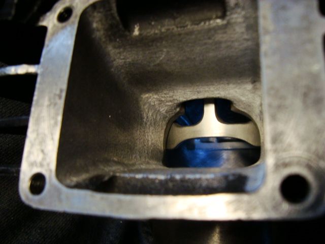

the cylinder on the intake side needs to be opened up on the intake side a bunch and then epoxied between the fins around the intake area for strength.
piston is a YT175 piston and yes it fits the 1978 DT175.

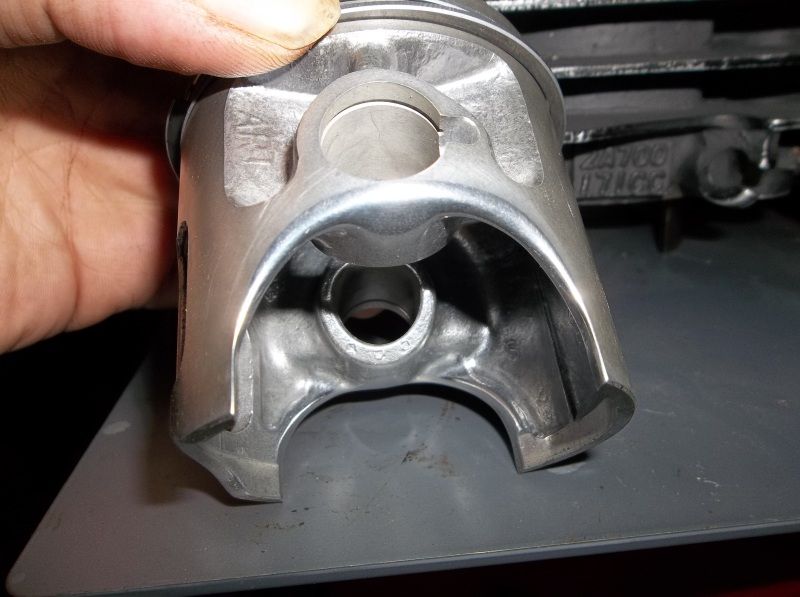

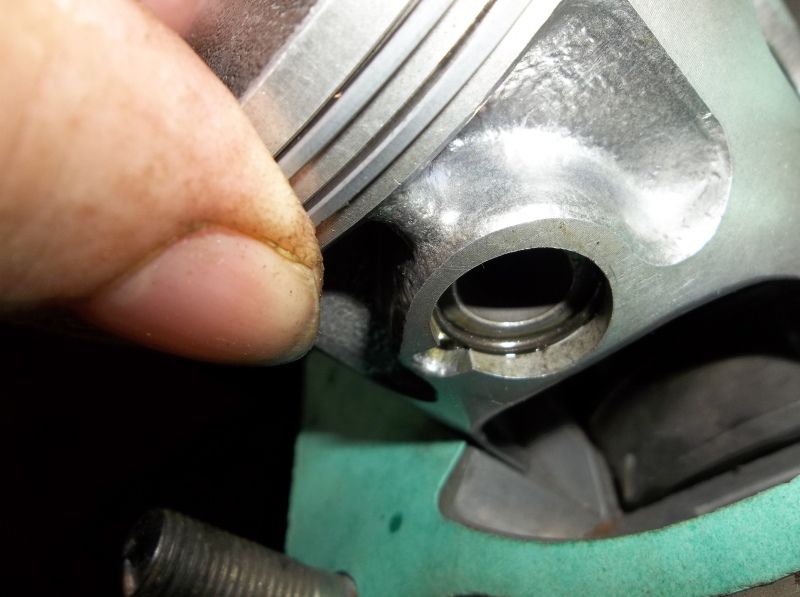

some engine stuff i may not had posted,this is a YT175 piston,it was chosen because it is the most like the 1976 YZ175 piston.
the sides were sanded off to prevent stress cracks from forming.
i installed the heavy duty wrist pin clips to prevent them from popping out with the high rpm this engine will be capable of.

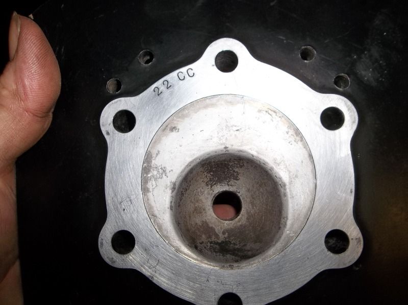

using a Yambits complete gasket set the head was milled to a 22 cc chamber volume.
i am using a NGK B9EV spark plug in it.

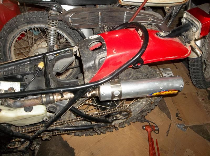

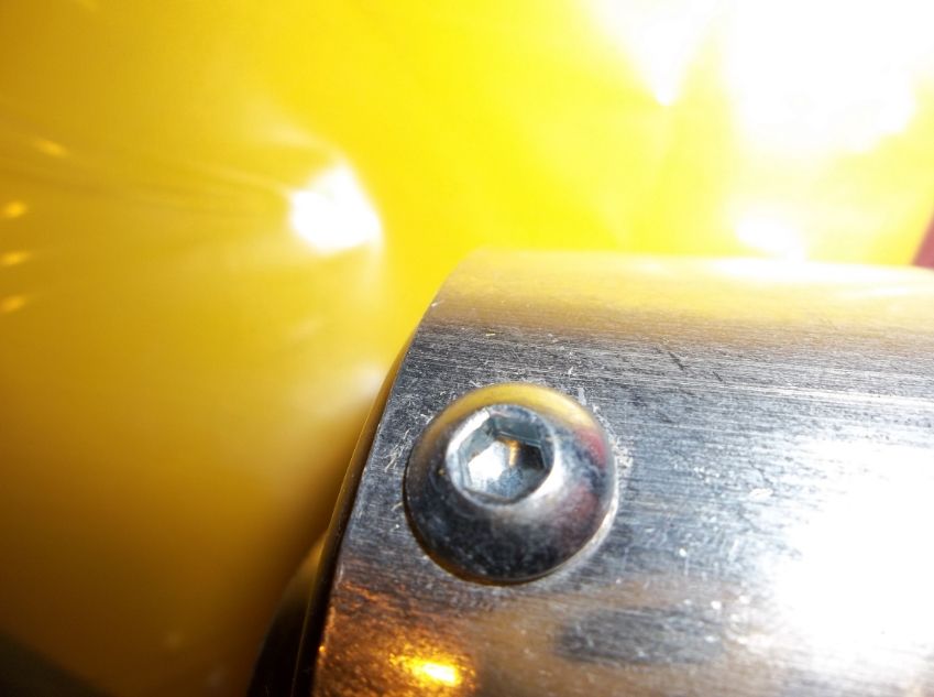

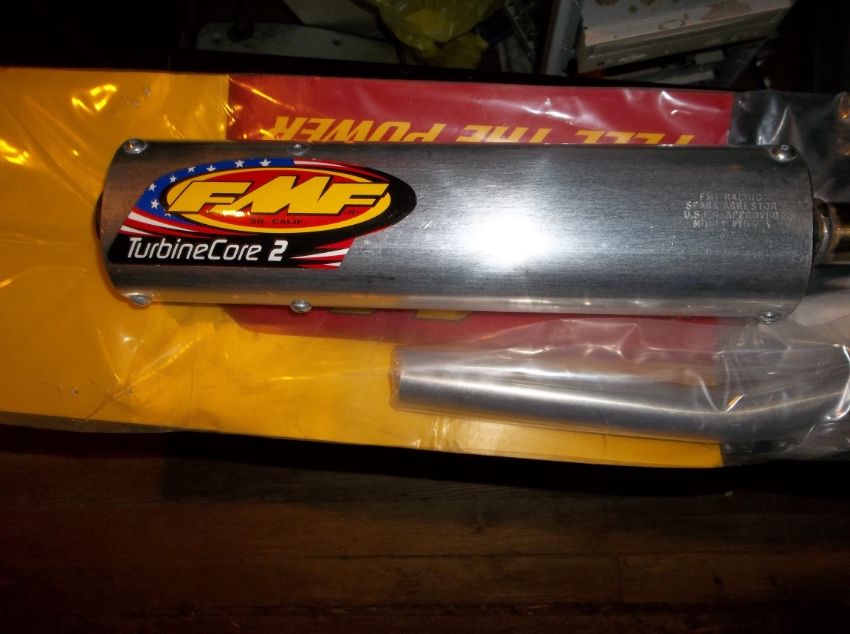

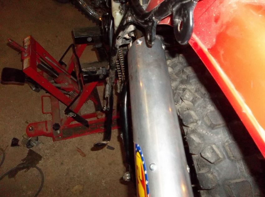

this is the FMF Turbine core 2 silencer i am going to use on this machine,this one for the 175 cc engine is in the 1 1/8" stinger size.
it has a built in spark arrestor and can be taken apart and cleaned. remove these Allen head screws to remove the end cap for cleaning and repacking.
for right now i have it mocked up on the bike,it has some clearance issues but not impossible ones.
what does it sound like? not too loud and pretty mellow.i have some carb jetting to do but this will commence when i get the bike ride able again.

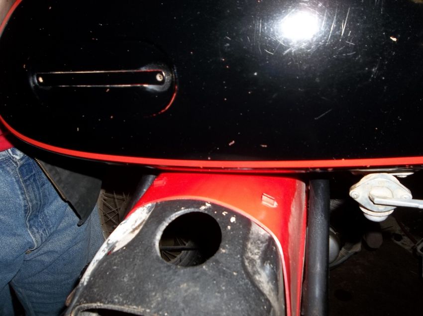

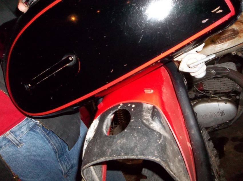

i read on a site,RS Paint that the pinstripe on a 1971 RT1B is Sunshine Red,the same color this 1978 DT175 is.
i do need to get a tank repainted and i have a extra tank to send out and have it repainted.
here is a fuel tank from a forthcoming 1971 RT1B Enduro compared with the NOS rear fender on this DT175.
it is about dead on!!!! :D

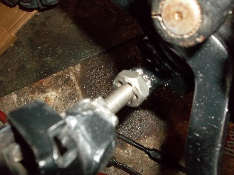

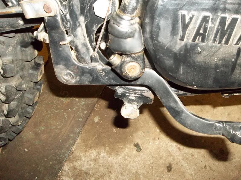

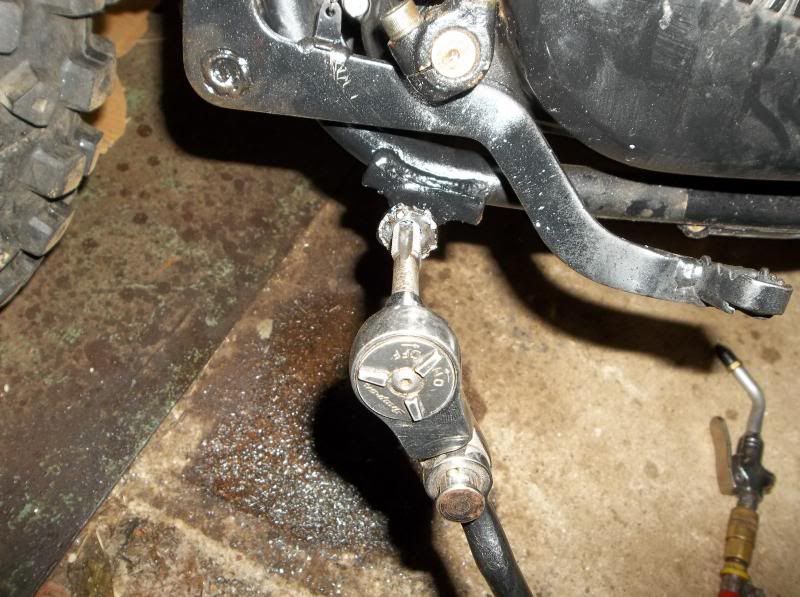

i never went over this part so here is how i repaired the broken footpeg plus the installation of the FMF silencer and TTO temp gague.

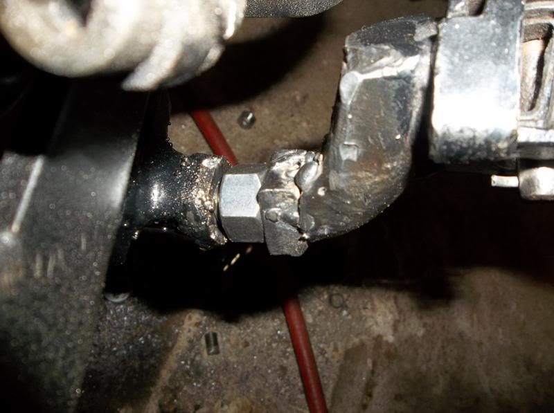

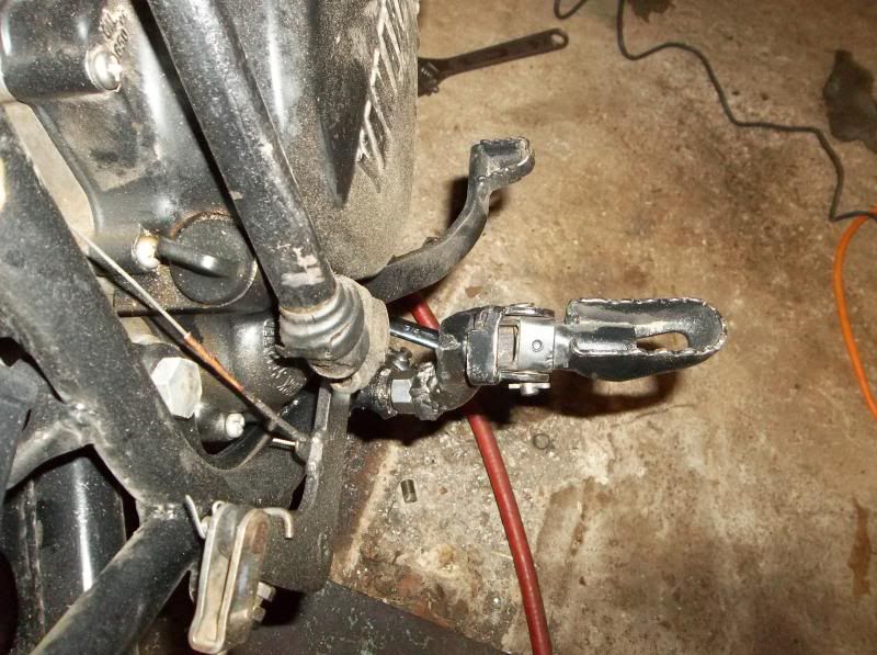

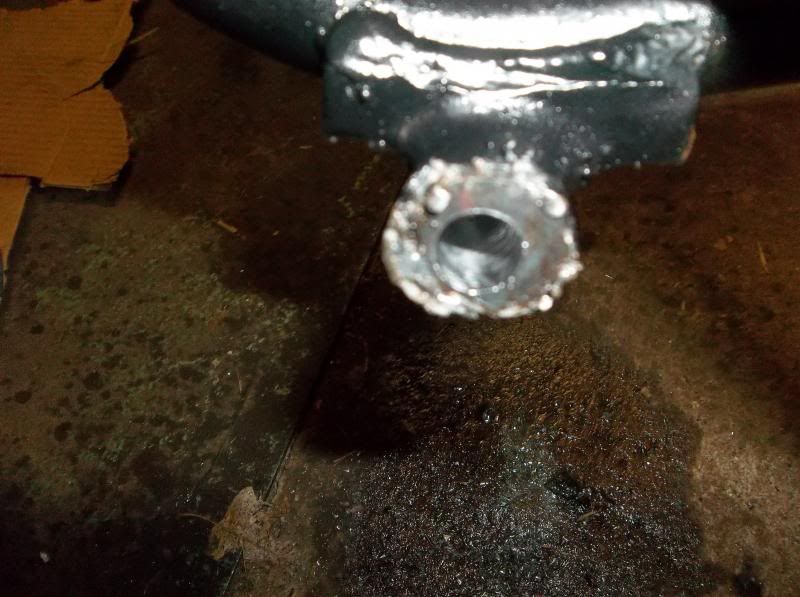

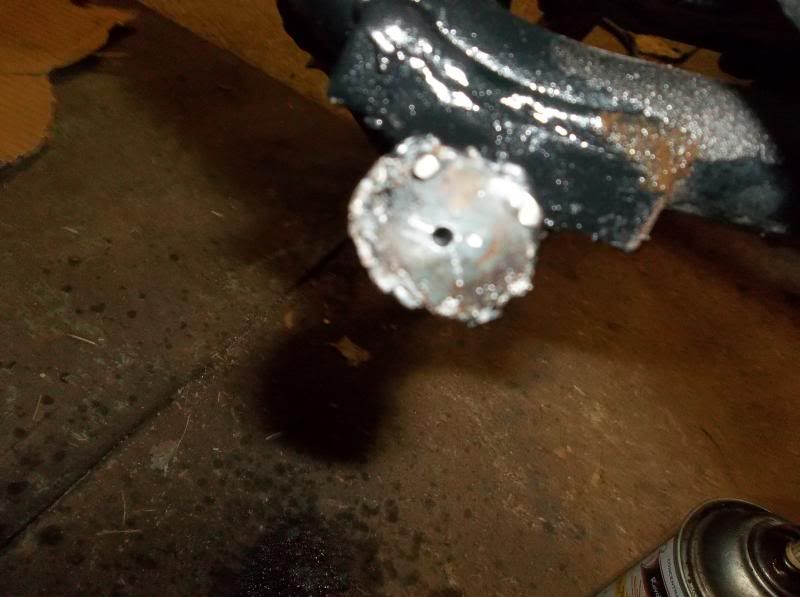

first the repair of the foot peg.this bike came to me with the foot peg sheared off.i did have it welded but welding a mild steel part to a cast iron part has always been risky.
one day i put the bike on a jack and the foot peg soon came off.
first i drilled a 1/8" pilot hole in the cast foot peg bracket.
from there i worked up to a 27/64th bit.
i tapped it for a 1/2 13 stud i have.
i welded a appropriate size nut on the peg assembly.then i used the assembly to determine on how short to make the stud,i threaded on a 1/2 13 die to chase the threads once the stud was shortened.
once the stud was sized i assembled it,just needs paint at this stage.

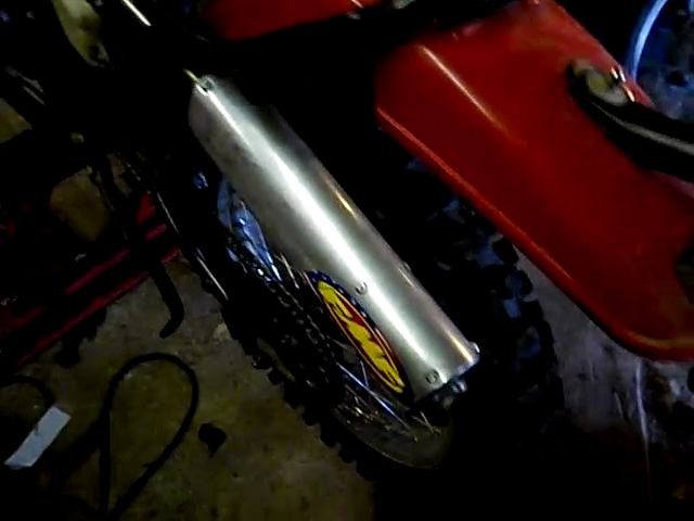

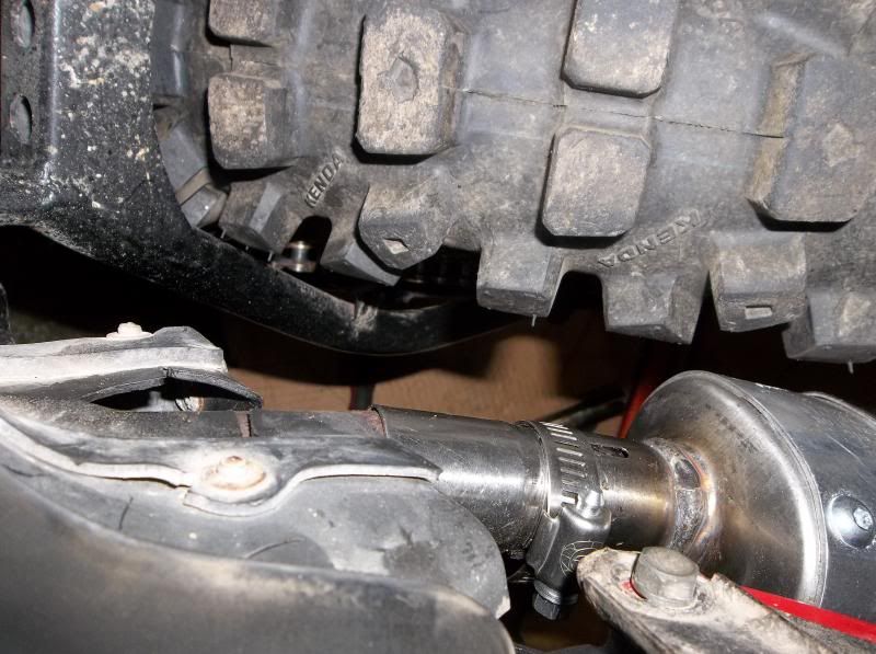

then i set about mounting the silencer,it is a tight fit back there but it works.
