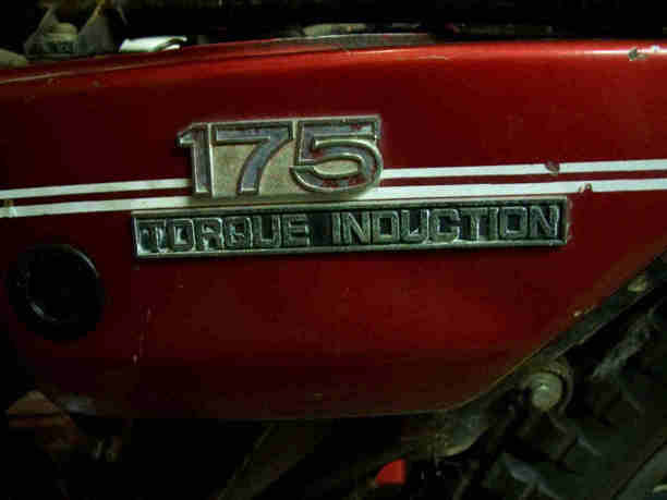

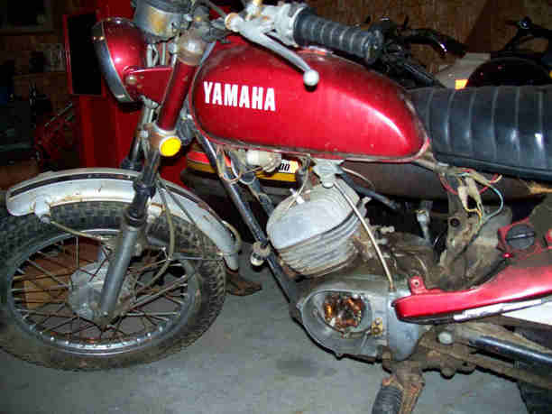

Hi, can any one identify this bike? Pics are attached. The serial number is CT1-079279. What model and year is this bike. Unfortunately, the tag on the steering stem is not legible anymore, so I don't know what to do. I am looking for a carb rebuild kit, new points, and an air filter to get this thing running. Thanks for the help.

The CT1 are 175cc models. I don't really know Yamaha serial numbers or paint vs. year but I would guess about 1972 from the high serial number.

Your motorcycle is a 1972 Yamaha CT2. The Keyster carb kit for your bike is p/n KY-0133. Points and air filters are available too.

looks like my old AG bike. I have found that most parts are similar for the MX and AG's of the era. The MX has the better gear ratio's. If it runs and 1st 2nd and 3rd gear are close and nippy then a big jump to the taller 4th and 5th gear then I would suggest she is AG 175.
