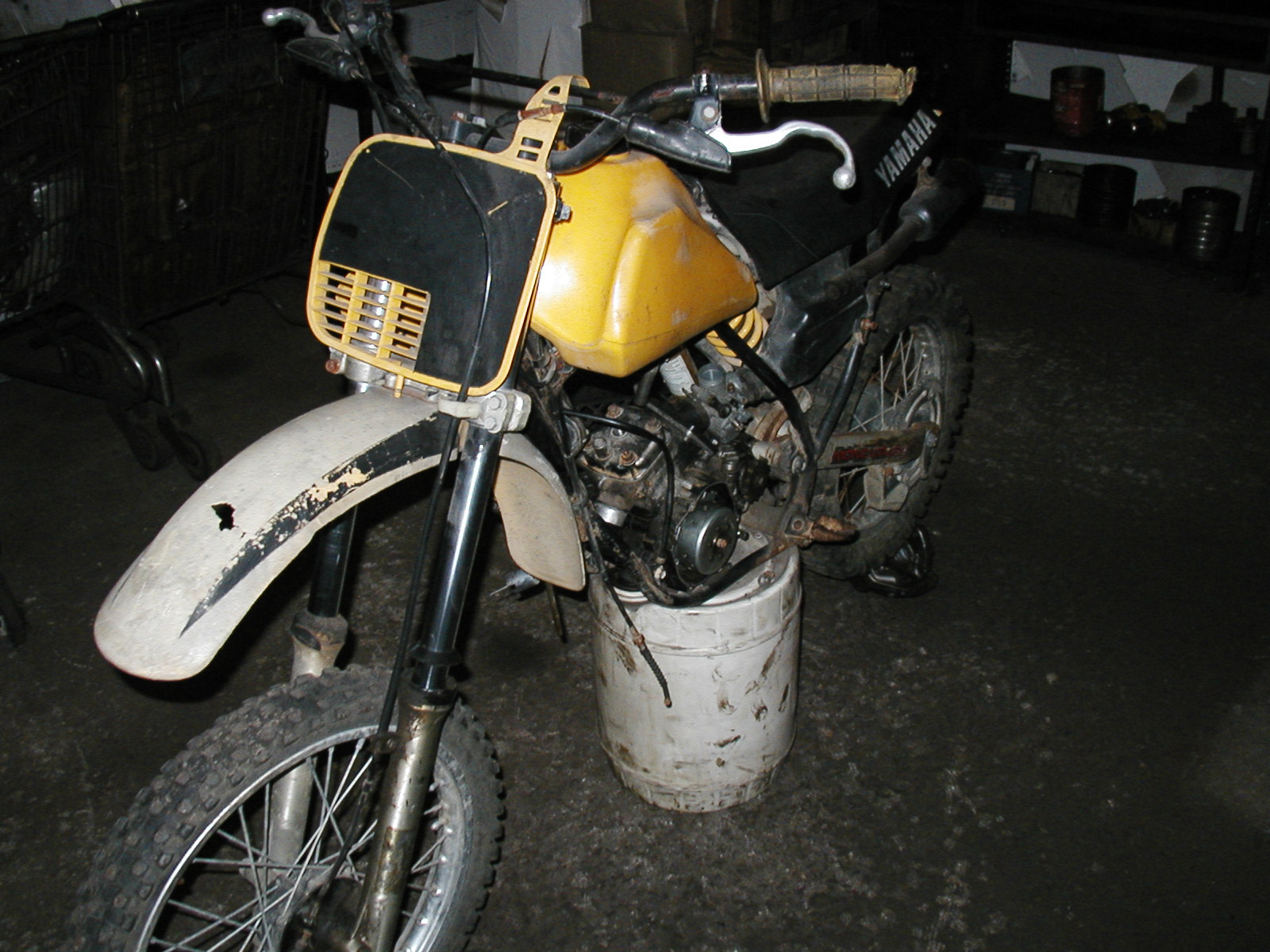

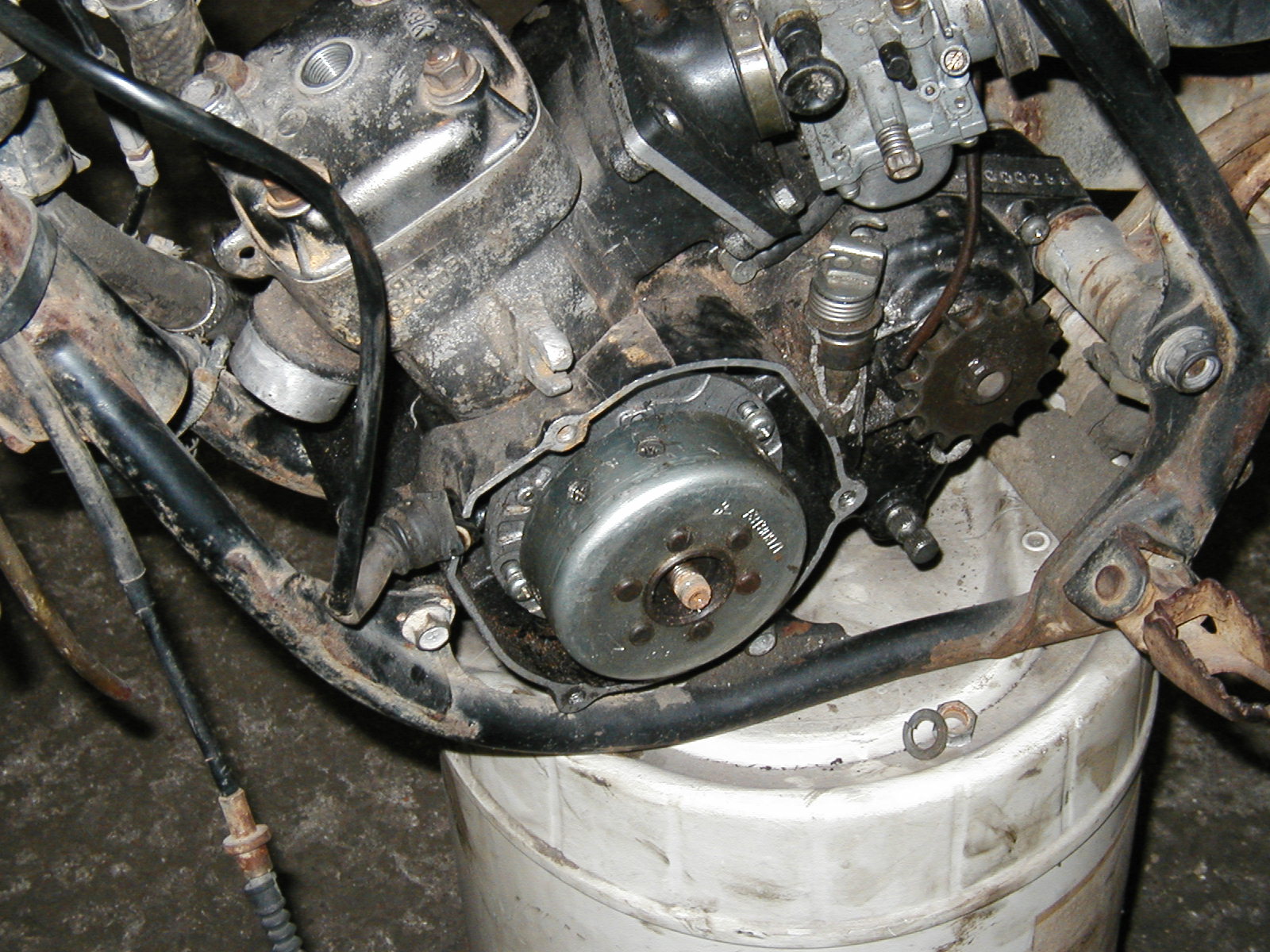

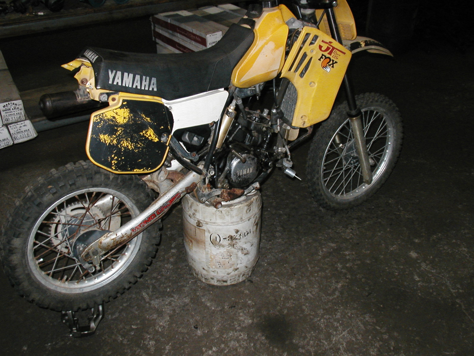

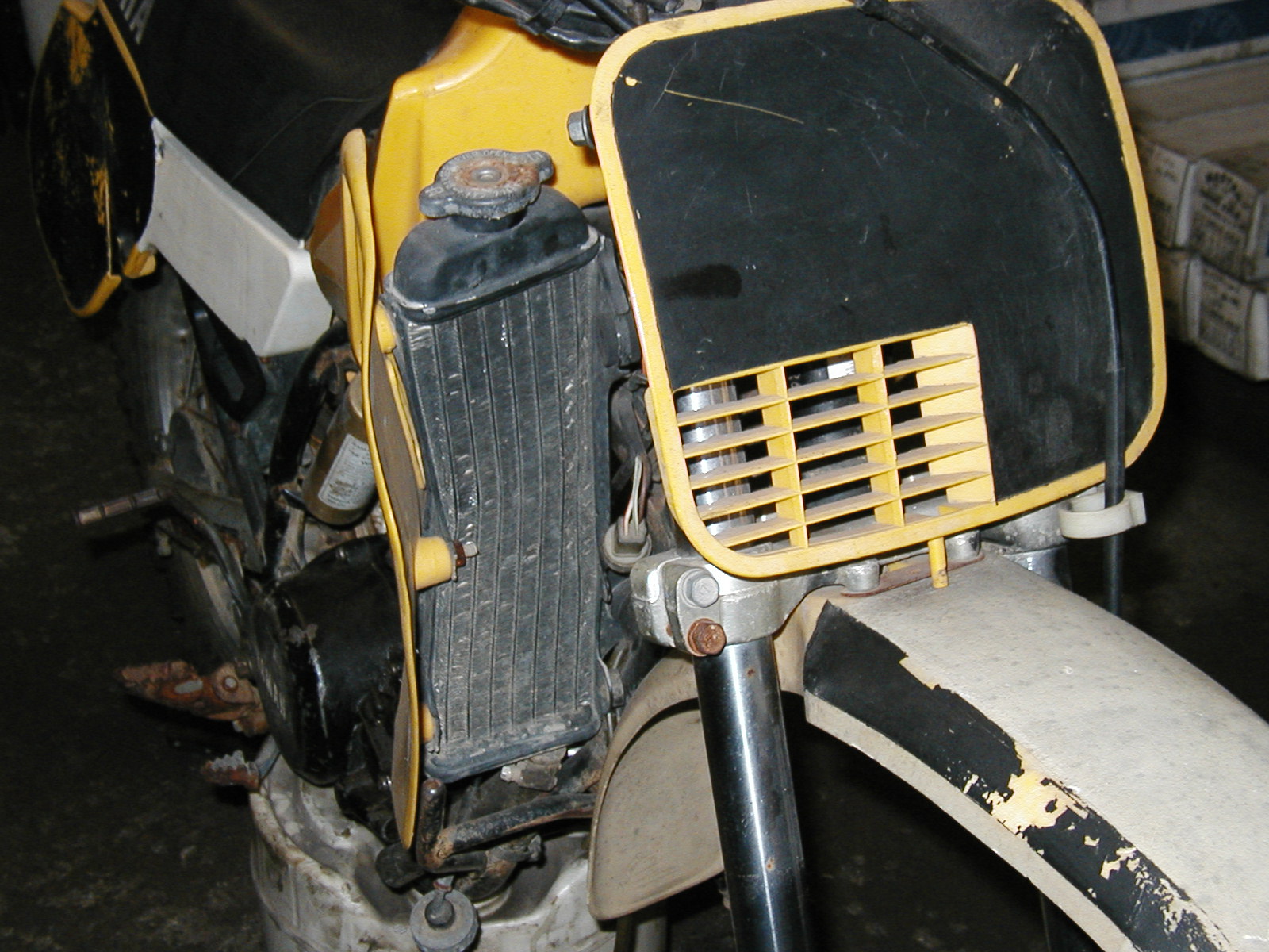

I picked up this 84 YZ80 for $100.00. I'm going to start a restoration on it. It needs alot of work. The motor is shot, both top and bottom ends. Crank bearings are bad but it had a new piston in it. Someone bored the cylinder and did not chamfer the ports so the piston is scored. Cylinder base gasket was on upside down. Forks, radiator and rear rim is bent. I had an 83 YZ80 back in 1983 so this bike brings back memories.

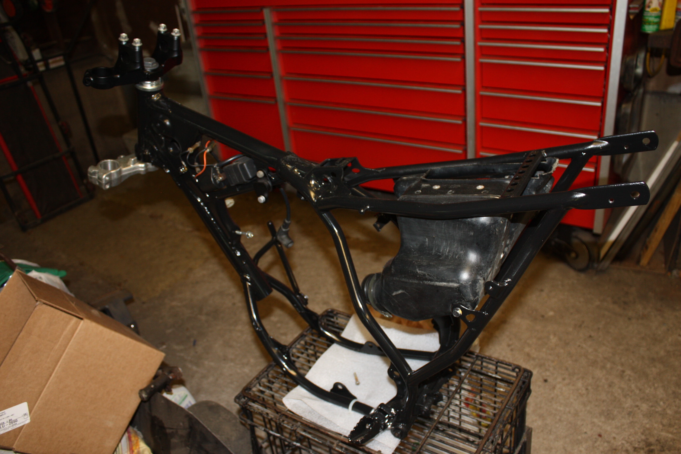

Up date, painted the frame. Next is to put the motor back together, after i get the crank rebuilt.
