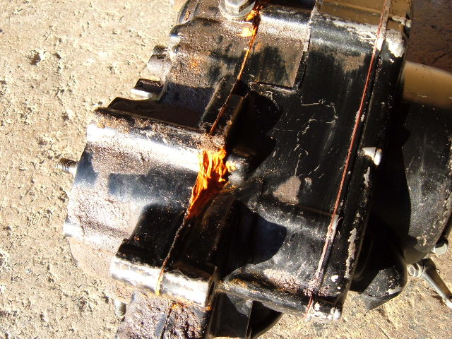

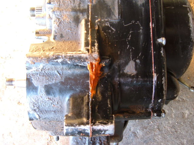

I'm attempting to get a pe 175 up and running that had a broken piston which I also found to have a cracked cylinder. I have found an rs 175 cylinder on ebay, it looks the same, but is it? Also, I only partially split the case and damaged some gasket while I was at it. I found a big gap at the bottom of the crankcase and filled it with silicone. It didn't look like anything was broken, but it didn't look like gasket would cover it because it would have only been supported on one side. Here is a pic,

As for the crankcase fix, I recommend "Marine Tex" to fix it. It is super strong, will withstand hammer blows, won't breakdown from oil, gas, or water, and it's sandable and paintable. I've repaired holes in the bottoms of cranks with it, sanded and painted it, and you can't tell it was ever damaged. Best yet, it holds up after years of use. You can get it at most any marine store like Boaters World or West Marine.
