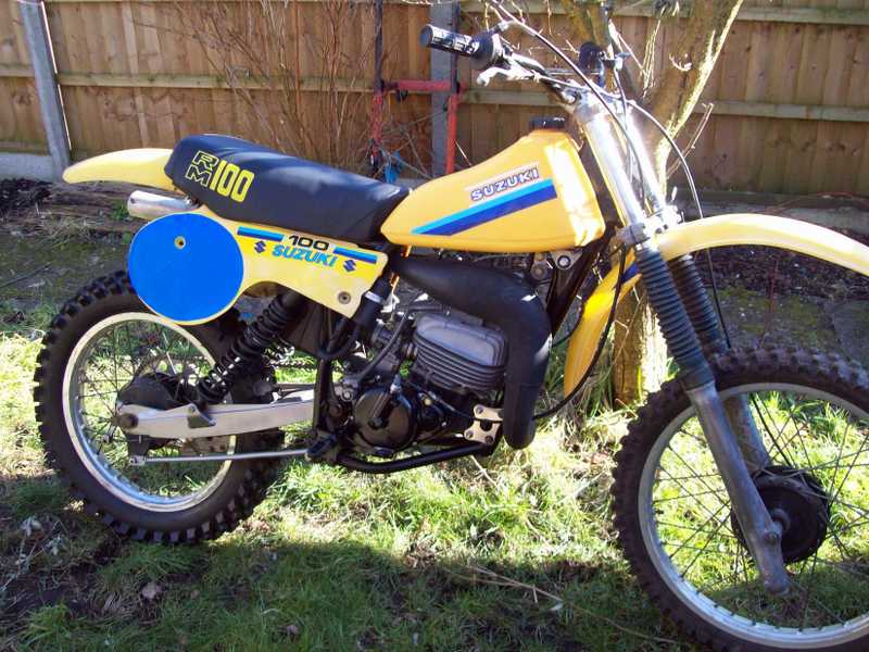

Hi I have an Rm100/125 hybrid. The main physical differences are the 125 has an alloy swingarm,longer shocks,longer/thicker diameter forks and larger front brake. I have all these fitted on my RM100 N/T model.
The engines are not a simple overbore. The 100 has 50mm bore and stroke, the 125 54mm bore & stroke. So to upgrade to 125 you need the crank,barrel piston and head. On the 79/80 models the 125 crank fits in the 100 cases, but not on the 77/78 . This has been covered in more detail on the ozvmx forum.
From 79 to 80 the carb went up from 30 to 32mm. I have a 32mm on my 79 engine and seems fine. For a few more ccs you could maybe put a 125 piston in the 100 jug as there seems plenty of material there to bore.
File comment: Low cost racer £300/$500 !
