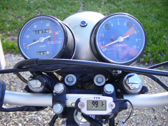

You might want to invest in either a cylinder head temperature gauge or an exhaust gas temp gauge.
I bought one of these cylinder head temp gauges. http://trailtech.net/tto.html
Just remove your spark plug & replace the washer, then mount up the gauge itself with one of their handlebar mount kits. This will provide you with a tool that will provide much useful info especially when changing your jetting, etc.
I run 32:1 with premium fuel & Honda CR type pre-mix.
PS. Check your fuel cap vent to make sure that it isn't plugged. I had one that was plugged & it would cause the bike to just die after 20 minutes or so of run time. After 10-15 minutes it would finally restart. I believe that a vacuum condition was occurring in the tank as fuel was burned.
