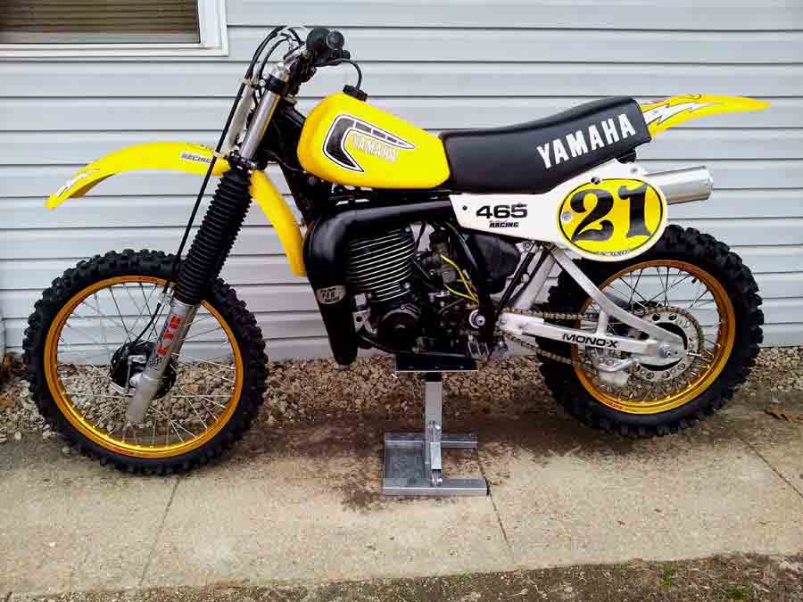

I have finally got My YZ 465 up and running and somethings just not right?
New bore and hone, new piston and rings, new pipe and silencer, new filter, clean carb and jetted as follows:
Pilot Jet - 50
Main Jet - 380
Slide - 3.0
Needle - 6DH3
Needle Jet - Q8
It is hard to start but once its warm it will re-fire with a couple of kicks.
It just feels weak? Maybe more like a 125? It doesn't spit and spur and sounds fine? I tried flipping the choke on while riding and it didn't make much difference? Plus it will back fire once and a while when trying to start it and the plug appears ok?
Timing maybe?
Help :shock:

Air-leak maybe?
Have you done a comp test on it?
Looks great by the way, well done!!!
