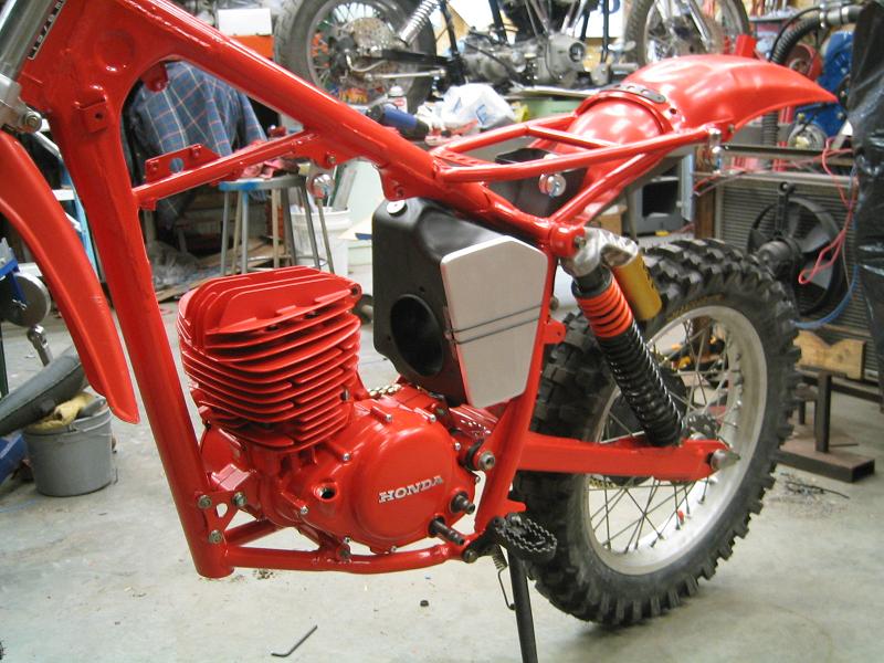

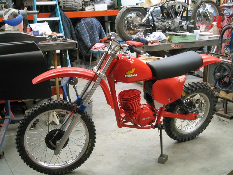

Putting this one together to ride/race....

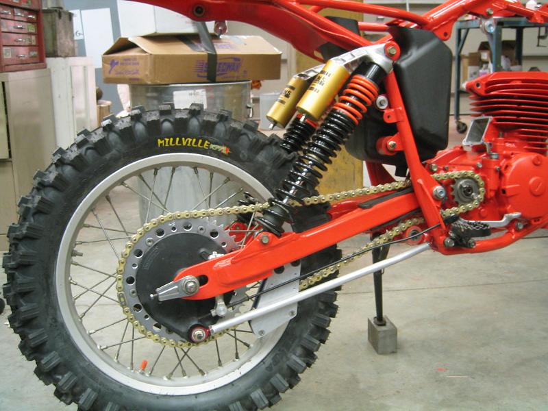

More...

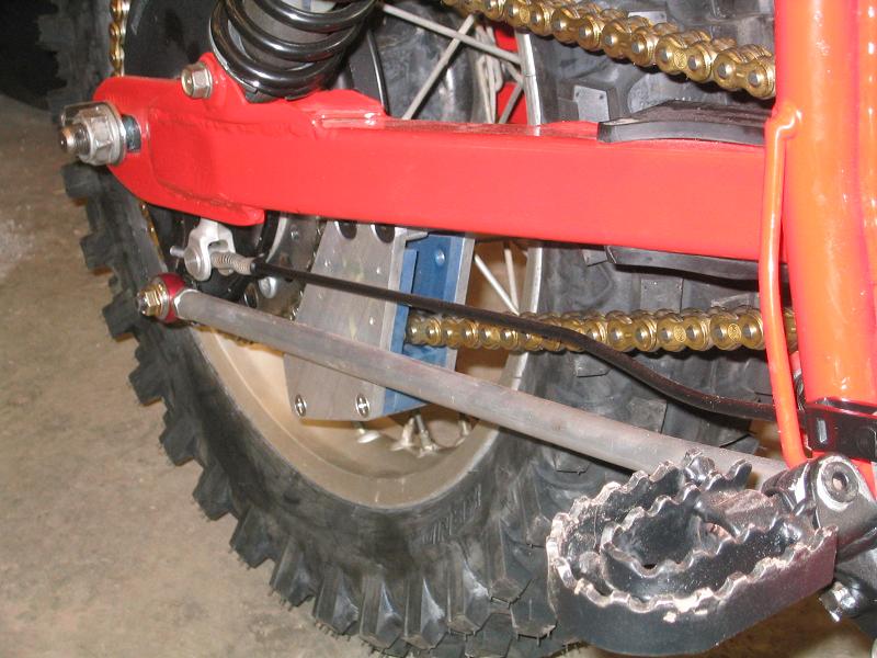

Actually the exhaust mounts and chainguide are done with a bandsaw, drillpress and a lathe..The airbox cover is formed with a wooden buck and a body hammer.... I'm lookin' for a mill...
 Post subject: Re: 78' CR250R pics..
PostPosted: Mon Jan 05, 2009 10:31 pm
I like your chain guide. I bought one similar from John Astleford i.e. the chain goes through a nylon block which protects the guide. I am amazed anyone runs the stock guides on a working bike.
PostPosted: Tue Jan 06, 2009 10:41 am
Very nice work. I especially like the aluminum rear brake arm with the heim joints.
A lighter, stronger improvement over the damage prone stamped steel stocker.
PostPosted: Tue Jan 06, 2009 12:57 pm
Joined: Tue Jul 22, 2008 1:16 pm
Posts: 45
Location: Southern Illinois
Nice !!! What shocks are you using?

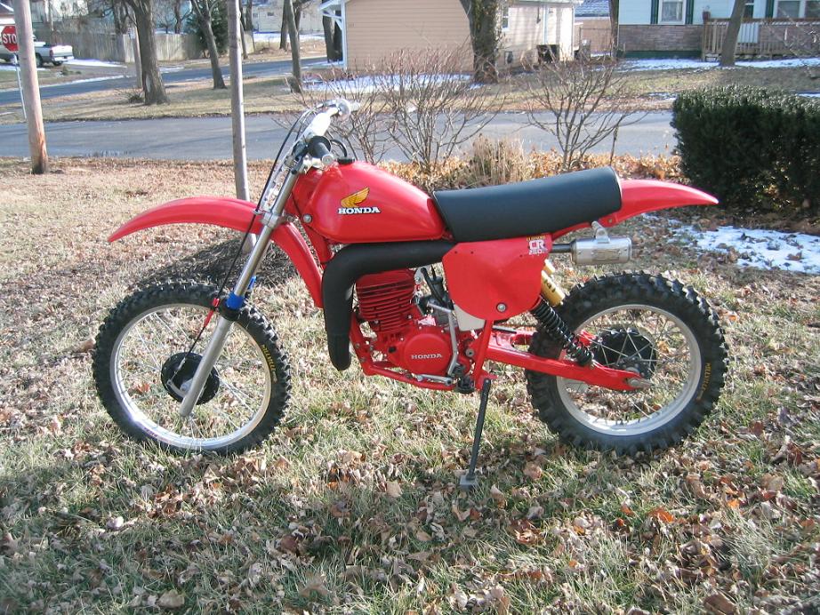

just after the maiden voyage...
