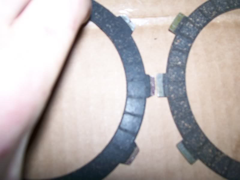

montywa wrote:
Nice basket!! What is the difference between ATC/CR clutch disks and 300ex disks? Thank you for posting up those pics.
Thanks! Here's a comparison pic of the ATC/CR plate vs the 300ex plate, 300ex plate is on the right. The 300ex plates are also a little thicker and all together the stack is about 1/8th of an inch thicker, that is the reason for the custom length clutch rod.
