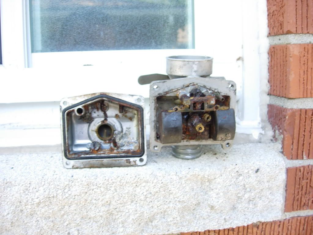

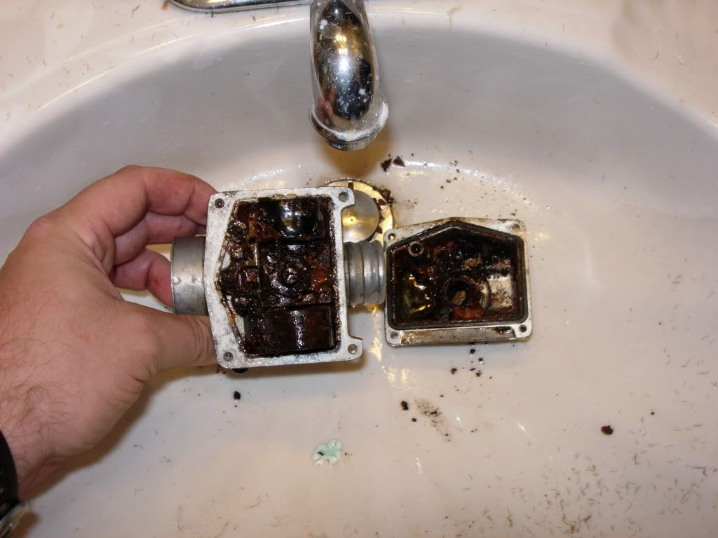

Finally after 4 rounds of heating and freezing I got the carb apart... only to find it was WAAAAAY worse than the other one
after a little cleaning (obviously more is needed)
I'll probably swap a few non jet parts from the other carb and sell off the excess parts
does anyone know where to get the jet seat steel plate thing?

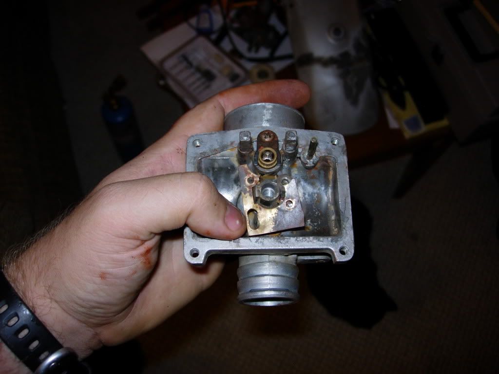

would epoxy (jb weld?) work t hold the brass plate to the aluminum body? the screws rusted off in the body and will be SUPER hard to remove

Before you spend any more money on the bike, I should tell you that replacing the kickstarter spring is a HUGE job, and even then you'd have to replace it with another used one, since NOS springs are almost impossible to find. You can remove the kickstarter idler gear to disable the kickstarter, but you may still have broken spring bits loose inside the gearbox.
If you're going to move ahead with repairs ...
That carb has one of the worst looking float bowls I've ever seen. I think it's unlikely that a carb with a completely rusted-away baffle plate will ever work well.
You probably won't be interested in doing it, but I would strongly suggest contacting the seller and requesting a refund. You paid top dollar for that carb, and in my opinion it's basically junk.
I've done business several times with the guy you bought it from, and he seems to be a reputable eBayer. I think it would be worth a try to return it, especially since you have photos of what it initially looked like. I wouldn't be too concerned about his return policy specified in the listing, this is kind of a special case.

look at my pictures AGAIN
I took the parts from the 250/175 carb and put them into the 125 carb save the jets as I bet they are slightly different.
I have a baffle plate unless this is the steel plate that goes around the main jet, I have that, but it's almost rusted out. My plan is to recondition it with jb weld if that's fuel proof
Honestly I havent seen ANYTHING ELSE I could use for this low of a price and even inf I bought that throttle slide I'd still need a needle, spring, cap, and cable adjuster...
Basically I just want to know HOW to re attach the baffle plate when the screws rotted the heads off

The kickstands on these were a joke mine broke too I put the bike on its stand and turned around just in time to watch it slowly bend then snap right off. I have a spare frame with a good mount and will get you a picture as soon as I can. I also think jb weld is only fuel resistant not fuel proof but I dont know for sure.

 Post subject: JB Weld
PostPosted: Fri Aug 20, 2010 6:20 am
woosh,
I just used JB Weld on an intake manifold and was curious about the gasoline resistance too, and I found this at the J-B Weld Web site (http://jbweld.net/index.php):
"It's strong as steel and impervious to water, gasoline, chemicals, and acids."
The data sheets for both the resin and hardener indicate they're incompatible with "strong acids, alkalis, and oxidizers", but that's it.

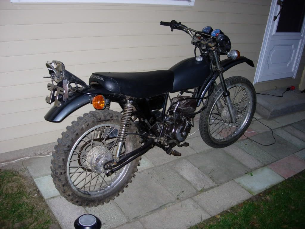

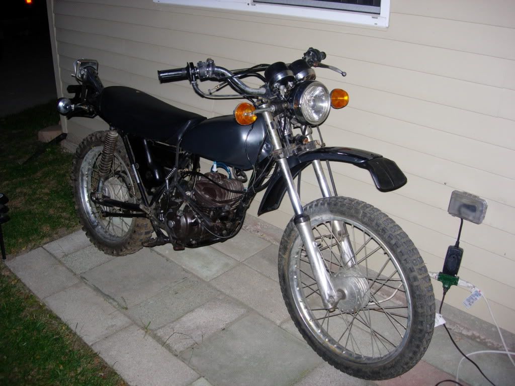

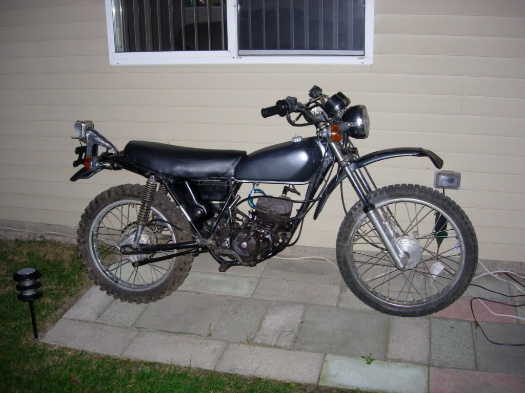

updated pictures
today's big hurtle SPARK
I need a flywheel puller, anyone know the thread? or maybe where to buy one?
