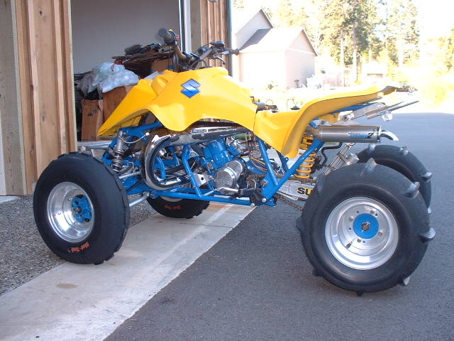

i have had several atc's. there are large sand dunes here and if you don't have a dune machine you ain't sh+t. the air cooled atc 250s were mild on the power band just good smooth power all the way trying to get picture of my dune ripper to come up
